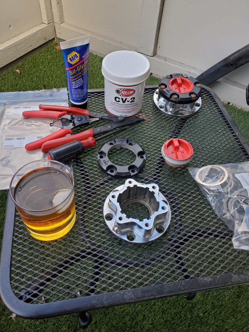

    I used Redline CV2 inside the manual hubs too.

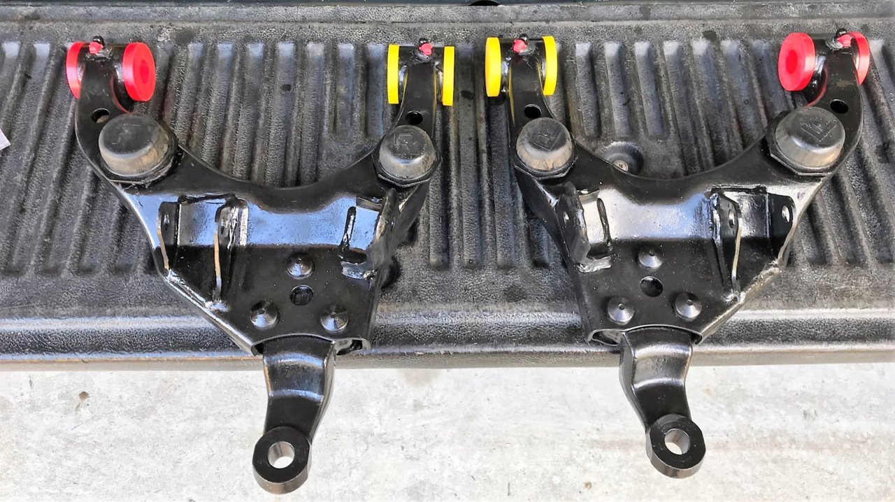

    Making some progress on heavy MTX but the August heat has me slowed down to a crawl. LCAs were drilled & tapped for 90 degree zerks & are ready to install. It appears that Super Lube has an even better grease for poly bushings than the Super Lube 41150 synthetic I was considering. The UMI Performance Super Lube 3008 sold by Summit looks to be specifically designed for poly bushing use. If Energy Suspension Formula 5 poly bushing grease came in a grease gun tube, I would use it without hesitation. But the Super Lube 3008 looks like a very good choice for these Strongflex LCA bushings. Interestingly, Strongflex bushings were originally packaged with black Moly-Graph EP Multi-Purpose lithium-based grease. But the Moly-Graph grease stained the bushings. So Strongflex changed to their current clear/white grease for their bushings.
