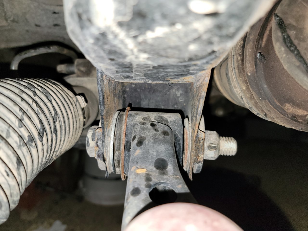

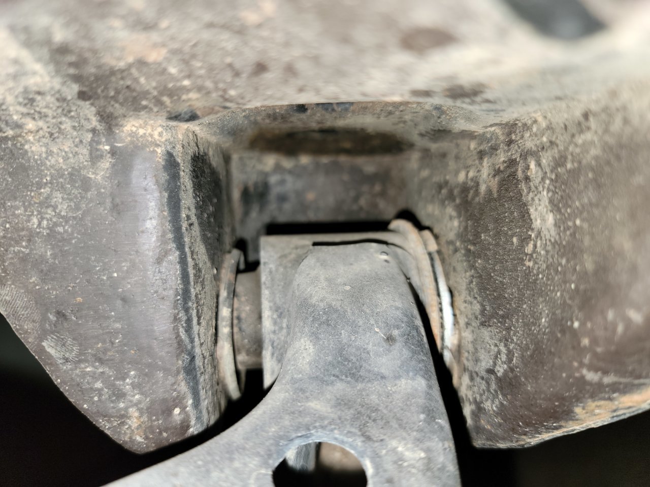

    My LCA bushings are worn completly out in the front on both sides but the back look normal.
    Is the spacing suppose to be larger on the front vs back?
    I have a new set of Whitline I'm going to install but I wanted to make sure there was not a larger problem first.
    I replaced the rusted LCA with Moog that came with the bushings less than 40k miles ago. I'm not sure if this is normal or not.

    It would hard to say what the spacing should be with a non-stock LCA. But bushings should not wear out in 40k. Especially ones which are as much of a pain to change out as the LCA bushings. But that's Moog parts for ya'.

    Looks to me like the top pic is missing the washer on the left hand side between the tab on the frame and the bushing.

    As @0xDEADBEEF said, you're missing a washer in that first pic. 40K miles is low, but could be reasonable depending on the type of driving you do, your climate, and most importantly what your alignment cams look like in order to acheive a good alignment. The Whitelines may not give you much more than that (they'll certainly not last as long as OEM rubber) but they will give you better handling and usually a nicer alignment. They may be squeakier as well, since they are poly instead of rubber. You can mitigate that somewhat by adding a grease zerk (and then using it to grease them over time!)
