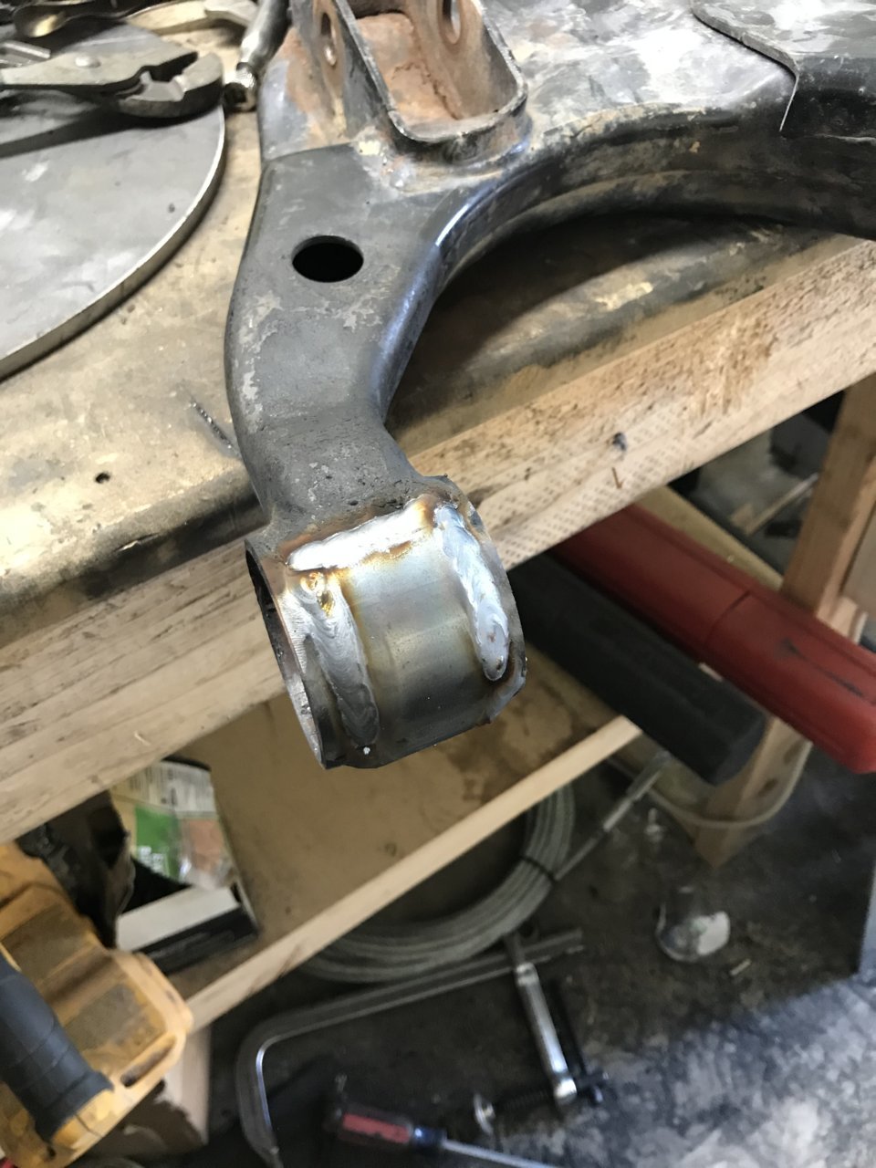

    I don't think the LCA has enough meat on the thickness to really support a zirk. I'd consider welding a thicker piece to the outside, then drilling/tapping that.

    true, the bushing eye is pretty thin. Wouldn’t be a concern for me though since I wrapped my eye in 1/8” as a reinforcement.
