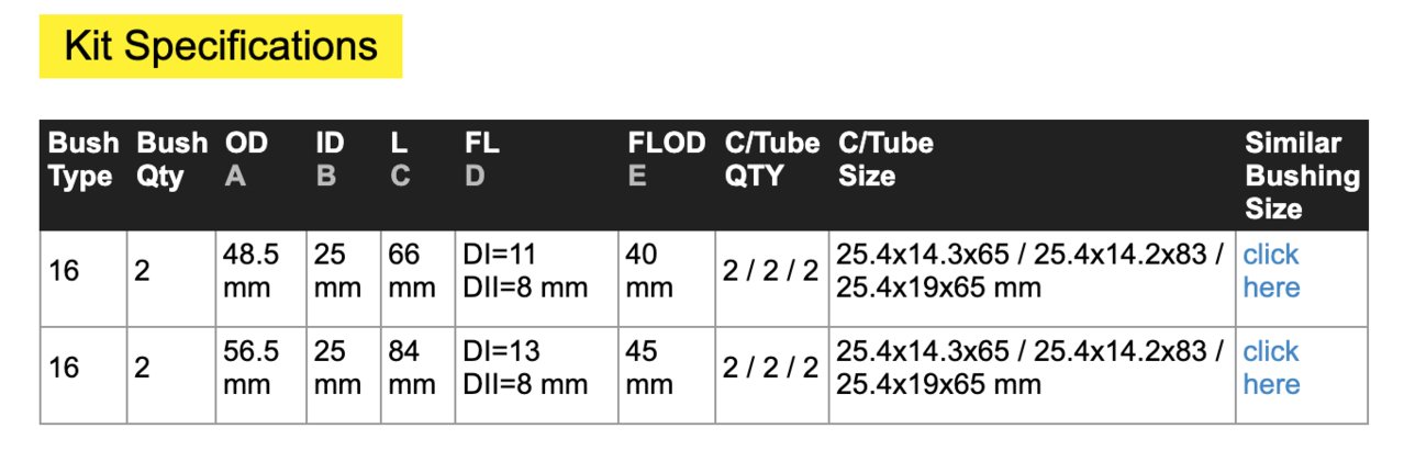

    Actually, I think @YamaDirtrider might have it right with part #53312 since it has different front/rear sizes. But they are a millimeter different than your measurements.

    Pulled the arms out today. Whiteline 2nd gen parts are same width, but 3rd gen diameter is larger by 2mm. No go! Put new genuine Toyota bushings in front position, but waiting for the rears which are on back order! Eek. But yeah.. CONFIRMED: Both bushings are bigger on the 3rd gen. No aftermarket options whatsoever. Genuine Toyota parts hard to come by. Much pain!
