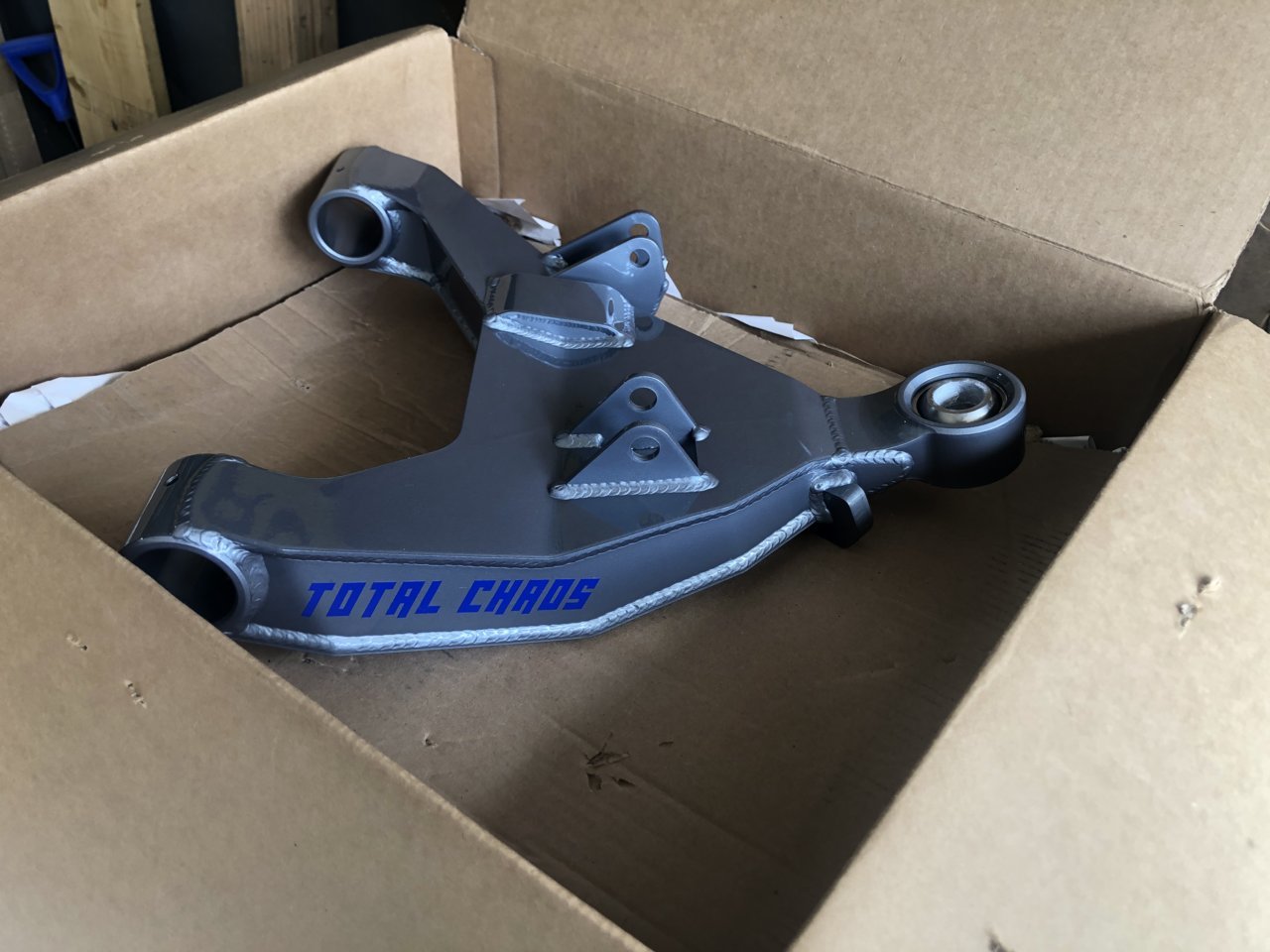

    I think total chais is pictured below.. also what I got
    Same goes for leaf spring bolts
