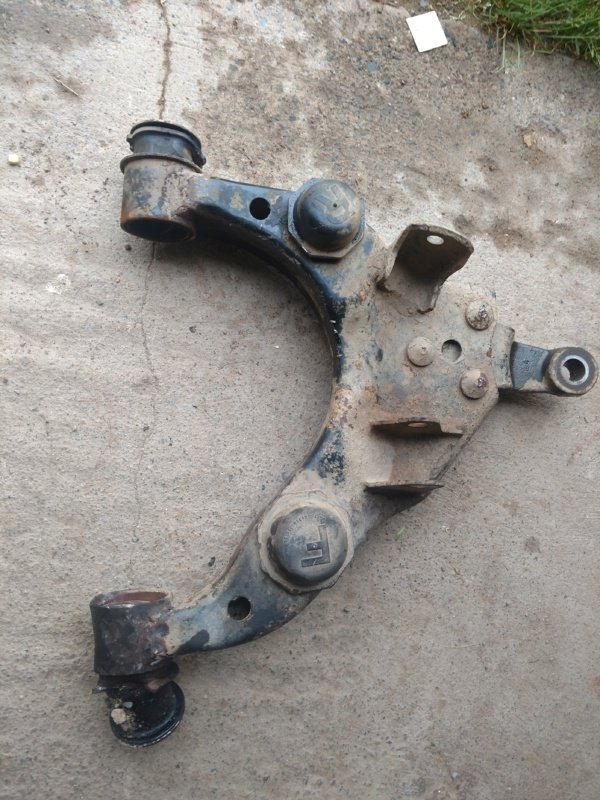

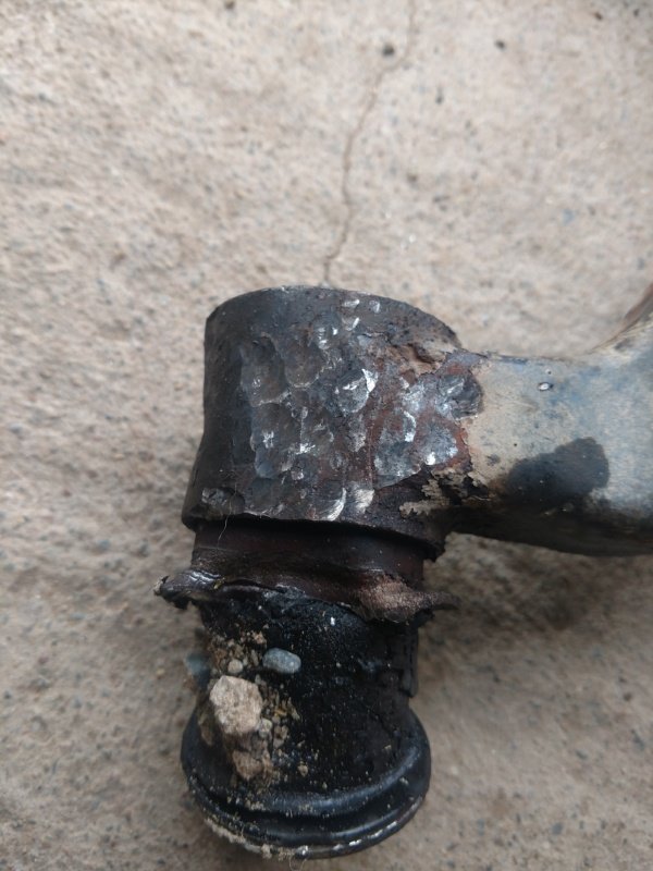

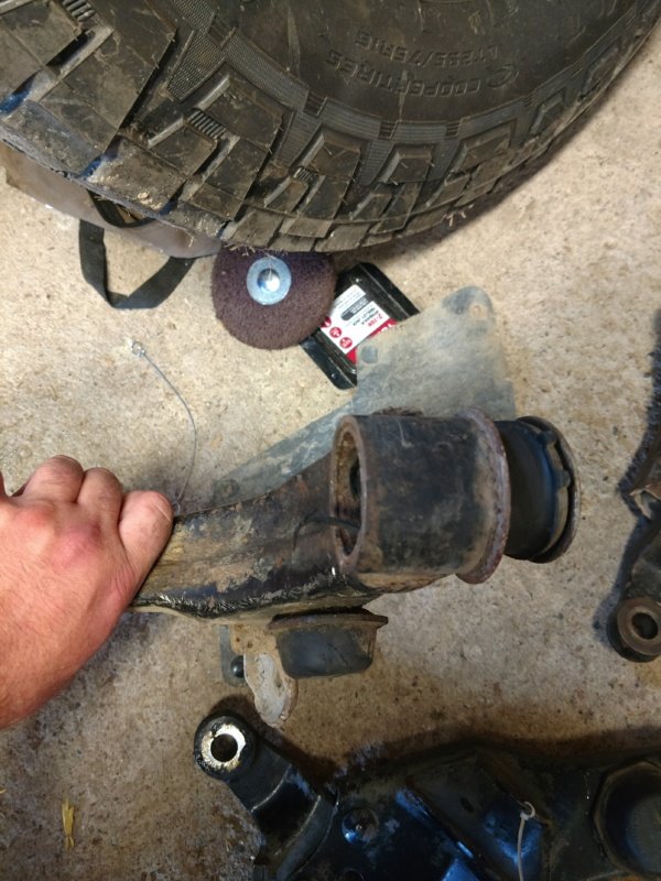

    Uhmm... So... I might have lost my patience and I might have had a little too much fun with my bottle jack and hammer:thumbsup:
    IMG_20190701_175000353_BURST000_COVER_TOP_resized.jpg so after heat, beating and all full 12tons of preasure... I'm left with a bushing that moved 1/4 inch... And a totally bent and thrashed LCA! Oh... how I LOVE rust! Hahaha... I really beat it to death...just look at the carnage!
    ...Rockauto here I come!
    greengaint97 likes this.

    I ended up getting a MAP gas torch and got it red hot (literally) and they popped. The bushings in the pic don't look like they are really melted so I figured you didn't is all. Mine were dripping out and the center and rubber fell out before I pushed the outer race of the bushings out. Mine weren't as rusted though so IDK
    Luckily the LCA isnt too expensive. That is actually impressive as to how much it bent!

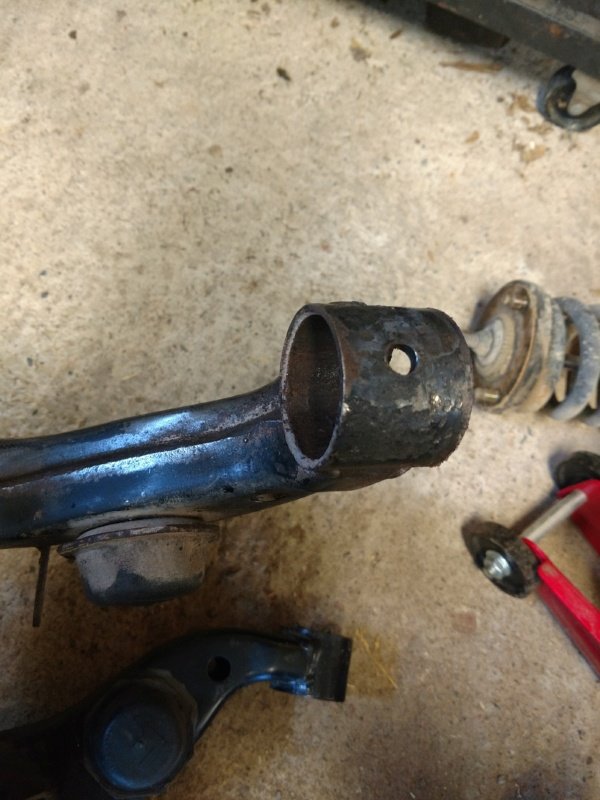

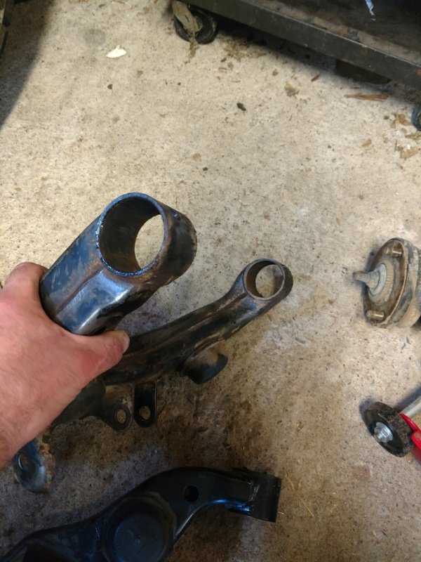

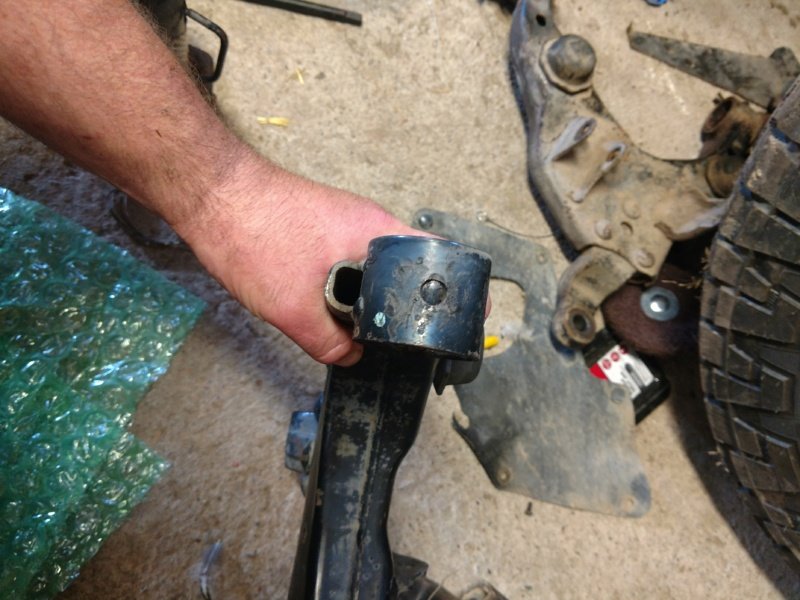

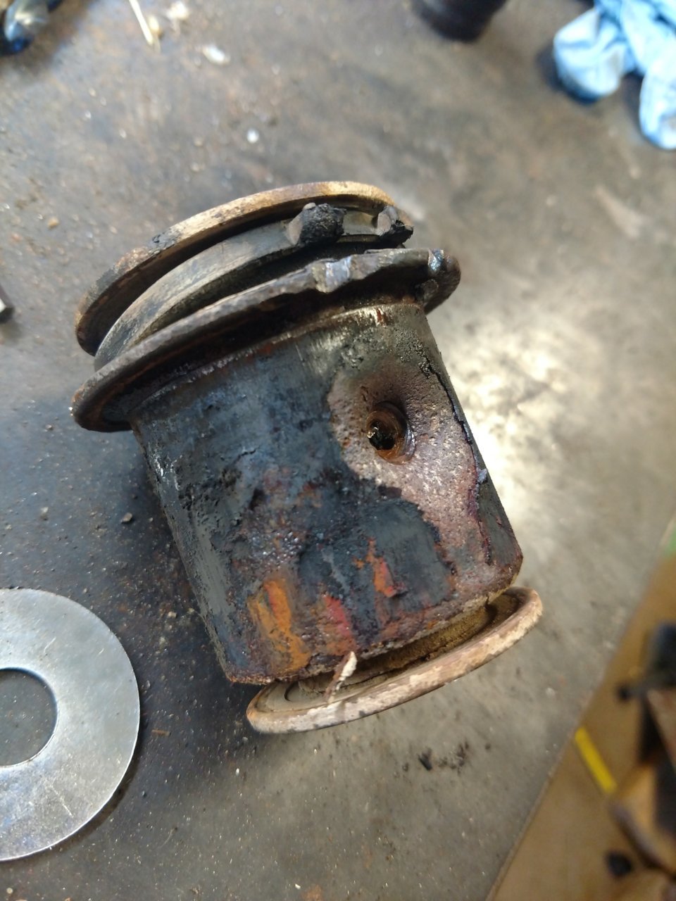

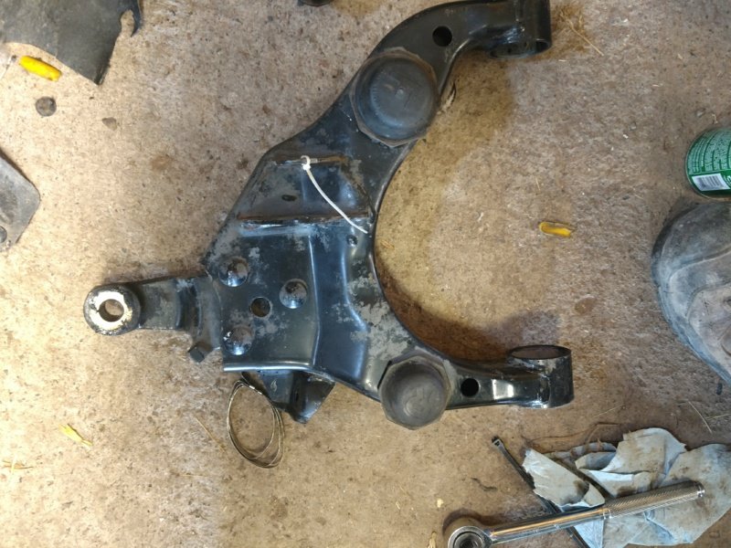

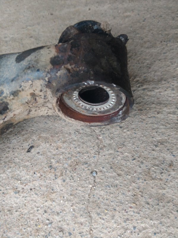

    Alright... It's all about the holes Gents (and ladies). Got my $42 eBay find 02' 4runner LCA in the mail today and these were my results. Obviously Toyota decided to add holes in the LCA bushing mounts for some purpose... And I know it's not for weight savings!
    Here's the 4runner LCA with bushings removed... Took 5 min with the bottle jack method
    The hole allows you to use a punch to concave the old bushing sleave making it MUCH easier to remove!
    So, some quick work with my drill and a few minutes later my original passenger side LCA (which had been spared from mutilation unlike my other one) now also had some "facilitating holes".
    Here it is before drilling...
    It did take a bit longer to press out the bushings from my original LCA... But it went 100% better then my driver's side 2 weeks ago!
    So if yours aren't budging... Make some holes!
