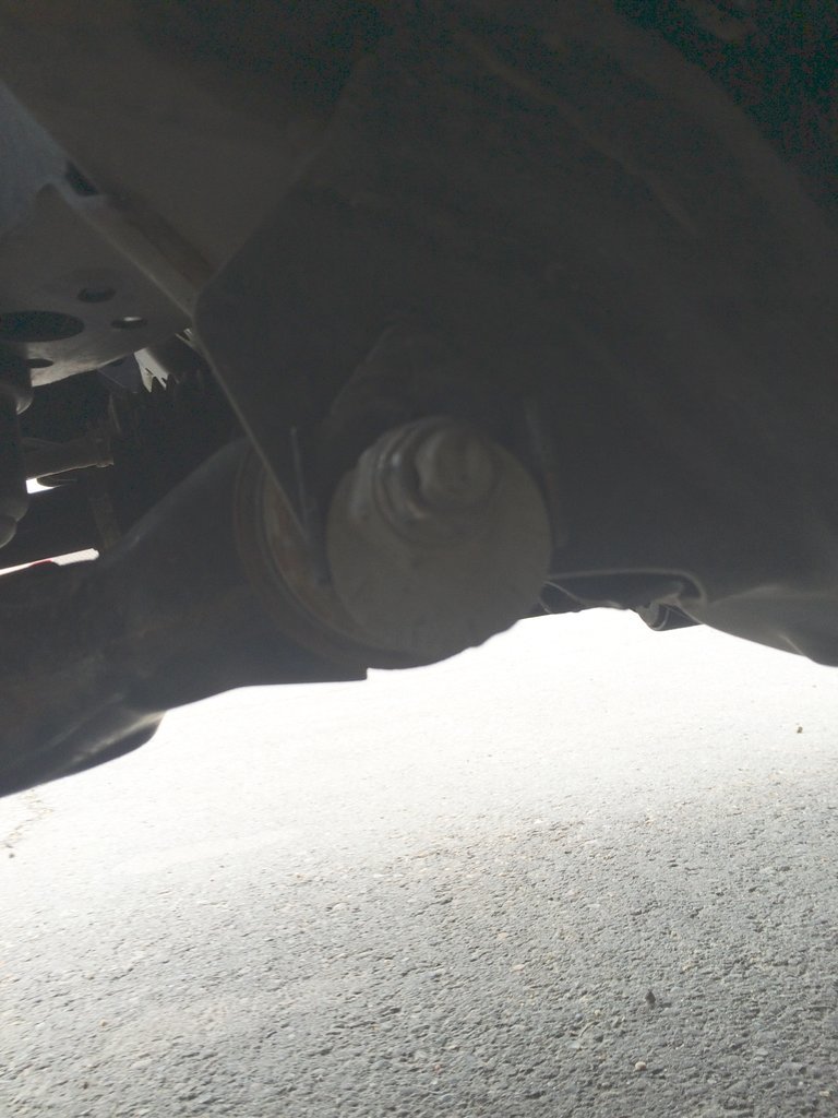

    Does this LCA cam look right? It doesn't look like it's touching the tabs where it is right now. It was like this after the alignment I got last week. I have JBA UCAs and I got 3.1 and 3.2 for caster numbers. This is the driver's side.

    3° caster with what looks like room for adjustment. All is well. You're in good shape.
    Kinda wish I went with the JBA arms

    Thanks....the passenger side is 3.2 but it's pretty much opposite to how this one looks.
