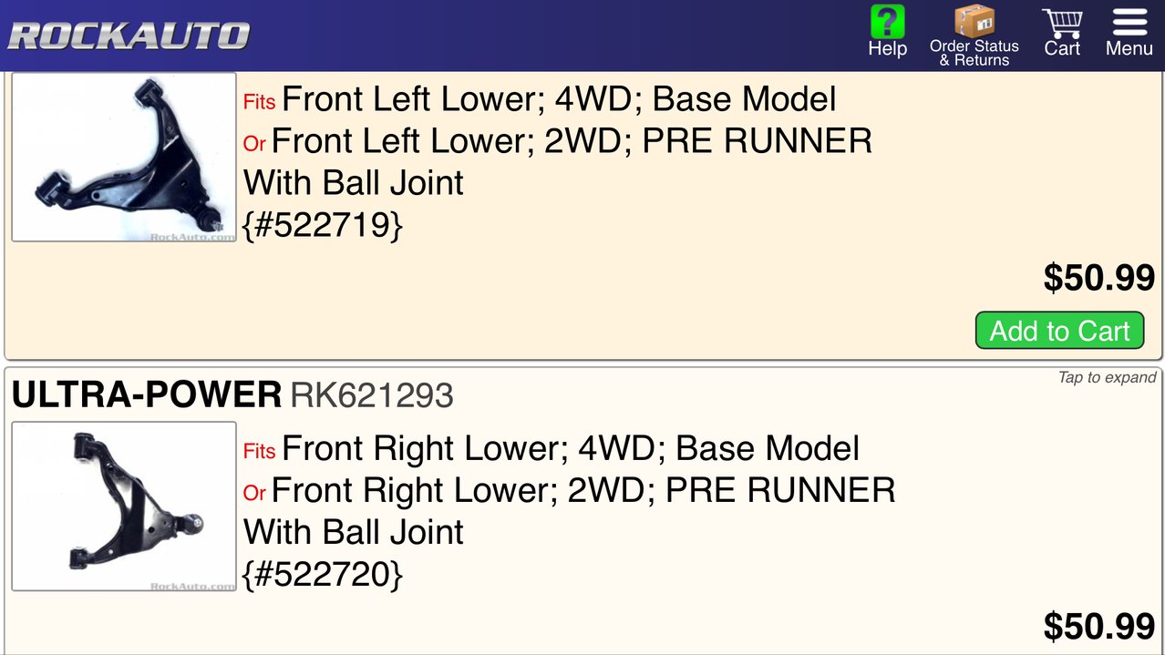

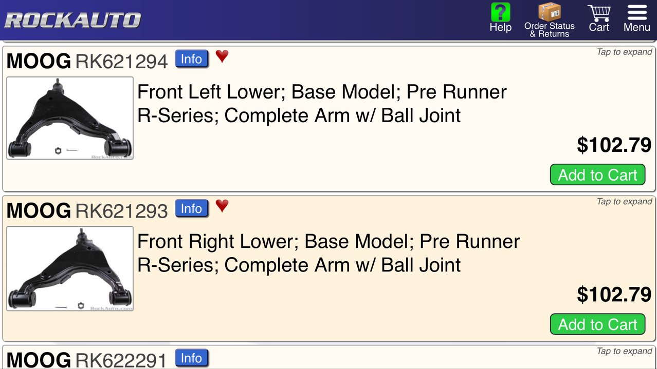

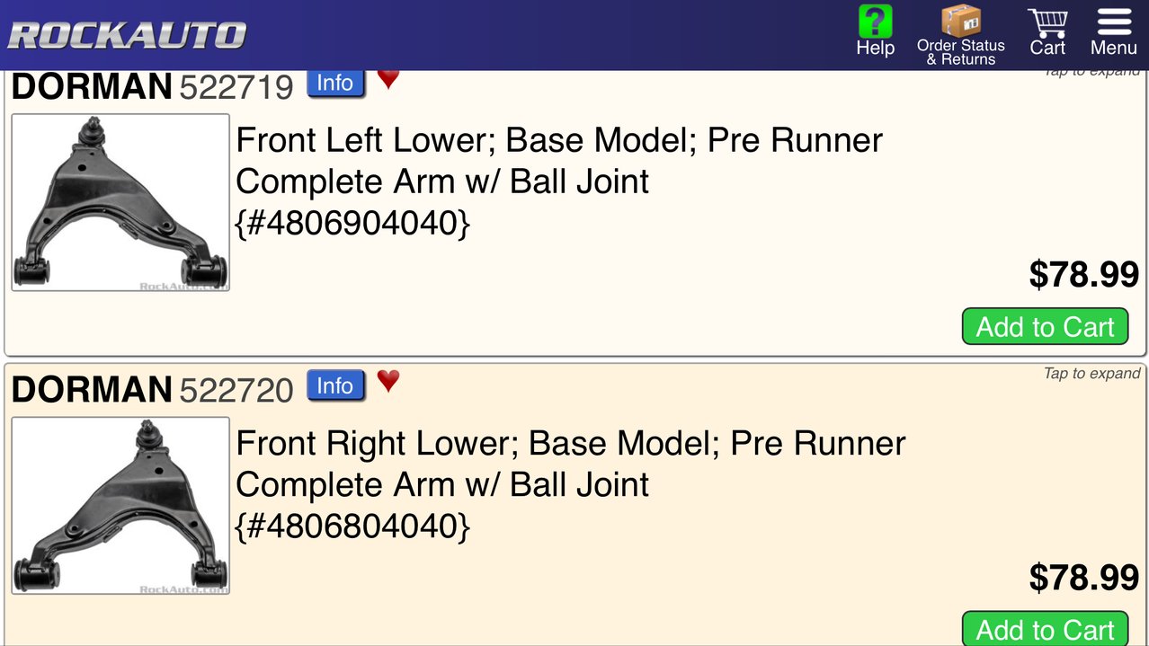

    I need to replace my LCAs
    Give me some feedback on these replacement options.

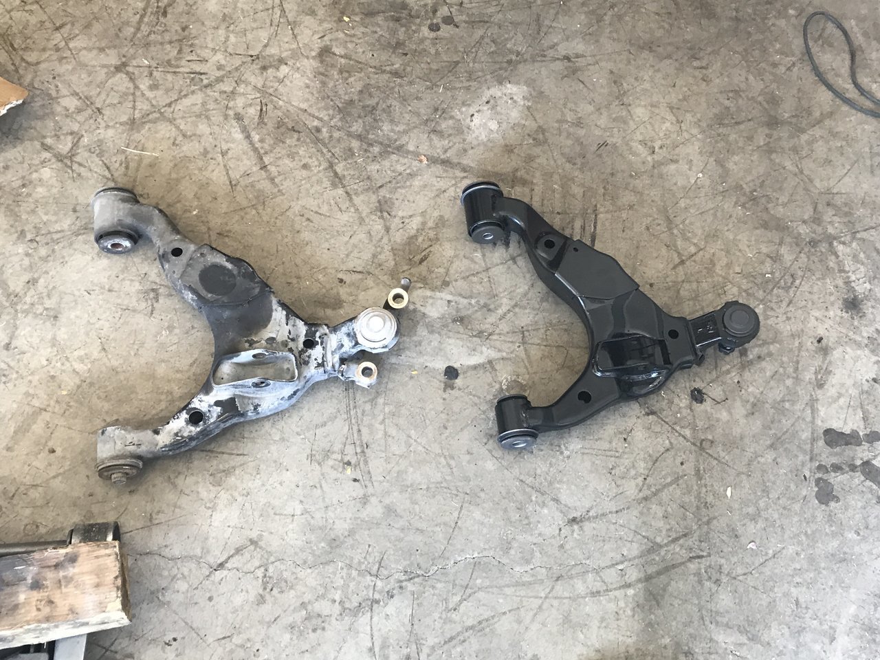

    Had a fellow member replace my lcas with moog both sides an installed icon lift as well. They are oem quality an have no complaints I'll go with them again when I need to replace. Here's a pic side by side.
