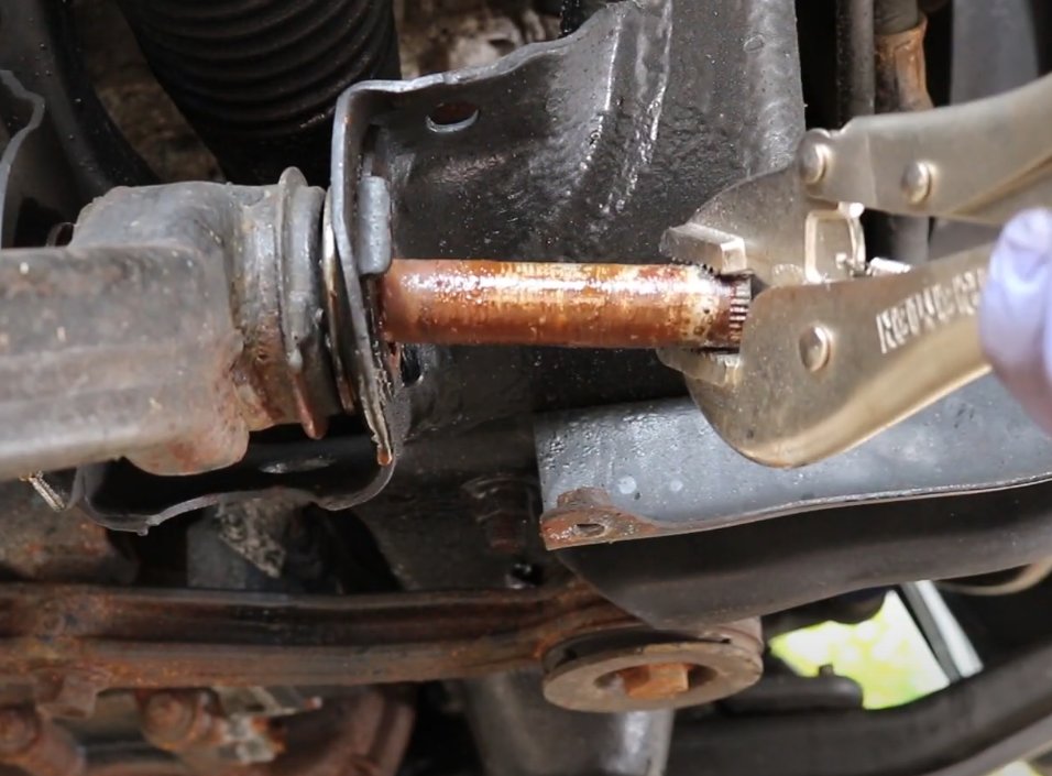

    I have a set of new takeoff LCA's I'm planning on installing. Looking at vids online, I see the mention of an inner sleeve in the front busing that needs to be pushed out to remove the LCA.
    I've look everywhere for a part number for this but can't seem to track one down. I want a couple just to be on the safe side in case the ones in the truck don't come out. I'm not too worried as the truck still looks new underneath, but you never know.
    I found aftermarket sleeves but I don't know if those will work with the stock bushings. Anyone know the part number? or is that inner sleeve part of the stock bushing?
    Skip to 2:50 to see the sleeve I'm referencing.

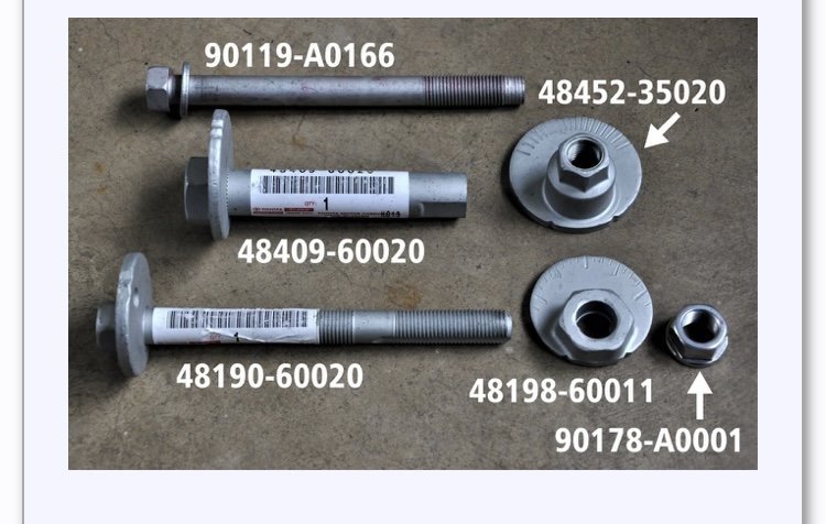

    Here ya go.
    The one in the video is just an inner sleeve.

    that one’s broken. It’s part of 60020
