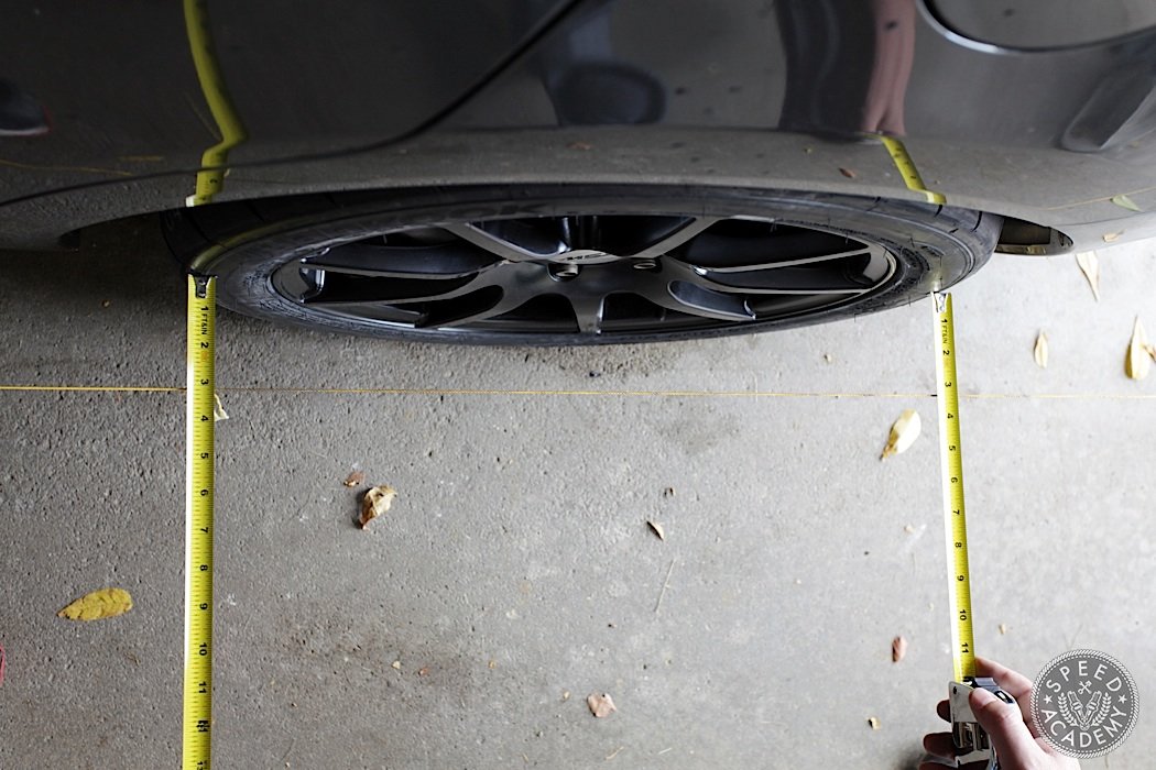

    you can jury rig set the toe to 0 when you’re done so the truck can limp to an alignment shop on its own power without a tow truck, by making a square.
    make a square around the truck with string and jackstands. Measure it evenly to each center hub cap.
    Then measure if the toe is out and adjust it to 0. Steering locked. Tires on top of grease sandwich linoleum or something so they can swivel.
    toe is important. If it’s toed super in or out then you’re scrubbing the tire.
