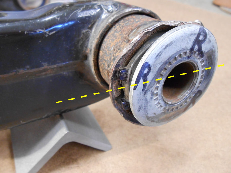

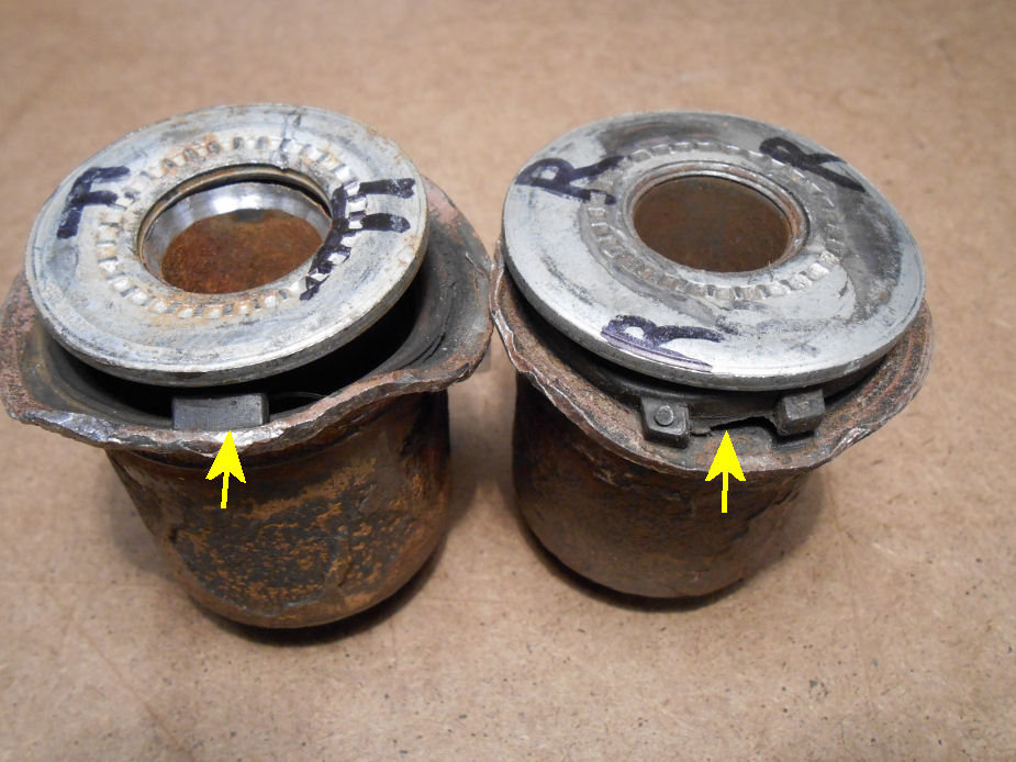

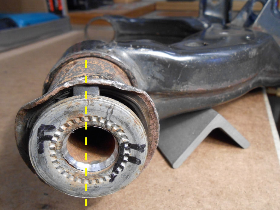

    4WD OE Toyota bushings are different front to rear. They also have an "up/down" orientation with respect to the LCA and the orientation is different between front and back.
    Aftermarket OE type bushings may be the same front/rear. In that case disreguard the following.
    The difference is the hollow voids in the rubber itself. The front bushing (below, left) has larger voids (washer removed).
    They have identifying rubber "nubs". Single nub is front, twin nubs rear.
    The nubs are oriented differently between front and rear.
    Front goes up/down, perpendicular to the control arm length.
    Rear goes side to side, inline with the CA length.
    Don't be afraid to beat around the circumference of the control arm eye if the bushings are being stubborn.

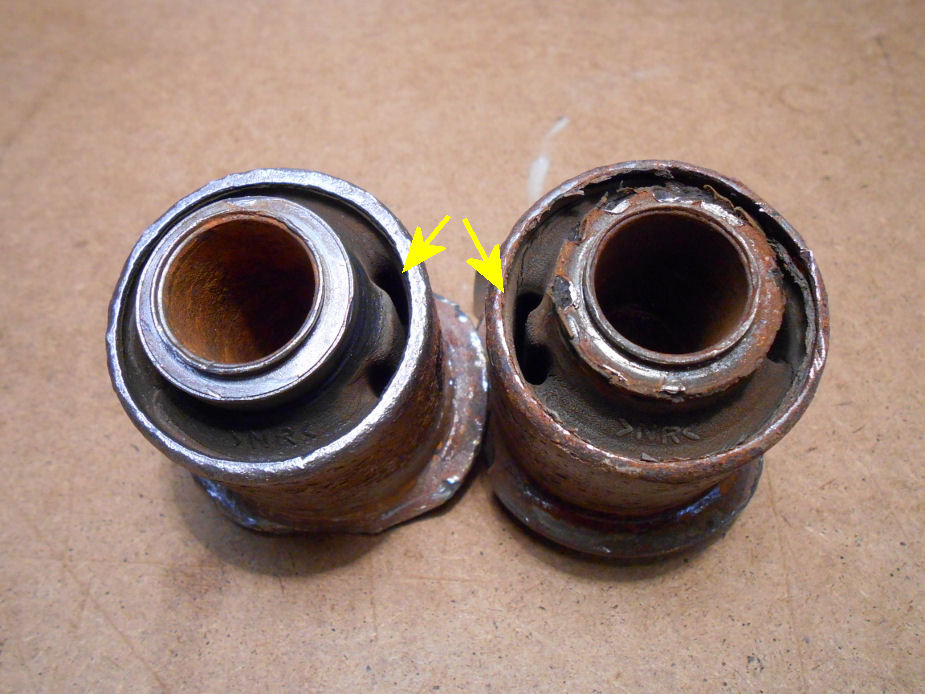

    With an intact bushing the voids are tough to see, hence the identifying nubs.
    For that reason I did not mention the void orientation because it is the opposite of the nub orientation and would tend to confuse the issue, for some folks.
    For the inquiring mind.
    Rear bushing, voids are top/and bottom.
    Front bushing, voids are side to side.

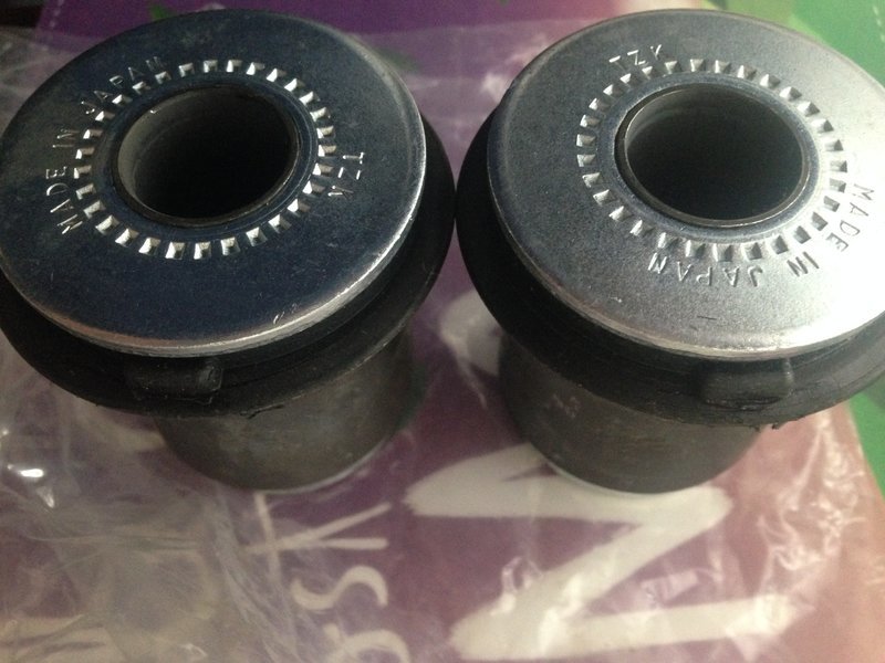

    I ended up going with Moog and they appear to be the same front and rear.

    In the absence of any instruction from Moog, try and peer under the end washers. Look for a void, maybe even feel around with in there with a bent wire. If there is a void I would install both bushings with the voids "top and bottom". This should resist deflection from braking and 4WD use better.

    The voids on the opposite end of the bushing are exactly the same size.

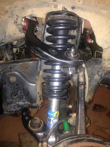

    Just wanted to update everyone and let you know I decided to go with a poly bushing kit and go ahead and do the uppers at the same time. I am also going to do the rack bushings while I have everything pulled out. I am hoping the poly are not too big of a PITA..... glad I have an oxy/acetylene torch at my disposal....:)

    Just a follow up with what I had originally posted. I had my poly bushings overnighted from 4 wheel parts and when the box shows up only half of what I ordered was there so I did get all parts off and cleaned up and finished the steering rack. The camber adjusters and bolts all slid out like butter "I was very surprised". Most videos I had seen people using propane torches to melt out the old bushings, well I opted for oxy/acetylene w/ a rose bud and it took around 2 minutes per bushing. Didn't even need a press, they popped out with pressure from a pry bar and cleaned the with a wire brush.
    Now if my parts would show up........
