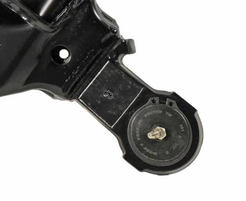

    Moog has two version of LCAs. The lower-priced version looks to be the same as the economy ones sold by Dorman, with a no-name ball joint. The slightly higher-priced version appears to use the same greaseable ball joint that Moog sells independently and used in high-end fabricated LCAs by Dirt King, BTF, etc. I would run the higher-priced Moog CK623262/CK623263 with no qualms:
    https://www.rockauto.com/en/moreinfo.php?pk=12883173&cc=1445515&pt=10401
    https://www.rockauto.com/en/moreinfo.php?pk=12883177&cc=1445515&pt=10401

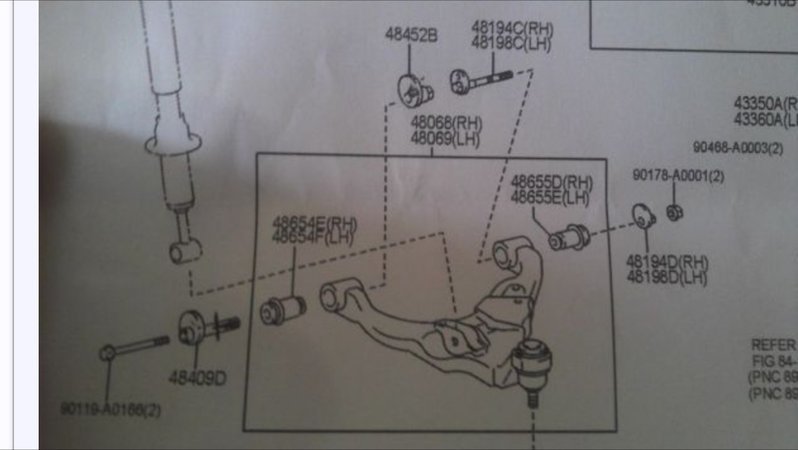

    I don’t believe you happen to have all the parts number for the camber kit, so far I know
    90119-A0166 x2
    48452-35020 x2
    48409-60020 x2
    48190-60020 x2
    48198-60011 x2
    90178-A0001 x2

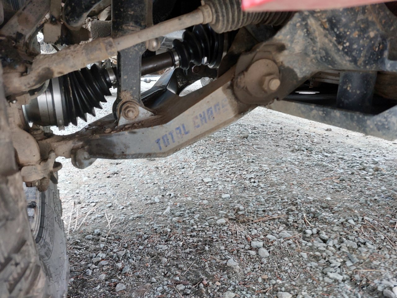

    Skip oem and moog and movetech and go straight to total choas lower arms.

    ^Be prepared to replace the lower uniball bearings every 20,000 miles or so. One of the reasons I went with BTF lower arms:

    Quick question. I'm assuming they updated the parts on them because the parts are different from

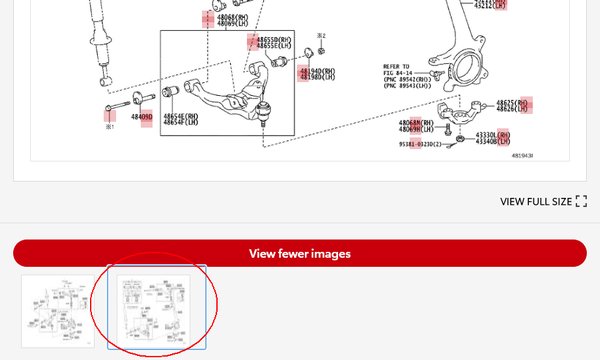

    48409D doesnt seem to be on that link you sent me
  14. Jan 29, 2023 at 1:09 PM
    3JOH22A
    3JOH22A トヨタ純正男娼
    Mar 27, 2019
    #288172
    13,237
    District 6ix
    3G Tacoma on 35"s, 5G 4Runner
    ^First pic in the page is for 2WD 5-lugger models. Click on the second pic:

    Thank you! I'm a idiot lol

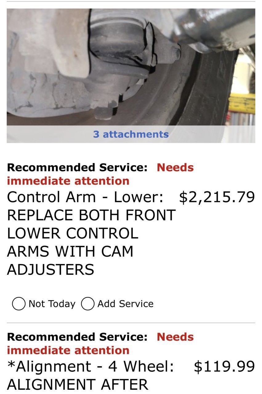

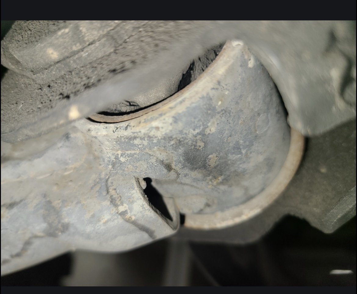

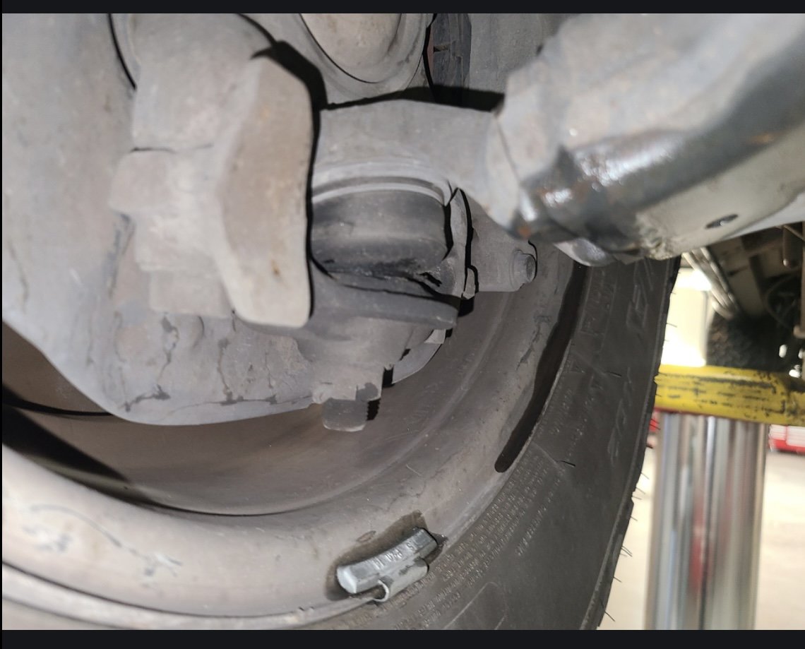

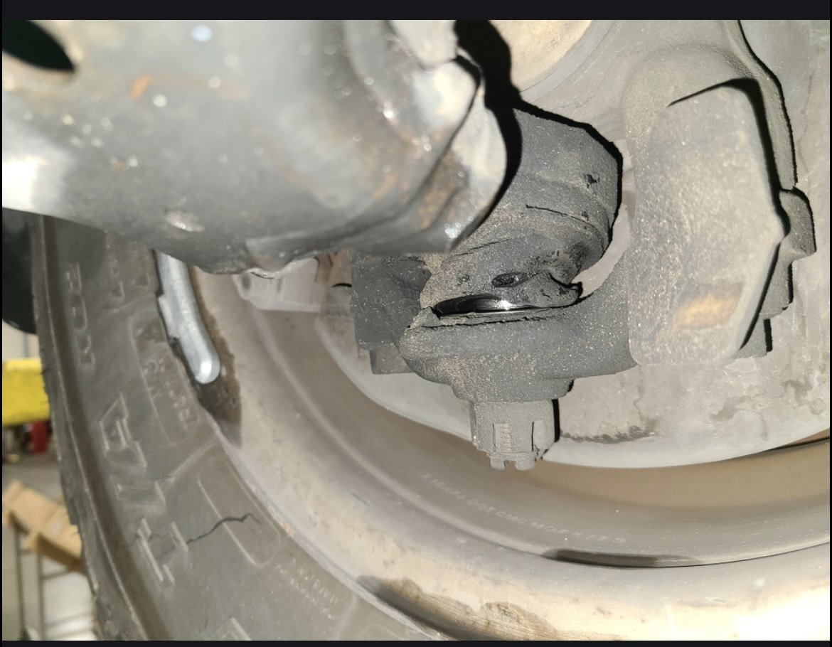

    ^What particular problem are you having with your current LCAs to prompt changing them? Are the bushings shot or the ball joint worn?
  17. Jan 29, 2023 at 1:23 PM
    #17
    gothtaco
    gothtaco [OP] Active Member
    Jan 9, 2023
    #415118
    28
    05 Tacoma PreRunner sr5
  18. Jan 29, 2023 at 1:23 PM
    #18
    gothtaco
    Jan 9, 2023
    #415118
    28
    Toyota's price on doing it for me, f that
