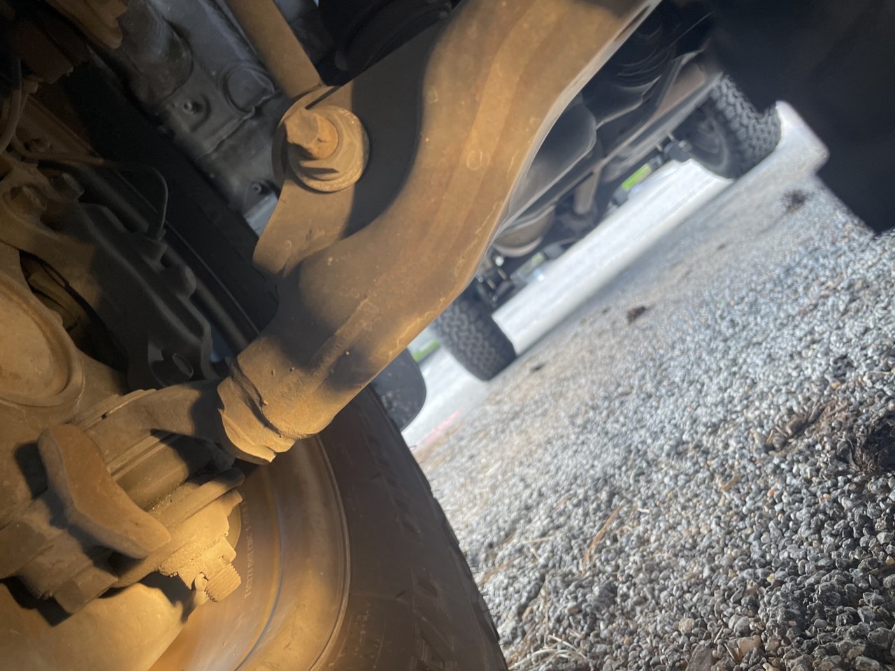

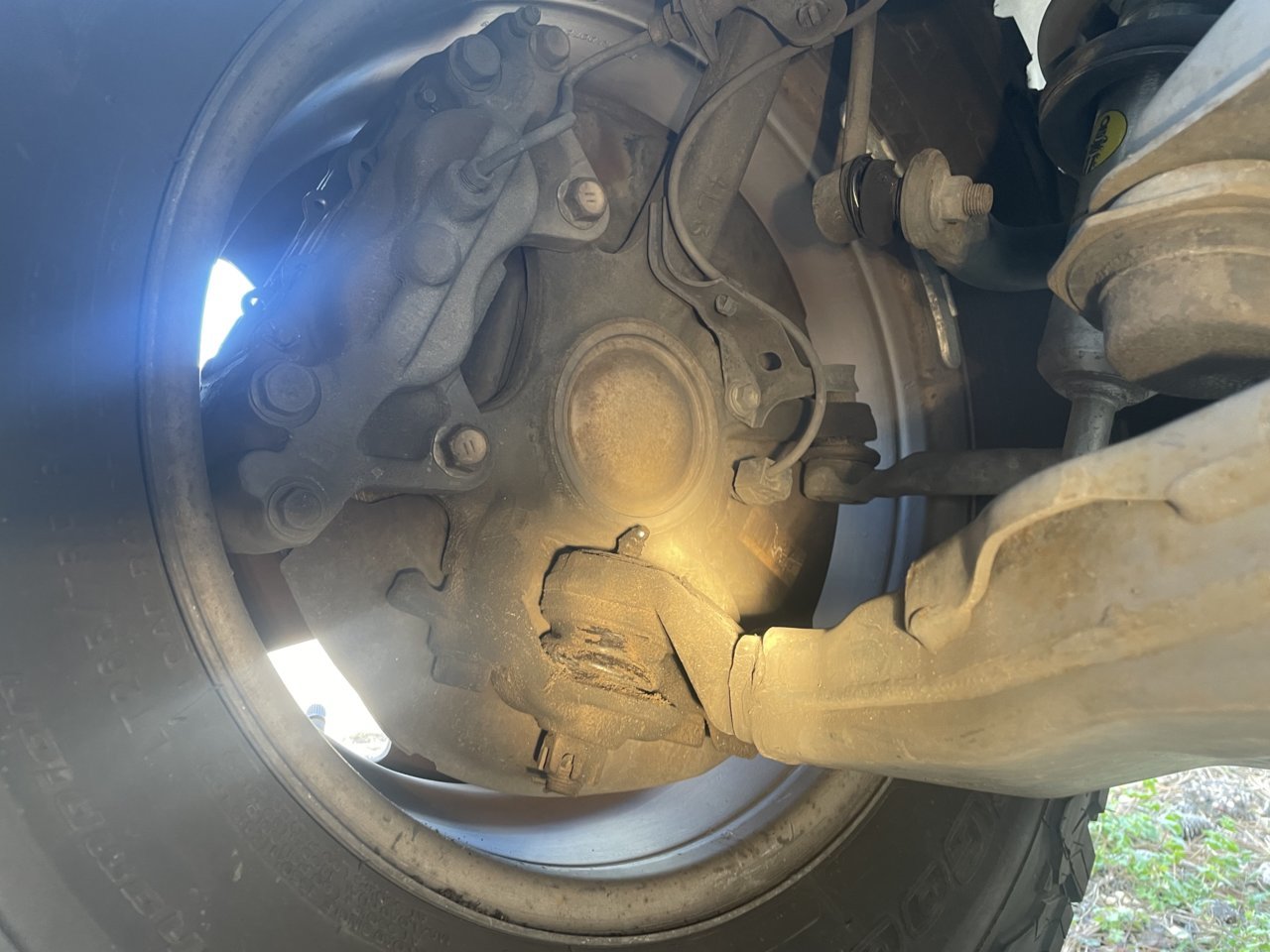

    ^Looks like you have leaking ball joint boots. Picture isn't clear on the condition of the bushings. If the bushings are serviceable, you can get away with replacing the ball joints in-situ. That'll let you avoid disturbing the cam bolts.
    Either way, make sure you have a good puller tool to separate the ball joint stud from the steering stop bracket. I had a pitman arm puller that didn't fit. Got it done with a wiper arm puller that probably shortened the life of the tool.

    Bushings look pretty f'd from the picture. The thing is I don't have much time to sit and do this at home. Really just wanted to get something and get it one quick you know.

    If you jack up the front end do you have any play at all? Just cause the boot it torn doesn't necessarily mean the balljoint itself is bad. But also its pushing 20 years and (Im assuming) a lot of miles..

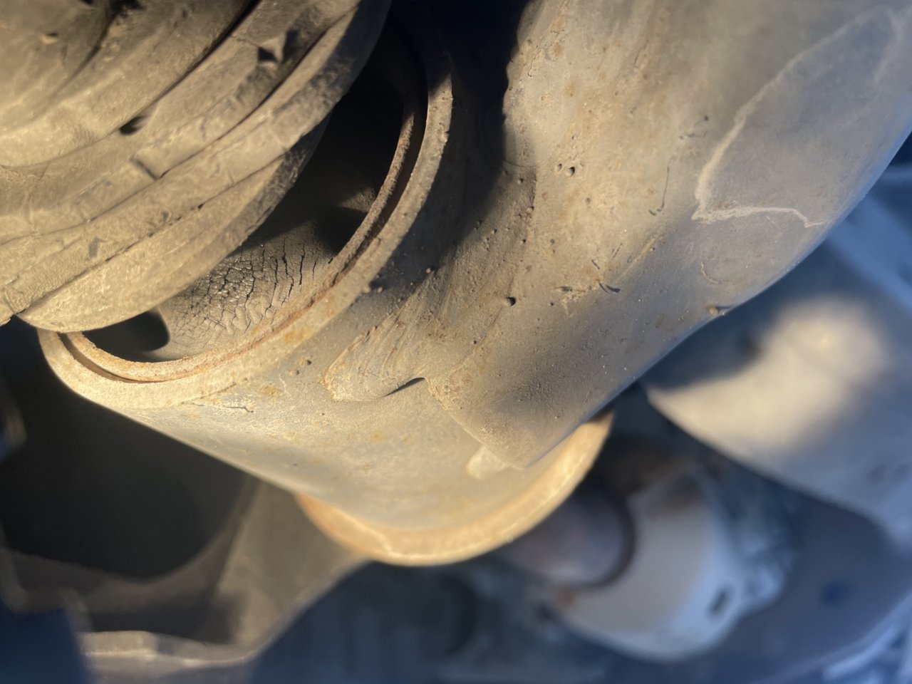

    Left side/ driver side. This seems to be aftermarket hence the zerk fitting

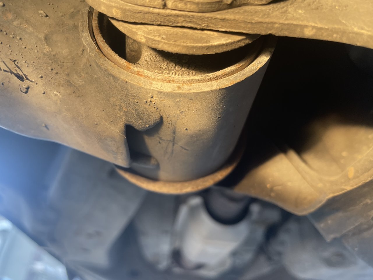

    Passenger side. They bushings look

    Talked to the previous and he said he did and overhaul at 100k. My truck has 178k

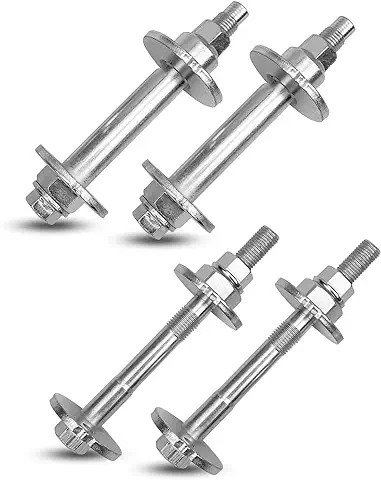

    Anyone tried these at $50 per side. Look better designed that the rock auto kits where the flat on the cam tab can round out. Look like a duplicate of OEM design. Cam tabs look like they are brazed to the bolts. Not a separate slip on part

    I have no experience with the above bolts, but I would stick with OEM and from what I hear 48409-60020 is the part that usually seizes in the bushing, where the rest of the parts can be re-used.

    This is a pic of the aftermarket (and there are many of similar design) versions of the LCA adjustment bolts. They are generally around the same price as the not well liked versions sold by Rock Auto. I would be willing to give them a chance since they are 1/4 the cost of Toyota parts. And they at least look the same as original vs rock auto versions.
