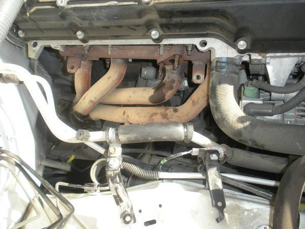

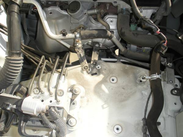

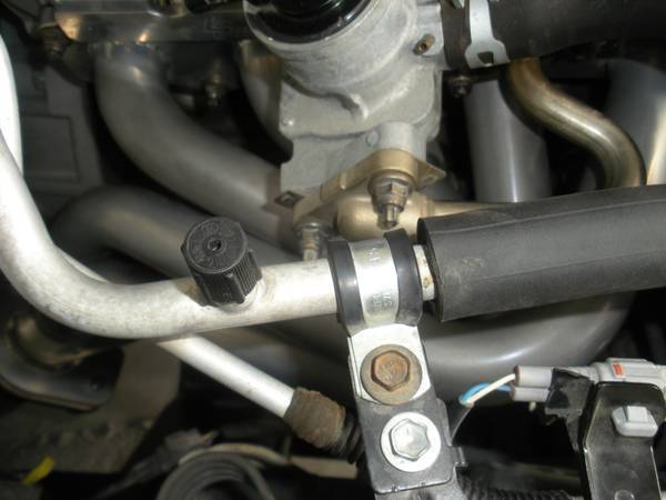

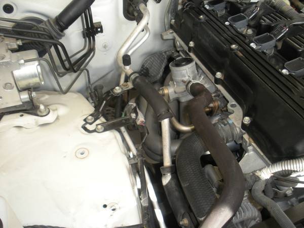

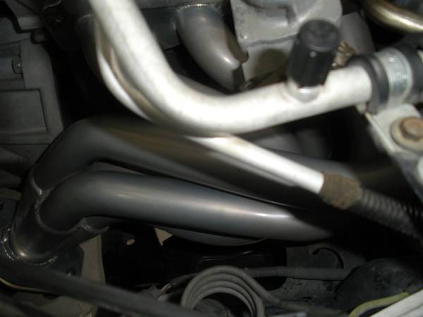

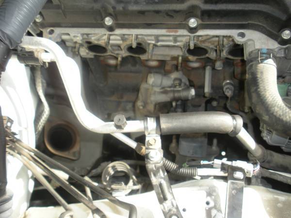

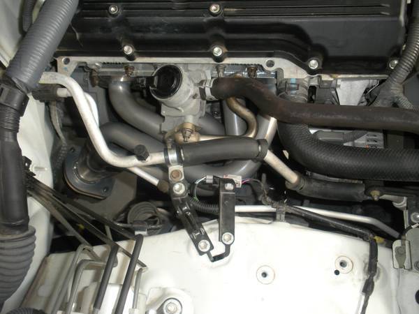

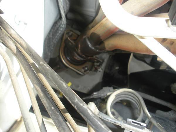

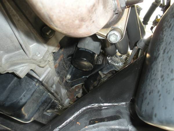

    Had the pleasure of installing an LCE header on my 2.7 reg cab today. Scored from member here. Thanks again. Anyway, soaked the bolts and removed the complete air box & plenum to make room. Figured the extra time to remove some extra stuff would make things go easier. Also loosened up AC line brackets....
    The goods...
    disassembly....
    All out......
    Went back together all nicelike...not a scratch, busted knuckle, rounded bolt/nut, or stripped anything.......
    Looking forward to the ecu getting past the drive cycle and settle in. Redisabled the seat belt chime, went for test drive, all good no leaks, idles 600 rpm then 700 when AC compressor runs. Hoping for a coupla more mpgs. No louder than stock. Also put a clean K&N drop-in in while the aFe dry flow gets a bath and dries.

    that's one clean 2.7l! notice any gains in regard to low rpm pull?

    Thanks. Not sure really on the low end, butt dyno may be on the fritz. It still probably hasn't finished it drive cycle after having battery undone. I have only gone on a coupla test drives around the neighborhood and another awhile ago to recycle 3 gallons of motor oil after doing wife's car, my car & this afternoon the truck's oil. Does seem to go easier and smoother especially after the oil change. Doesn't seem to need as much pedal to go. Tried to get some fresh plugs at 2 different places but no luck, one place had 2 denso iridiums and other had none. Not puttin anything else in it except factory spec denso iridiums. May go ahead and pull the resonator from the fender well whenever I do the plugs and just leave it alone and drive it.....after I do the URD short shifter kit that's hangin out in a drawer in the tool box....and the cb......and the hitch since I left that on the 05......yeah, I'll never be done so scratch that. There's always somethin to do, lol.
