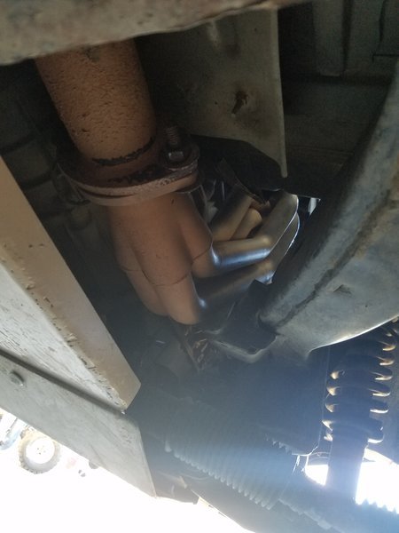

    So I found my answer by doing it. I've now driven over 200 miles with the LCE header and haven't thrown a code.
    The LCE header is roughly 5" shorter and sits roughly an inch higher than the stock one so some adjustments to the rest of the system are necessary. I did use universal hangers to hold the tail end up. But still used the factory mounts on the frame. I am only using 1 of the factory hangers for the cat pipe. I rotated that pipe so the shorter hanger is now using the mount on the cross member and is sitting above it. It's not pretty but it'll do for now.

    In your 1st post you claim the long tube header Elim ates the 1st cat...but in your last post you claim it's 5 inches shorter.
    So...did you have to eliminate the front cat or the a/f sensor. Or did you keep both cats?
    Some pics and part numbers would be great.
    I've been looking for headers for a while.

    My motor had a mini header with a cat in the down pipe. The LCE header eliminates that downpipe but is plumbed for the egr and a/f sensor. It just doesn't extend as far as the down pipe did. So I only have the second cat left.
    I'll try and get some pictures tomorrow but my skid plates might make it difficult to get good ones.

    I can get more pictures if you need but I think this shows everything pretty well.
