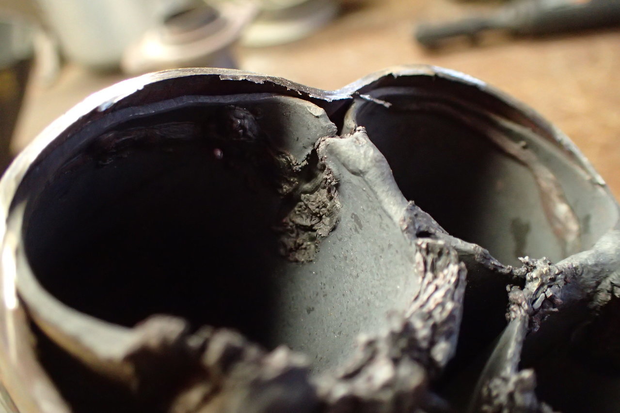

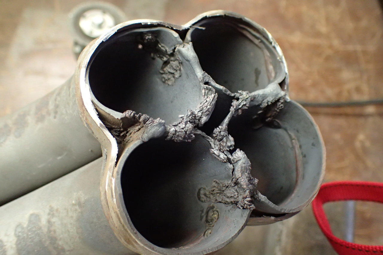

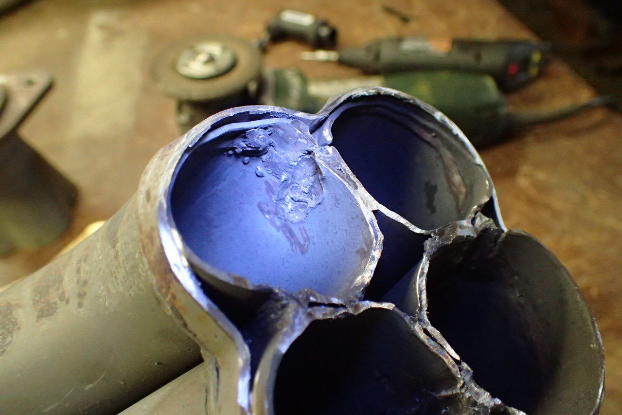

    So after about 2 years my LC header has developed a serious case of rot. I chronicled the issue in the thread linked below but basically most of the welds around the inside of the collector corroded away very badly.
    https://www.tacomaworld.com/threads/change-in-exhaust-note.510762/
    The next two pics are from the thread linked above.

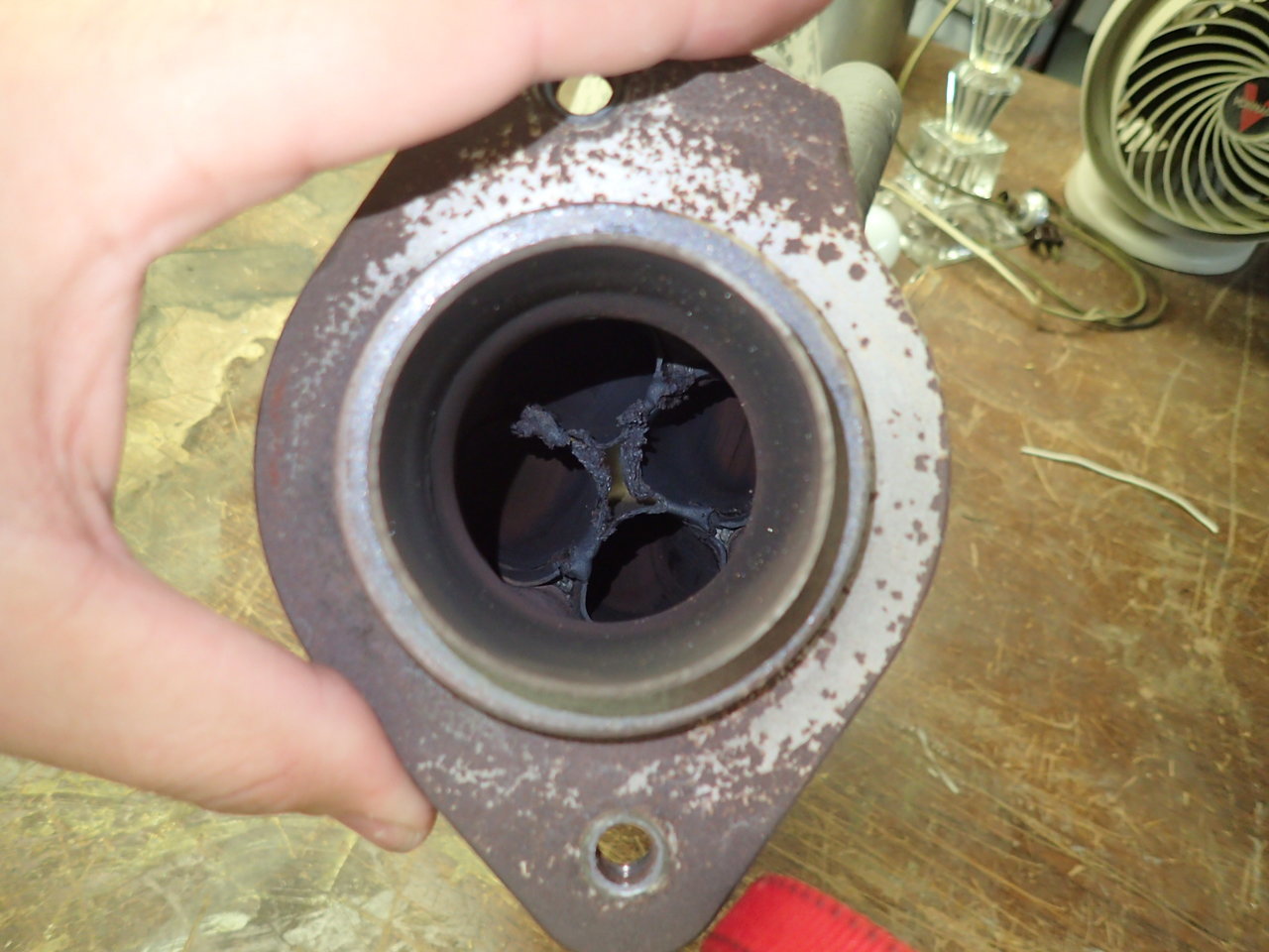

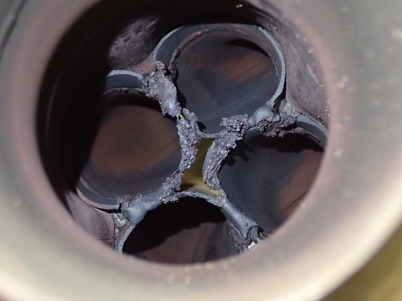

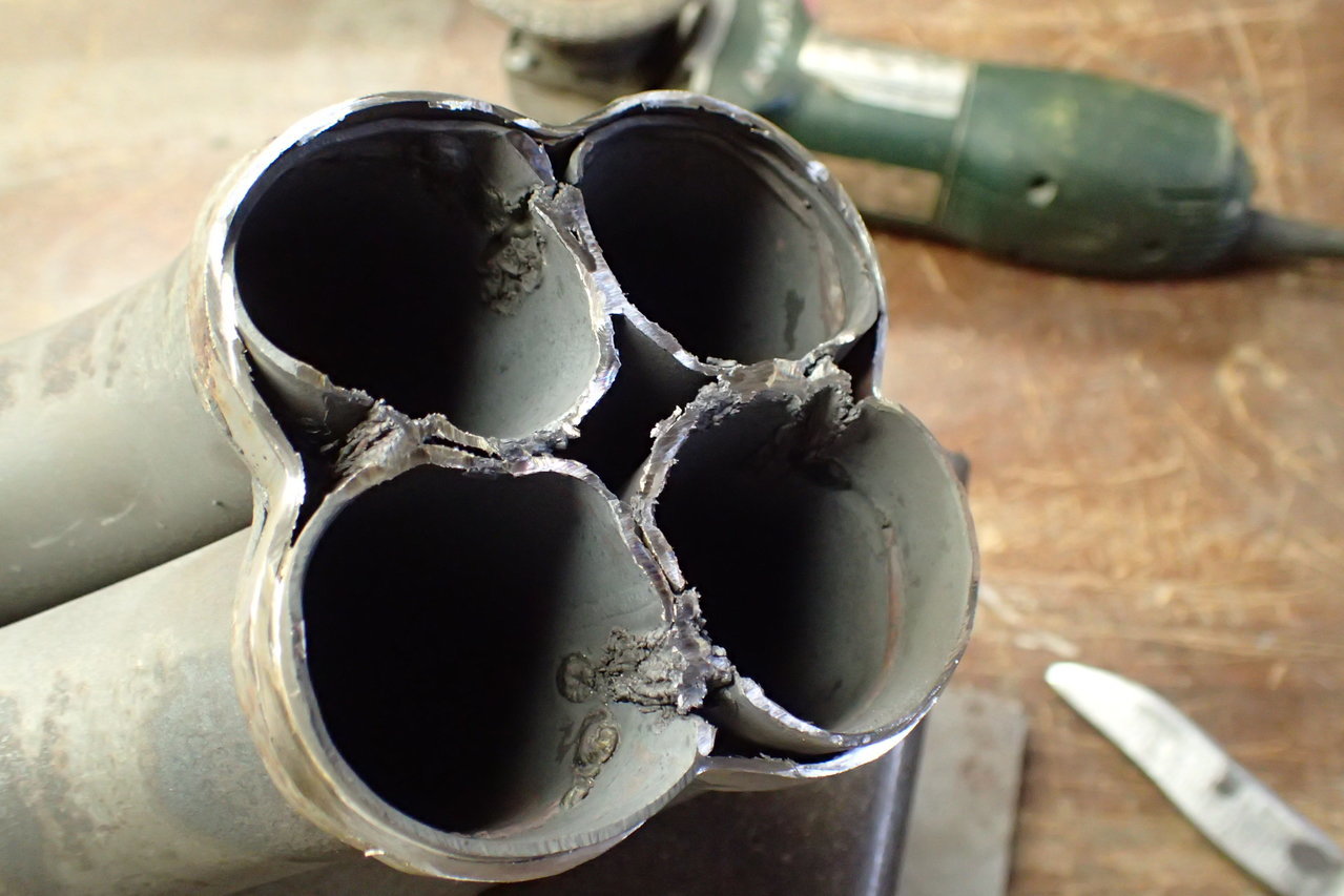

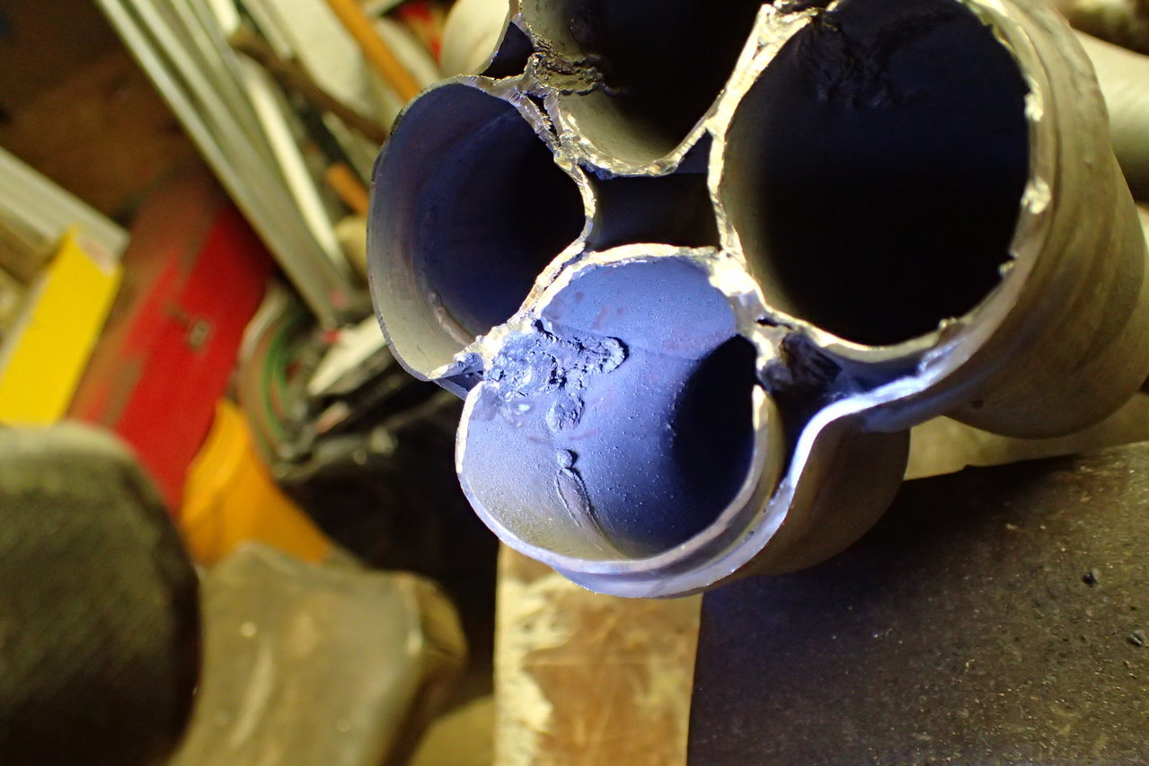

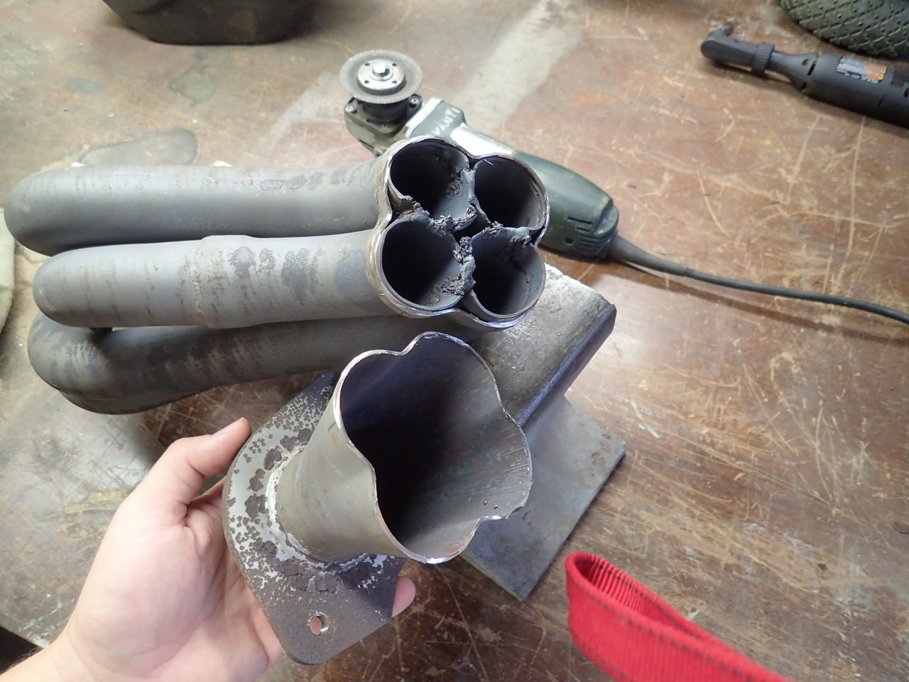

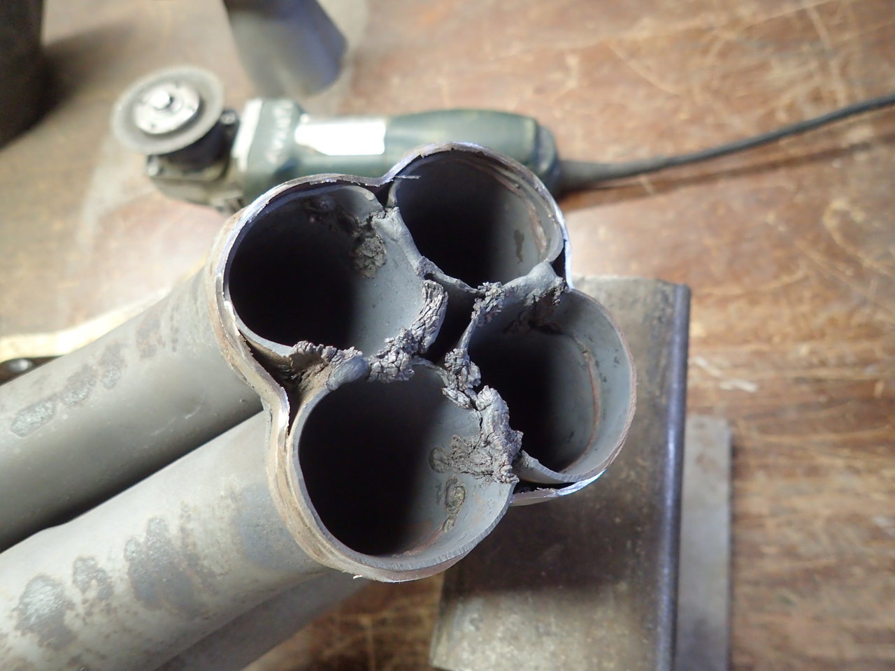

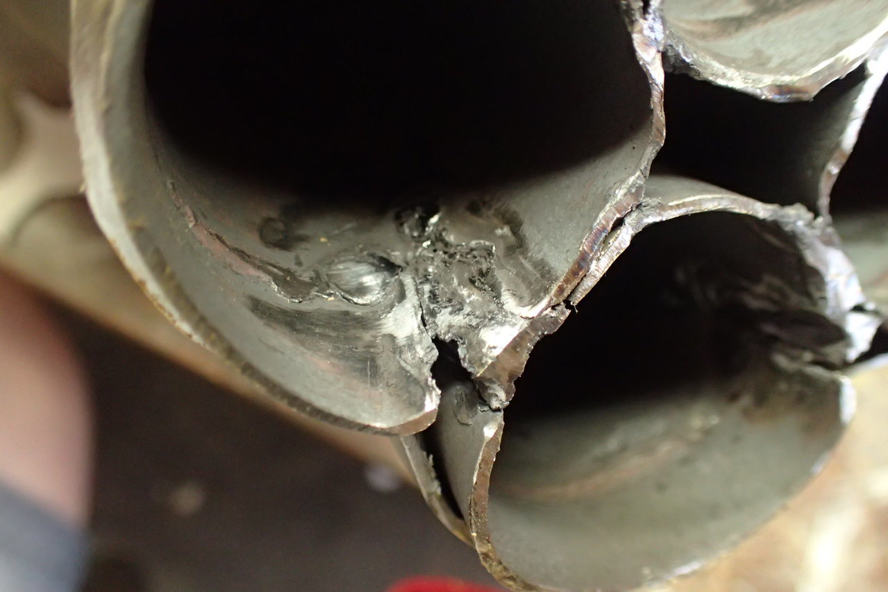

    Now I did have this thing wrapped in header tape so I take some blame for the corrosion but I had assumed the stainless steel would be fine underneath. Well after a little tear down and inspection it seems that the collector and the welds on the collector are mild steel. Both the collector and the welds on the collector are magnetic, the stainless primary tubes are not.
    Here's a few more pics.
    The crustiness inside the tubes is from the welds on the outside that burned through. I'm guessing that because this weld metal is magnetic that these welds were made with mild steel MIG wire. Even wrapped with header tape stainless steel should not react this way.

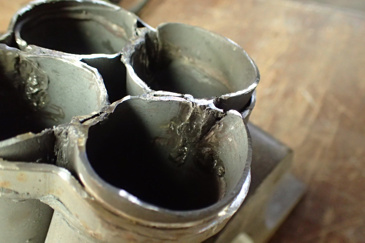

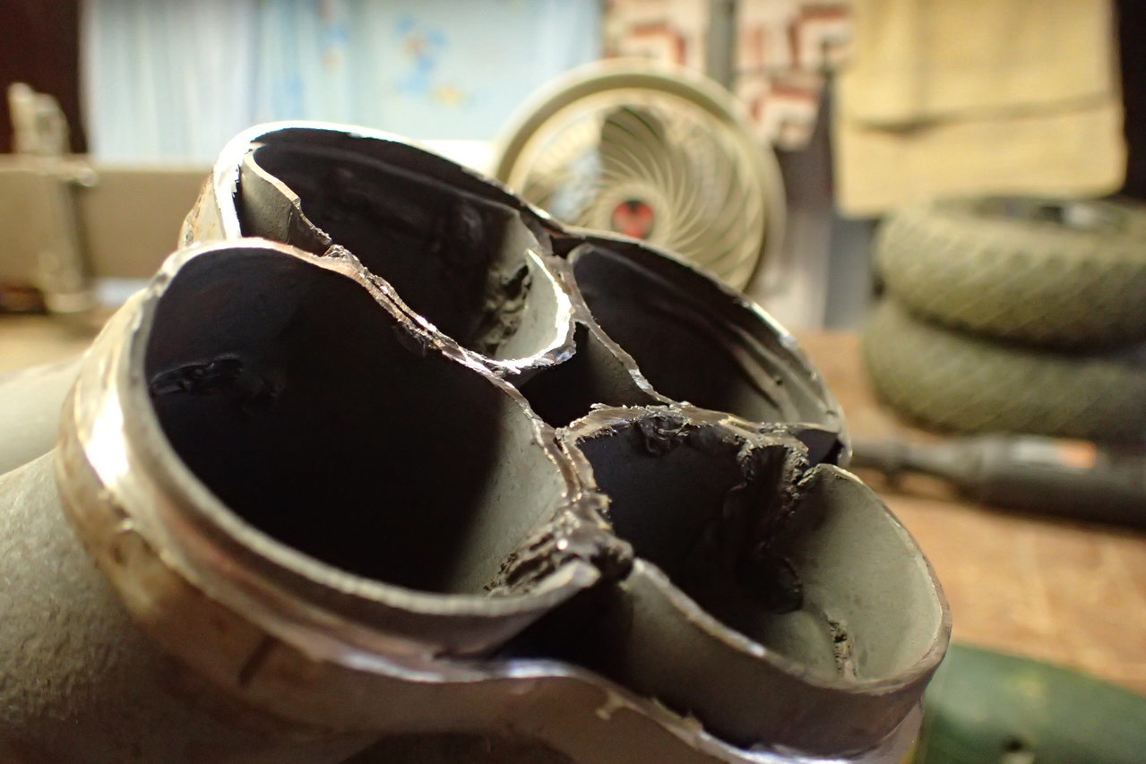

    After a bit of grinding...
    Some more shots of the back sides of some of the welds.
    I really wish LC Engineering would start using ALL stainless steel in the construction of this piece. It's a great bolt on with nice fit and it adds decent power but they advertise it as "Stainless Steel" when in fact only about half of it is. The collector, flanges, and weld metal near the collector are all mild steel. I'm not sure what it would cost to use all stainless in manufacturing but for a $450 header to look like this in 2 years kind of irks me. If this thing were 100% stainless I should be able to pass it down to my grandchildren.

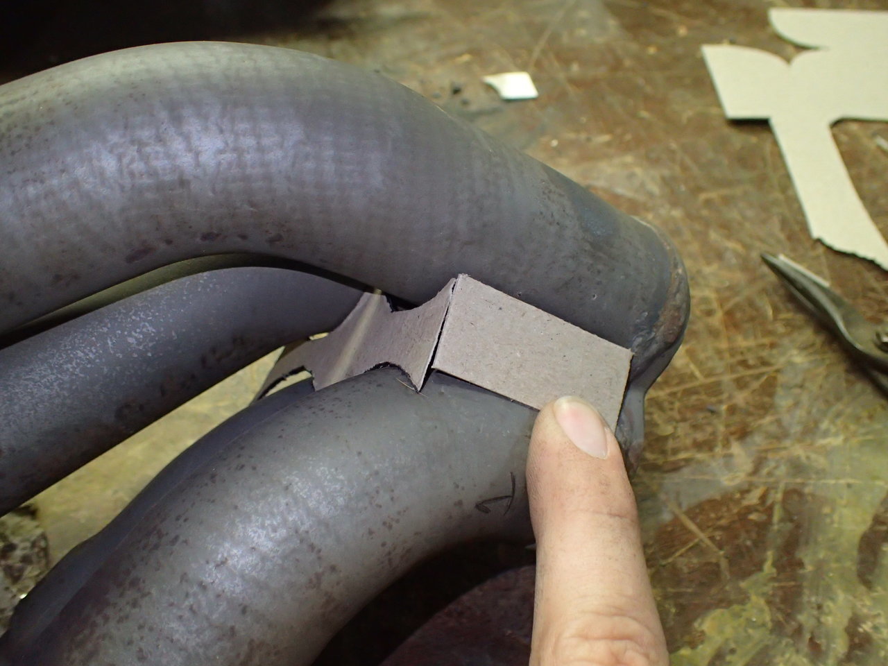

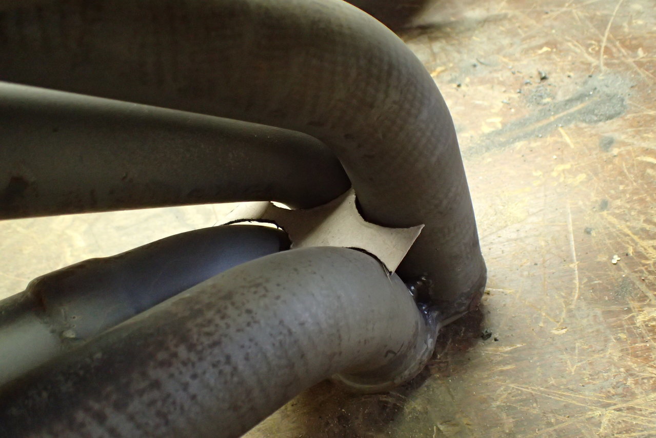

    Here's my plan to fix it. Since the metal is too far gone to get a good weld on I'm gonna try to close off the collector from further upstream. I'll try to make a piece that fills the space between the center of the tubes and then some strips between the tubes down to the collector on all four sides. I made some paper templates to illustrate my plan.
    I can't really think of anything else to try. Getting weld in some of those places is gonna be tough. If any of you guys have an idea I'm all ears.

    Yea, it's possible that any moisture became like steam trapped in the void by the collector. Hot and moist sounds like a recipe for a good time but it's the worst case scenario for steel.
    I had another theory that since the wrap traps heat it allowed the collector to become so hot to the point of turning red. Like perhaps on a long uphill on the highway where there is prolonged throttle. Once steel becomes so hot it will more readily oxidize. It's like trying to MIG weld with no shielding gas. The metal just oxidizes right away and turns into a grey crusty mess like what was on my header.
