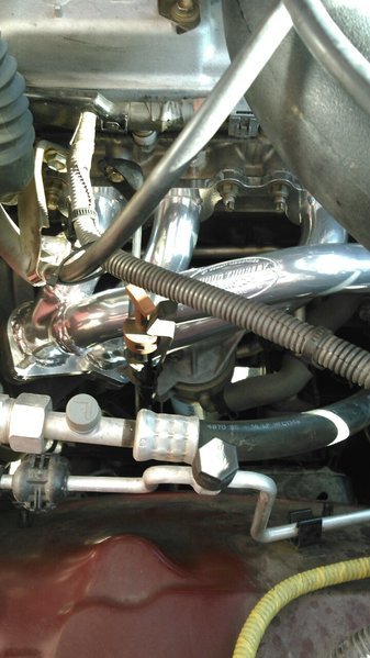

    Here's my Doug's Headers Tri Y shorty on my 02 3RZ 4cyl
