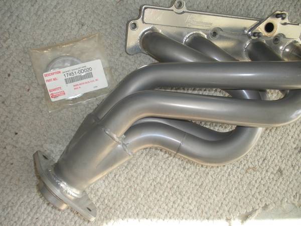

    T@co_Pr3runn3r
    T@co_Pr3runn3r XXXXXXXXXXXXXXXXXXX
    Jan 20, 2009
    #12767
    12,569
    08 RC Prerunner SR5
    +2 on the no o2 tomfoolery. The o2 sensors are downstream from the header/exh manifold on the 2.7. Only thing used from the manifold is the gold pipe in this pic..........
    You can see the hole for it in this pic. It is the only thing mounted on header. Other than that it is just oem donut gasket on collector and exhaust gasket on the head......
