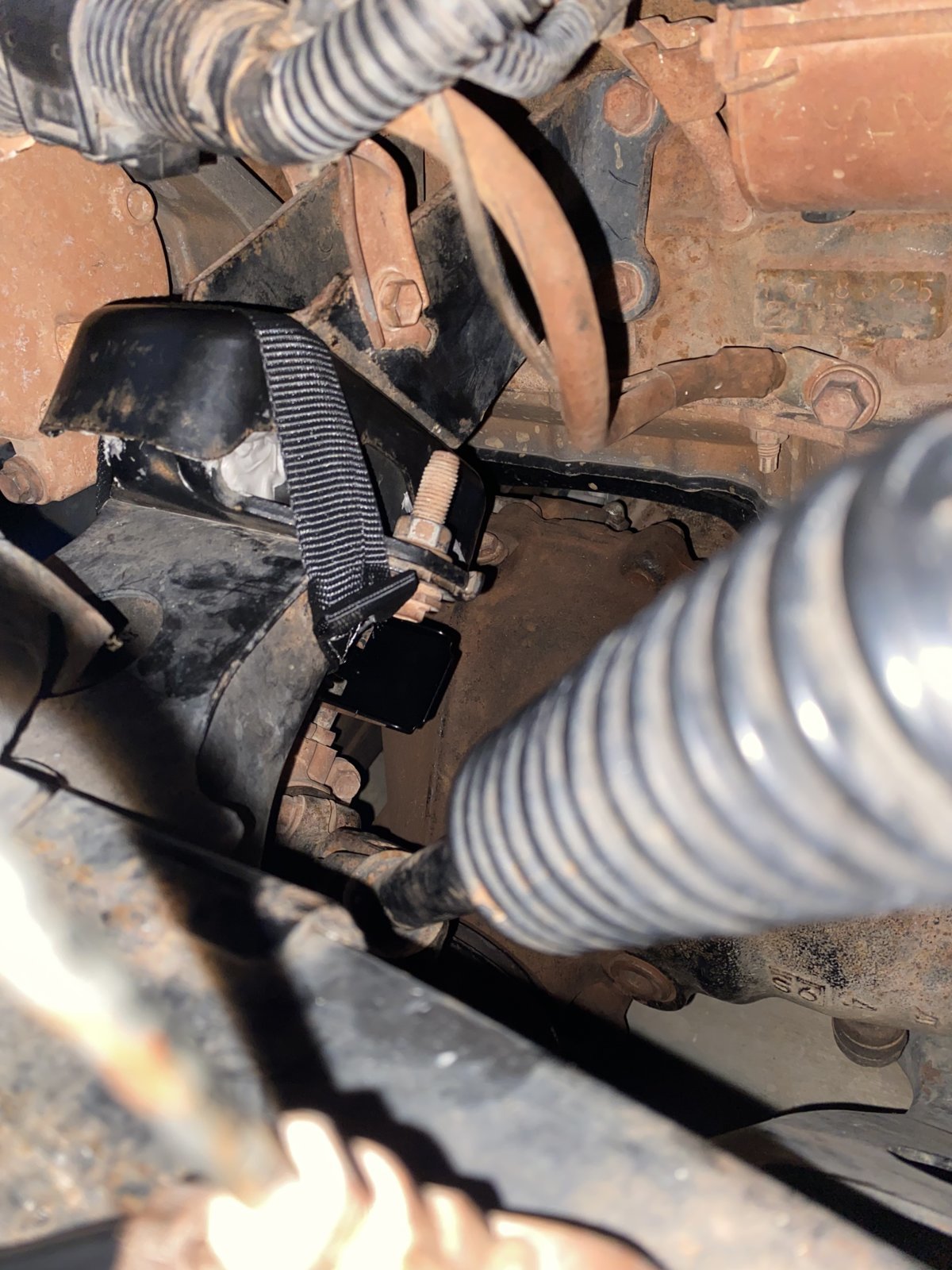

    The ultra grey RTV engine mount mod is doing pretty damn well. Haven’t launched from first yet, but I have soft started then mashed the gas and she isn’t budging much. So far no denting just tapping on the frame there scrapping the coating off. Annoying sound when you get on it, rapid fire tapping.IMG_2446.jpgi did get a $3 ratchet strap and try to help lock down the driver side mount… I think that iswhat’s really saving her right now. IMG_2441.jpg Ghetto.. but works. It is temporary. Strapping this side down gave me an idea for securing engine mount.. the plate between the mount and engine that acts as a cover/shield of sorts im thinking of changing to a gusseted plate which tabs fan out above the frame bolts. I can ditch factory bolts to use longer grade eight bolt with a top lock nut to sandwich the stock mount tightly to frame. It will act as a dampener but not budge. I’ll play with that idea at work and conjure something up. I’ll post that up definitely. Be any easy upgrade to stock mount to essentially hard mount.

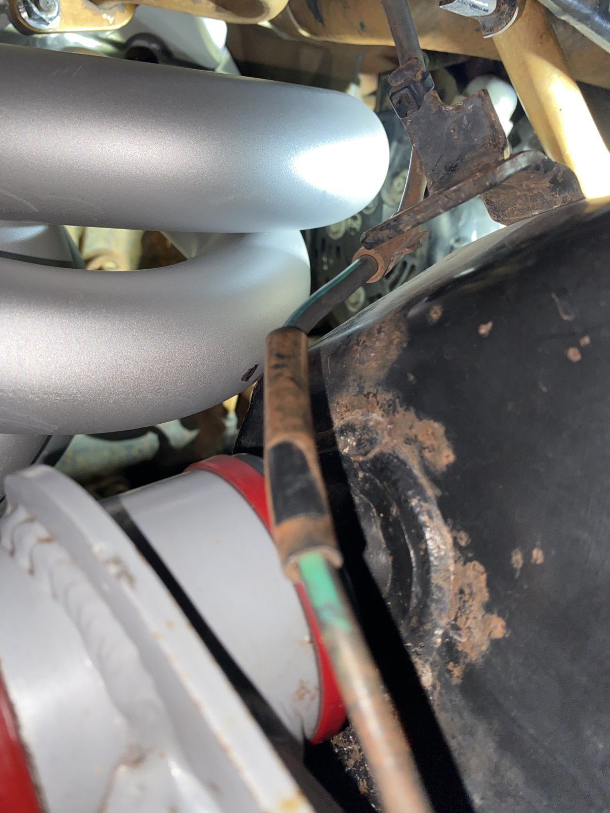

    I did get a chance to speak with the guys at LCE. They are reviewing my findings and will get back to me soon. I hope some tube rearrangement is in order but keeping that collector flange placement. It was refreshing to have something line up nice for a change, customization really is a headache sometimes so I’ll take wins wherever I can. I look forward to hearing back from LCE. I’ll update on the matter when I do.

    I do not recommend LCE long tube header for 3rd gens to anyone yet.
    I didn’t hear back from LCE so I went ahead and contacted them. They are still in the process of looking into the issue and going over my findings with their fabricator. Not much of an update, but I do appreciate them taking the time to speak with me nevertheless.
    Fingers crossed that when they do get to bottom of this, it’s some minor issue. Would be great to hear that it’s resolved and fitment problems like this will be a thing of the past. I will update here again as soon as I hear anything.

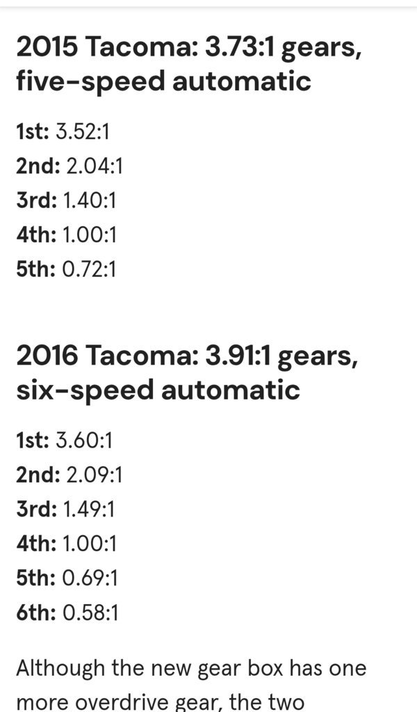

    He has 4.30s unless the truck was wrecked or something odd all auto 2.7's came 4.30s out of the box still way undergeared.

    This is where I got the 3:91 number. Apparently it is not correct. OR possibly these are V6 numbers???

    Thanks Nyrob for the info.....I looked up my axle code--A06A-- and you are correct, the info on that states that it is a 4.30:1 ratio.
