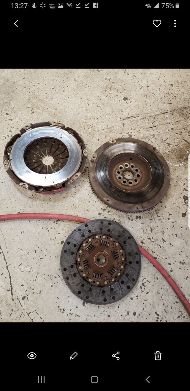

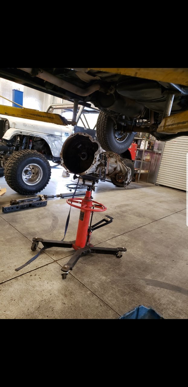

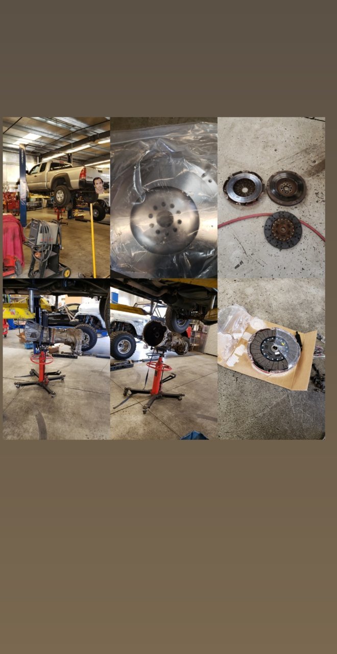

    Story started when at 15kish my stock clutch more less detonated and I debated getting a stock clutch again or upgrading. I weighed my options and ended up resurfacing my flywheel and putting in an LCE pro clutch. This worked out really great for approximately 70kish until the clutch was toast. At least this clutch did not detonated itself.

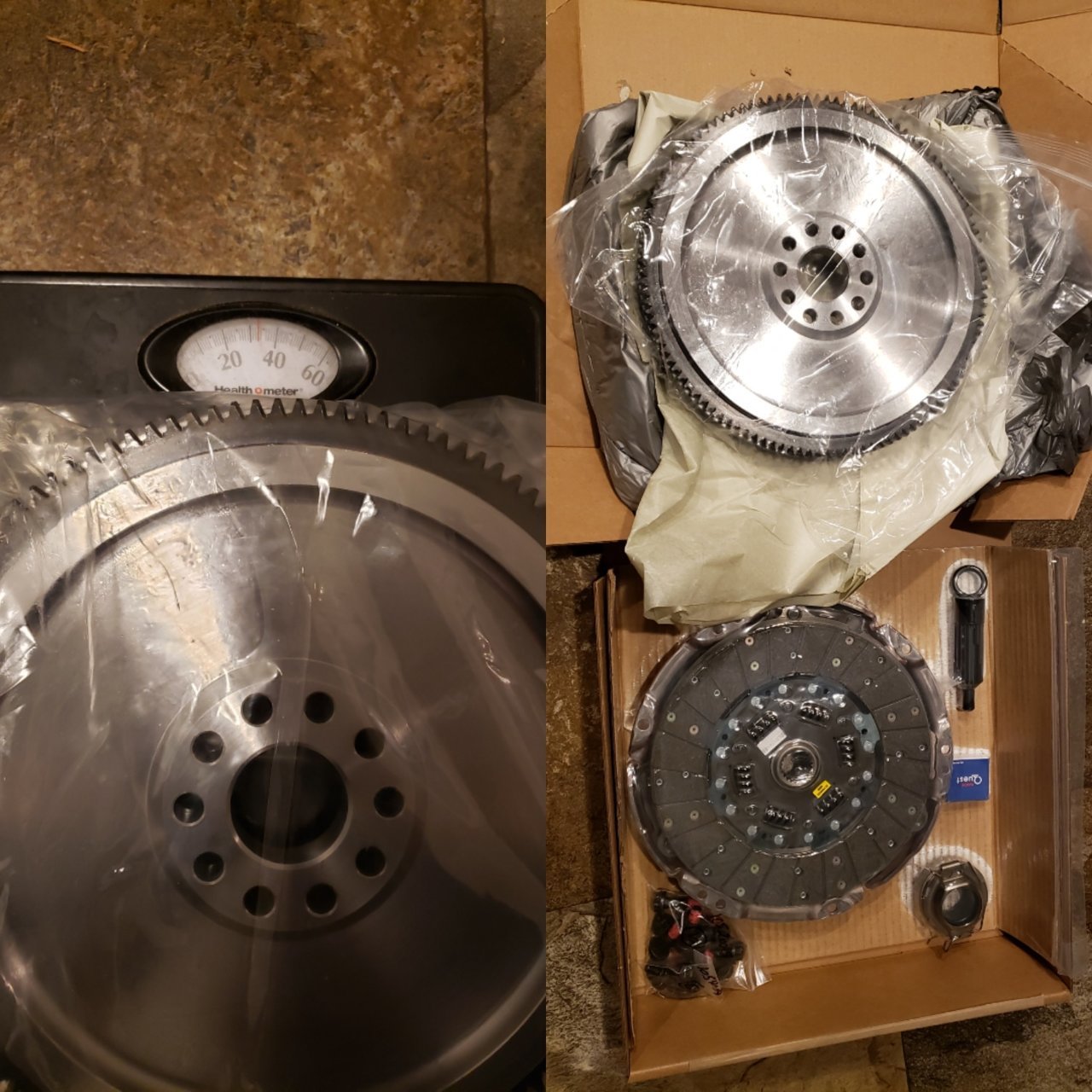

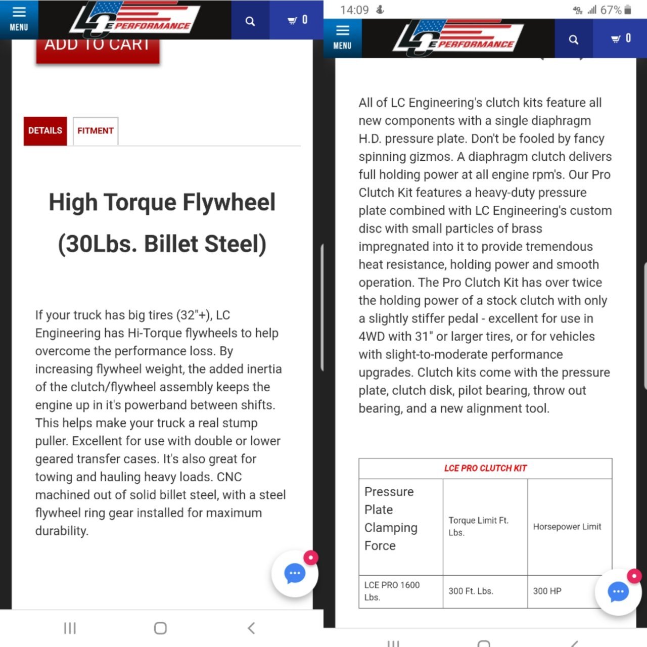

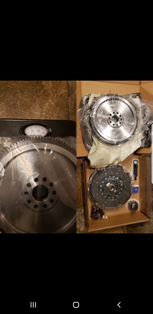

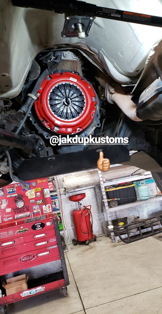

    I really did like the LCE pro clutch feel and didn't feel the need to upgrade to a different clutch. My 2.7l doesn't produce much more power than a couple of angry squirrels trying raid a bird feeder. How ever this time I went with the LCE high torque heavy flywheel 35lbs after doing some "bro" research.

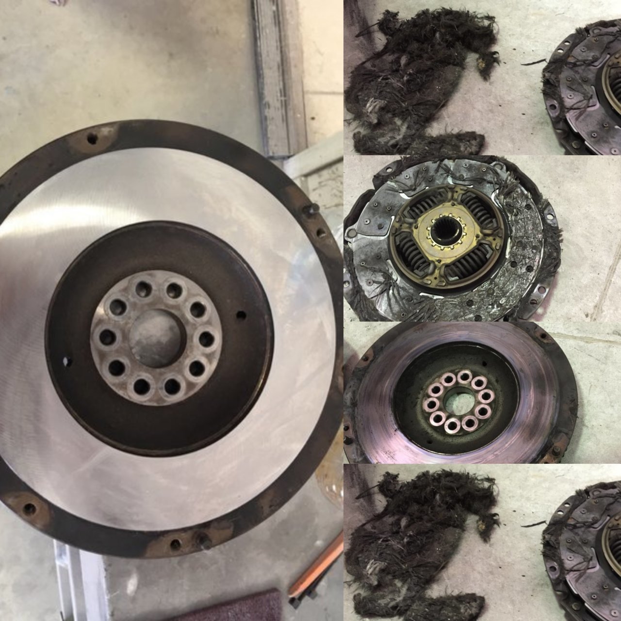

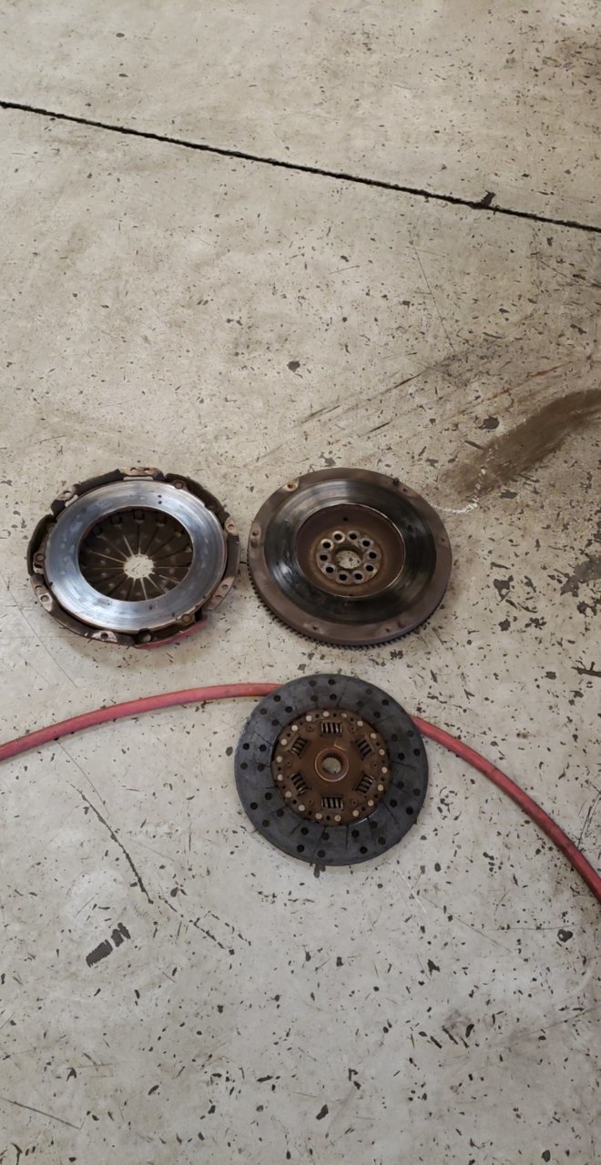

    Carnage of the stock clutch and pic of resurfaced stock flywheel from first go around

    Carnage of worn out LCE pro clutch after 70k ish way less drama

    The combo I have chosen for the four banger and the flywheel is not 30lbs as advertised it is 34-35lbs vs 23-24 stock
