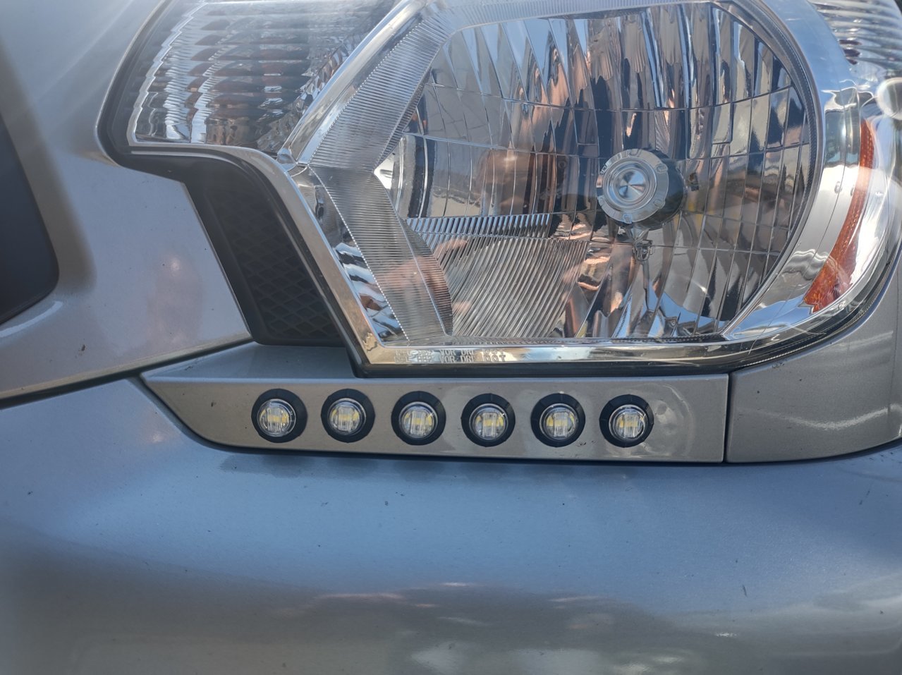

    My do-it-yourself daytime running light for my Tacoma 2015. Bought the bulbs at Amazon, completed the project and saved hundreds of dollars.
