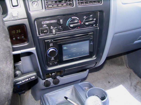

    GPS/Stereo Head unit (DONE)
    Install Head Unit (DONE)
    Mount GPS Antenna (DONE)
    Mount Mic (DONE)

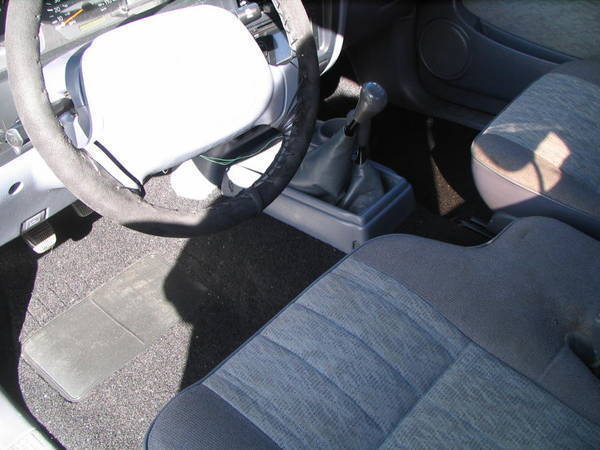

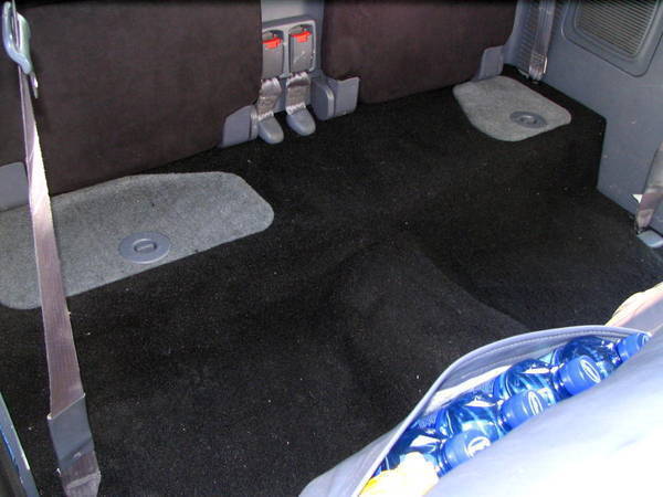

    Bypass (DONE)

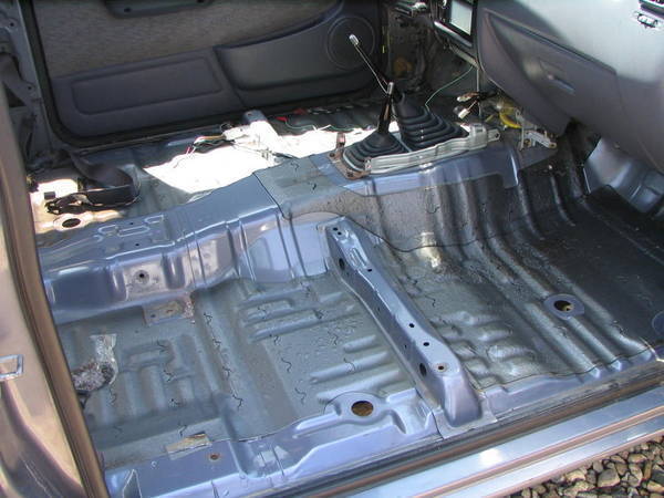

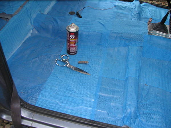

    Replace Carpet (DONE)
    Remove Interior (DONE)
    Remove Carpet (DONE)

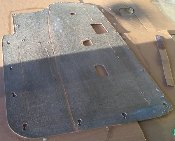

    Install Sound Dampener (DONE)
    Cut and fit new Carpet (DONE)
    Cut Storage Compartment Holes (DONE)
    Cut Carpet to Fit (DONE)
    Cut Bolt Holes out (DONE)
    Install Interior (DONE)

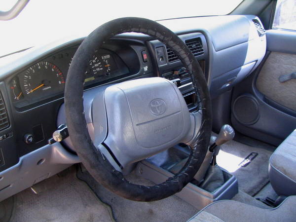

    Leather Steering Wheel Cover (DONE)

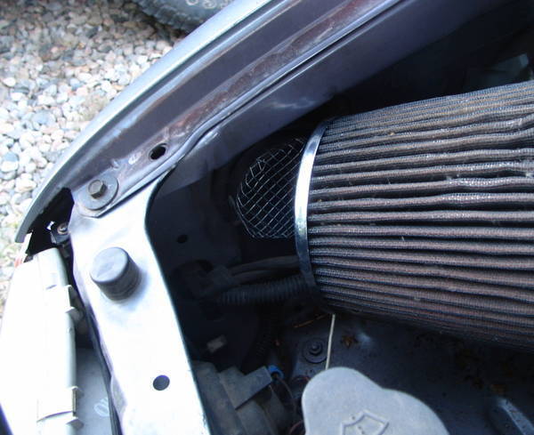

    K&N Intake Mod
    Enclose Intake (SKIPPED, flow dynamics says this is a bad idea without a lot of modding.)
    Relocate Air Source to Cold Air (SKIPPED, more trouble then it's worth.)
    Open up existing air draw in wheel well (DONE)

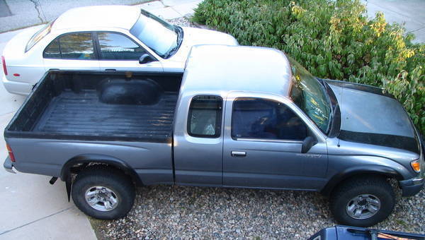

    It's interesting how the camera exaggerated the difference in the blacks.
    Balcony view after the lift and the flares.

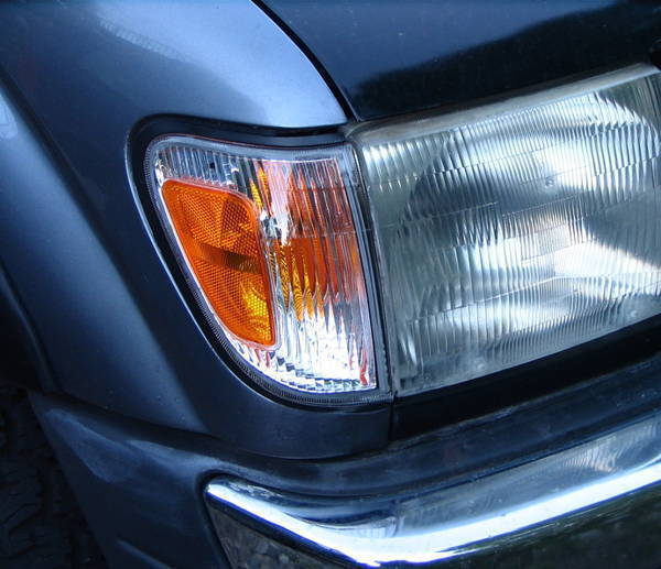

    New marker light, makes my headlights look like crap...

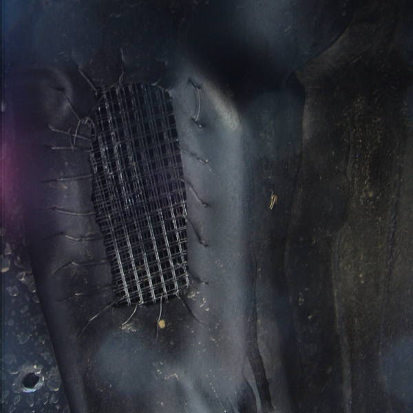

    Debris screen I put over the air intake pipe. You can see the seeds that kept getting in my filter too.
    Hole I cut in the wheel well for better air flow.

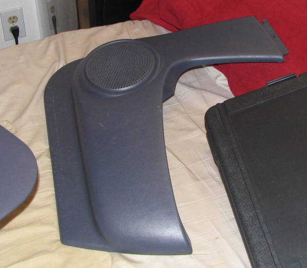

    Reupholstered passenger panel.

    The K&N I've got is the full intake. I can't say how much it's helped as the previous owner is the one who installed it. I'm planning on enclosing it and relocating the air intake to the wheel well like it originally was. That way I will get the benefit of the increased surface area of the can intake and still be drawing lower temperature, and hence higher density, air.
    Your probably better off doing a drop in K&N filter + the deck plate mod. That way you don't change the air intake location to the corner of the engine case where it draws in warmer air.

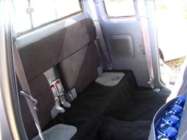

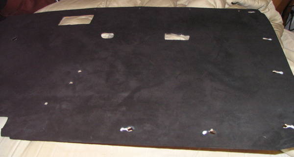

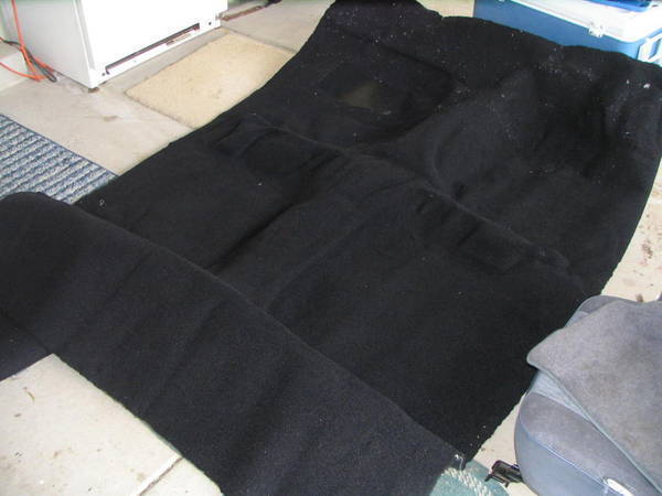

    Updated with pics of new carpet and rear upholstery.

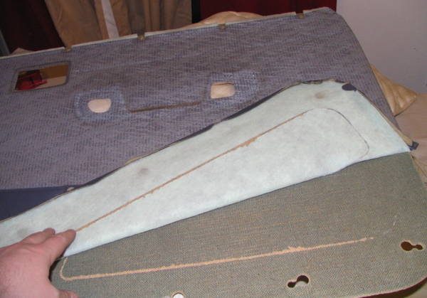

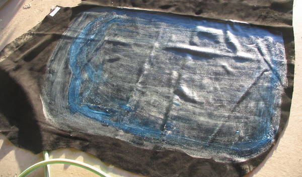

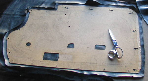

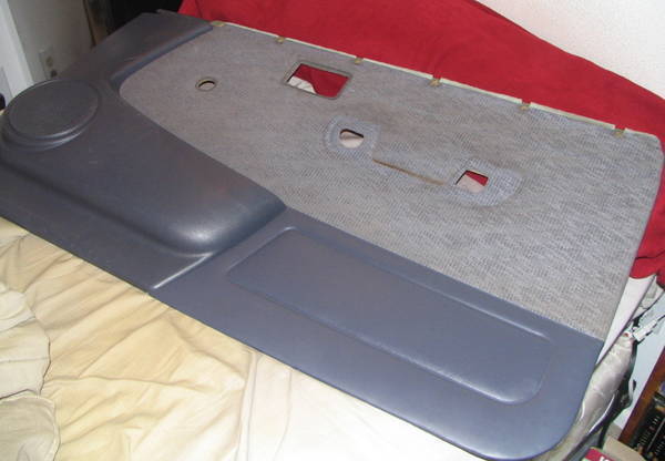

    I didn't paint it. I took the door panel off and replaced the fabric with some black split grain leather.
    Took this thing off.
    Pealed off the fabric.

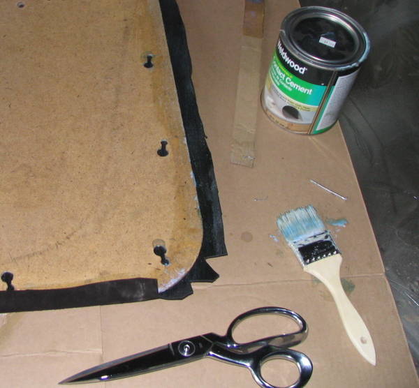

    Coated both pieces with contact cement.
    Applied the panel to the leather once the cement was dry.
    Stuck the edges onto the back with some more contact cement. You do have to cut the corners with those scallops so they fold back flat.
    Cut all the holes out.
    Realized I shouldn't have cut the holes for plastic mounting studs out. I did patch these, but it added about 1 hr to the process. *doh*
    Put the plastic piece and all the mounting studs back on.
    Then put the panel back on.
