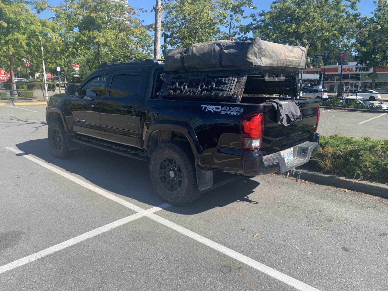

    Serge
    Prince George, BC
    Black 4x4 Sport MT 2018
    Some Serious Tires
    I too have medium dobinsons leafs and they are great so far. No squeaks as well, had them for about 15k miles.
    About 200 pounds of constant weight in the rear, no sag.
    71tattooguy likes this.
  17. Jan 23, 2023 at 2:38 PM

  20. Jan 23, 2023 at 2:43 PM
    #20
    LA_Taco
    LA_Taco [OP] Active Member
    Apr 1, 2018
    #249097
    33
    2018 TRD Pro Black Midnight
    That's a nice looking rig. I have added Dobinsons to the list of possibilities now.
