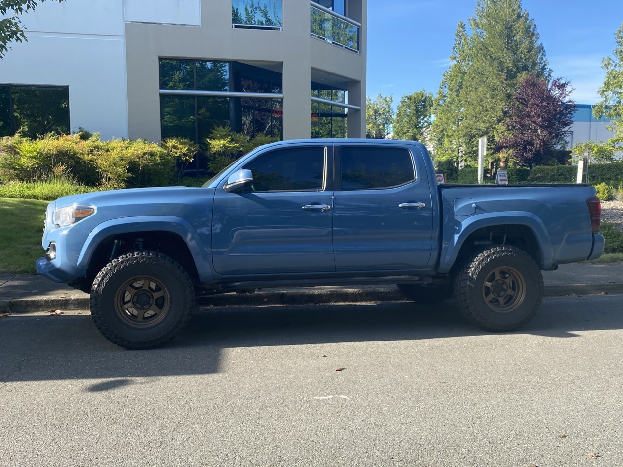

    I’m on deaver u402’s stage 1’s. I do have an alucab canopy and always have 4 traction boards in the bed. Love the way it rides and was a huge improvement over stock leafs and blocks and the icon 3 leaf aal.
    this is how it sat with just the oem tonneau cover on.

    How did it ride with just the tonneau cover?

    honestly I couldn’t tell the difference when I swapped on the canopy. Canopy only weighs 125 lbs. I love the u402’s after removing the 3 leaf aal it was a huge change. I’ve had multiple people comment on how good the truck rides.
