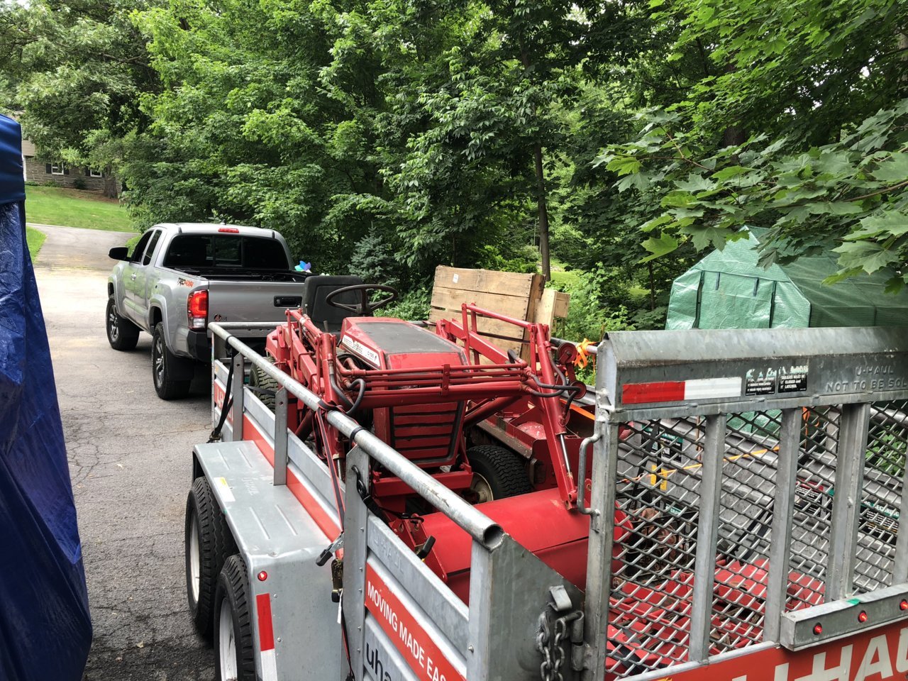

    Stock leaf pack with an AAL (and 5100s) is an easy affordable upgrade and you can keep the overload in.
    Just towed ~ 4000lbs pretty easy

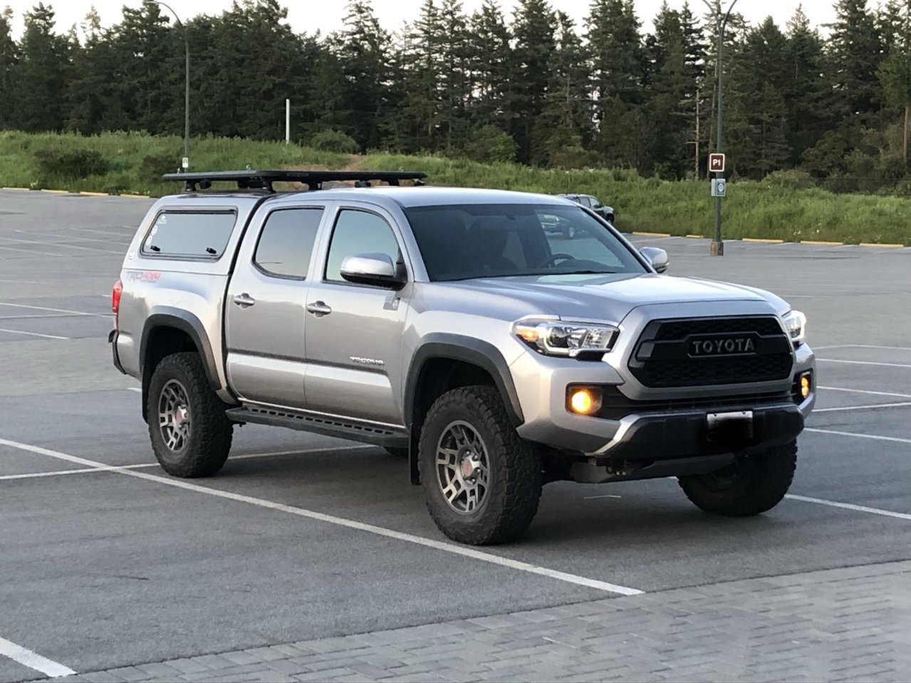

    I am a minimalist and mostly want to keep my truck lightweight and fuel efficient. If I didn’t feel the stock Offroad shocks were terrible I wouldn’t have touched them. However, with any sort of weight in the back, on any sort of rough road, they just got red hot, faded
    out, and I was smacking my bump stops.
    5100s were a perfect upgrade for me and I feel they improved the on-road manners as well. I also put in an adaleaf and I’m pretty sure in done.
    OEM springs on front. Truck has about 1.5” of lift and factory rake has been maintained.
