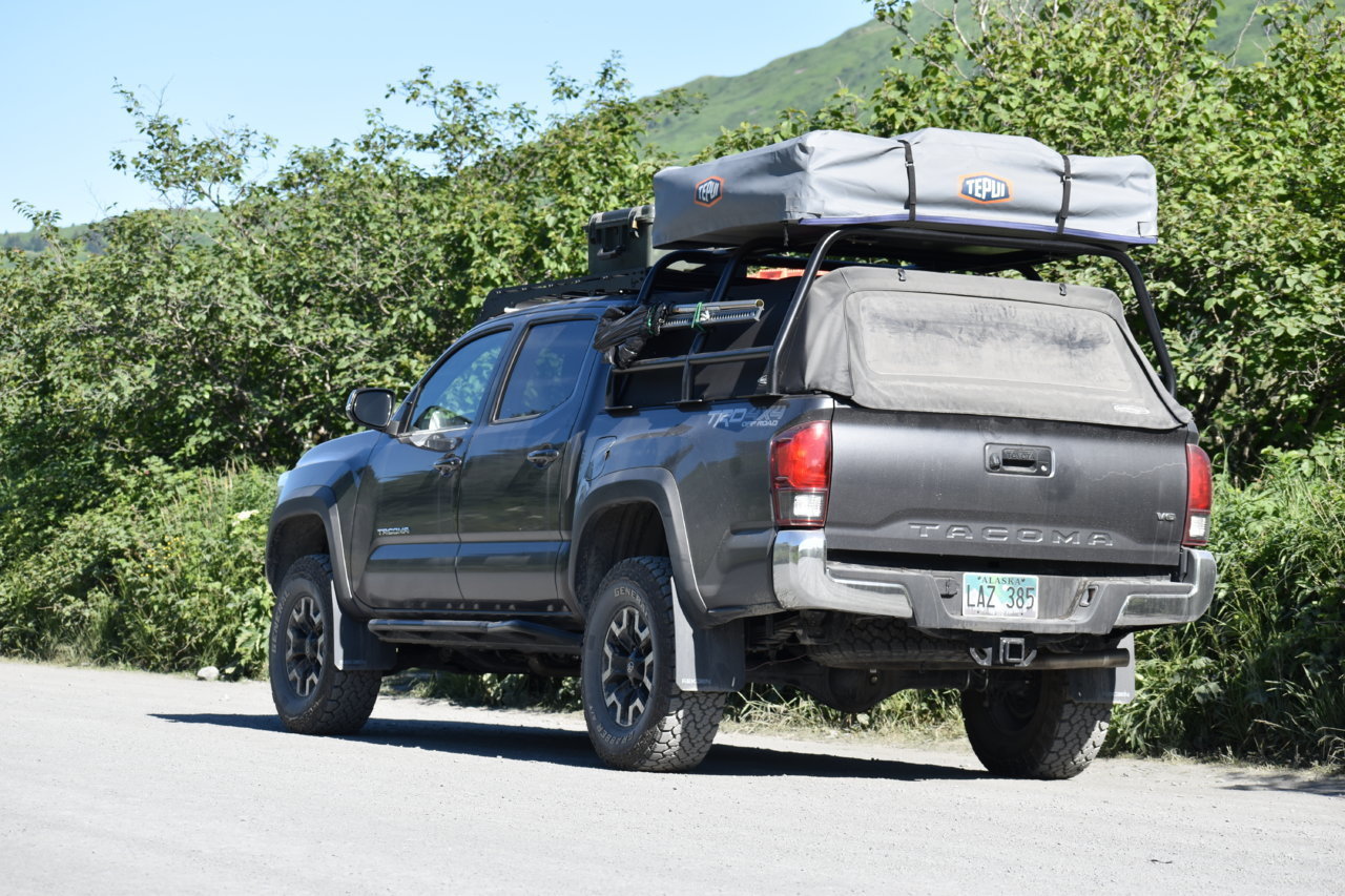

    Can you fold your softopper with that rack?

    You’re wanting to add all that weight and run 33” tires without changing the suspension too much? It’s going to rub, bub.
    Besides that like others have stated, all that weight is going to sag your rear end. You could probably get away with an AAL, but something like a MD pack from @Blackout14 or OME would do even better.
    You’ll need new bump stops and a shackle flip, depending on what you do.

    OME medium duty should work with no lift. I think it would be wise to buy the HD pack though and remove the extra leaf if you need to. That is easier and cheaper than adding it later.
    There are of course more expensive options but that is all you really need for the leaf pack. The other poster is correct, expect to kill your rear shocks with any continuous bumps. 5160s are a quick and easy upgrade.
    My fear would be you are going to get significant sag in the front from the stuff on the roof. I got over and inch of sag just from skids and sliders.

    What rack
