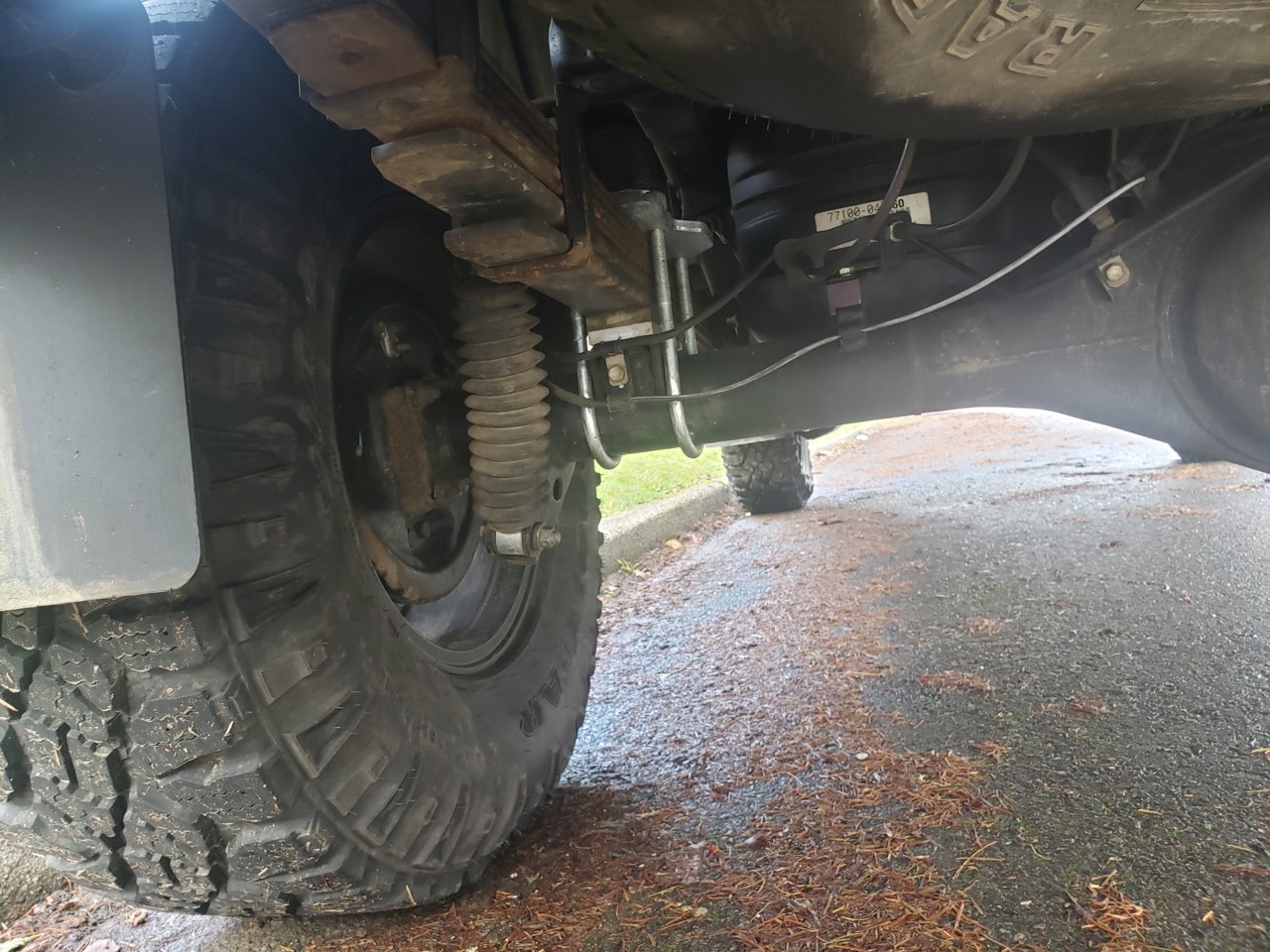

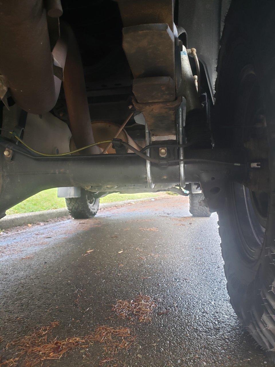

    Never stack lifts; i.e never stack a stock leaf pack replacement (lift #1) with a block spacer (lift #2). Having side specific leaf packs labeled is associated with the lean from the driver and the gas tank when it is full, yes.
    I am not aware of any "driver's side" lean lift block for rear lifts. They have them for front lifts, sure.
    I am interested in seeing photos of your lift. Some things sound very fishy...

    Here is a link to a "lean" spacer/shim I am talking about: Wheelers and Toytec both sell the 1/2" shims. I have Dakar's with 3 degree pinion shims and a 1/2" "lean" spacer on the drivers side. If Deaver's already account for the lean then I would love to ditch the 1/2" spacer. But, the amount of lift with Deaver's on a Gen2 is the question.

    Shims are for the diff pinion angle to address driveline vibrations. They are not for lean and they are supposed to be installed in pairs; not on single sides of the axle..

    I have matching pinion shims on both sides of the axle (left and right) with narrow end pointing forward to direct the pinion upward 3 degrees. The drivers side has the 1/2" "lean" shim. I am aware of what pinion shims do...that is why I installed them! Thanks for your input.
