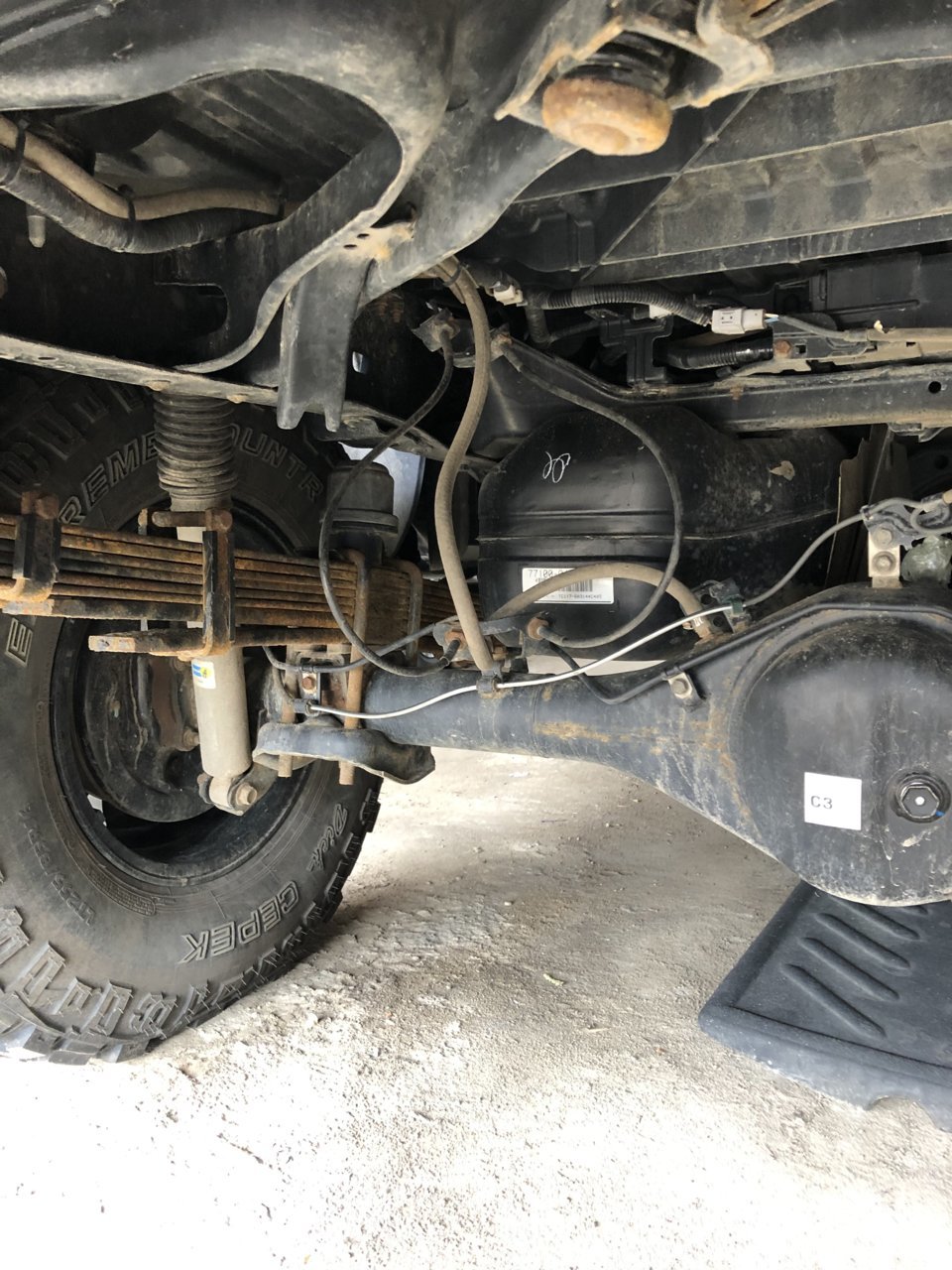

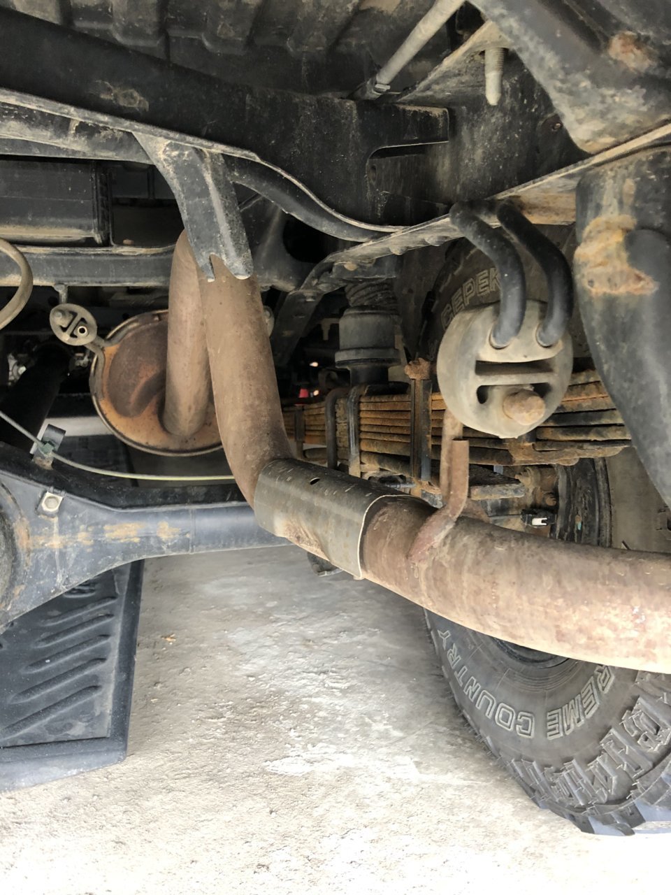

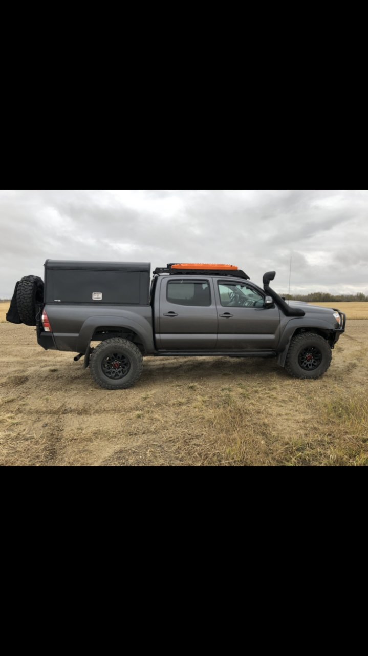

    I’m going to be likely switching to Deaver Expo stage 3 since my Dakar pack isn’t cutting it. These are the old CS047R leaf packs (equal to the current heavy) with the OME D29XL aal. They sagged a bit and then are negative arch or “W”as seen in the pictures after only 2 years. In the pictures the truck has about 95% of the camping weight. I have CBI steel rear bumper with dual swing outs (33” tire and 40L of fuel), steel sliders, full aluminum skids and an aluminum front bumper with 9500lb winch. Prinsu rack and aluminum ARE DCU cap. The truck sits level with all that weight but I do feel the bumpstops when hitting dips on the highway. I’d like to gain a little rake back with the Deavers.
    5FE08DD0-E5B7-4E41-A60B-A476ADD80C83.jpg DB2EA8A2-9D71-4ECD-98D7-6B87665F4889.jpg
    New before install.
    Truck fully unloaded. My guess is it squats at least 2”+ when fully loaded.
