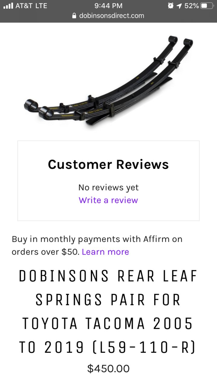

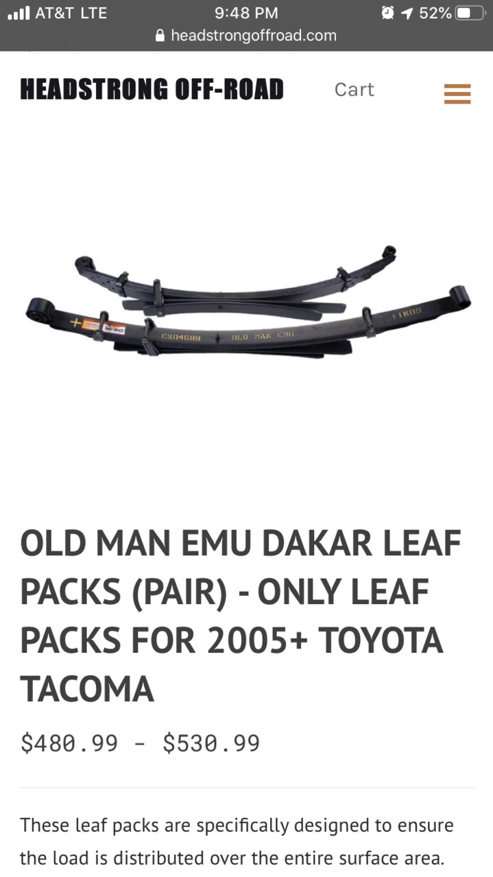

    I’m looking to get new leaf packs for the rear of my 16’ taco because I’m lifting and I overloaded the stocks springs and they are no longer arched. I’m also fed up with the squeaking after every trip off-road.
    With that said, what do y’all prefer? Ome Dakar or Dobinsons. The Dobinsons are slightly cheaper but that’s not a huge deciding factor.
    Does one have more sag over the other after time goes by? Is one noisier over the other? Both being in “medium” load rates does one provide more lift than the other?
    Just wanna get the best option out of the two and at this time these are the only leafs I’m considering due to cost.

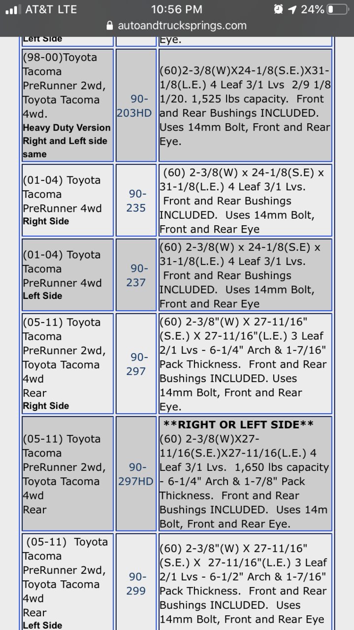

    C6D91C8C-006C-47F0-8116-064EA69048D3.jpg Also looks like ATS only offers springs for 2011 and down

    2005 and newer are all the same. I contacted them on IG and the guy provided great service. They have 3 packs, 4leaf MD, 4leaf HD, and 5leaf HD. All have an overload in addition to the leaf count. I run the 4leaf HD and have around 500-600lbs in the back and still have around 2”-2-1/2” of lift. Rode just fine before I put the camper on too with no weight in back
    Editing to add I was definitely at 3” or just over with no added weight. They provide quite a bit of lift
