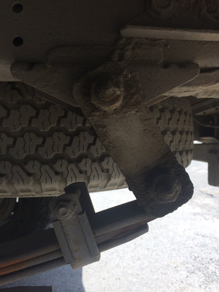

    Yes that side too was replaced and shackle angle sucks. See photo below under no load. 20160417_131118.jpg

    Okay. Now we are getting somewhere.
    1. Remove both front spring hangers from frame.
    2. Hard part here. Since you do not know where the exact stock location is you will have to base one of them off of shackle angle. After you tack one of the front spring hangers in place, you need to put the other one IN THE EXACT SAME POSITION. (not like you currently have where they both mismatch) You want the shackle angle to be about 55-60 degrees stock on flat ground (Your pictures show the driver side is about 0-5 degrees and passenger looks about 35 degrees). I will attach a pic of my truck to help you here.
    ALSO: make sure to center the axle sideways (not too far driver side, or too far passenger side.)
    Hope that makes sense and take pictures as you work to make sure you aren't messing it up again.

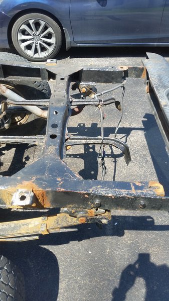

    so my frame is bent. passengers side has always sagged compared to drivers side. i believe this has to do with old bed and the fact that it was rusted out and flopped around on frame...especially right rear.

    Sounds like you need to get that fixed.
