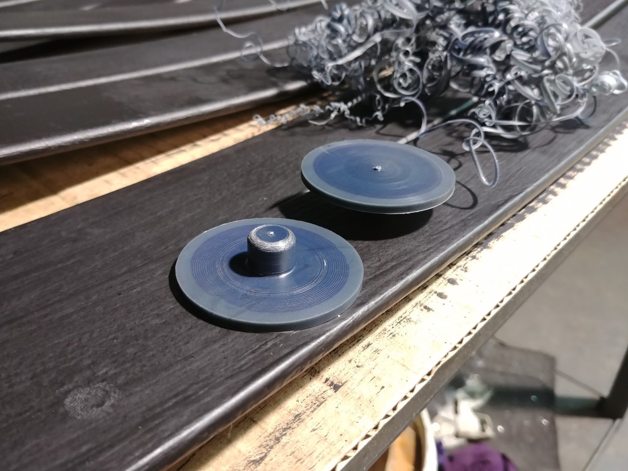

    Took my Expo leaf packs apart to refinish its rusty state and most of the friction pads were so brittle and most of them broke in pieces in the removal, did some research to locate some replacements. The price for 22pcs plus shipping to Canada made me rethink of the purchase and luckily the shop was very slow so I machined the pads using Delrin plastic, press fit .010 oversized and mushroomed the 1/8 longer knob on the bottom using a hydraulic 80 ton press 20181129_112128.jpg

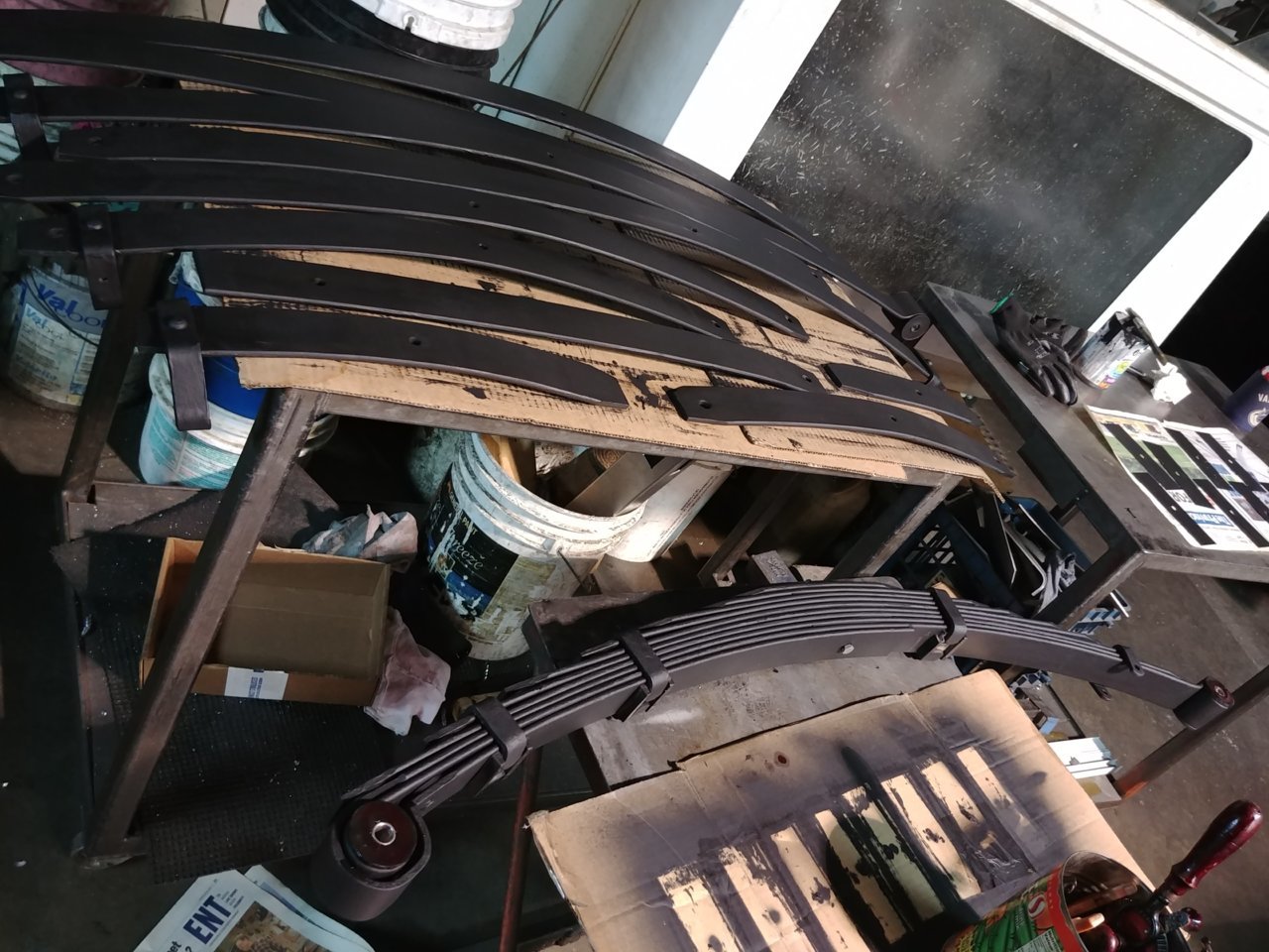

    Picked up a set of All-Pro Expo's in pretty rusty conditioning, any feedback on the reassembly, and what sleeves/bushings you used?

    All I can say in tackling this project is, with all the hard work, I hope it prevents the rust for a long time
    One tip I can give ya, is do one leaf pack at a time so it can be assembled properly because some leafs do not have the center pin holes in the center
    I do like the outcome though, sure looks purdy all painted up:thumbsup:

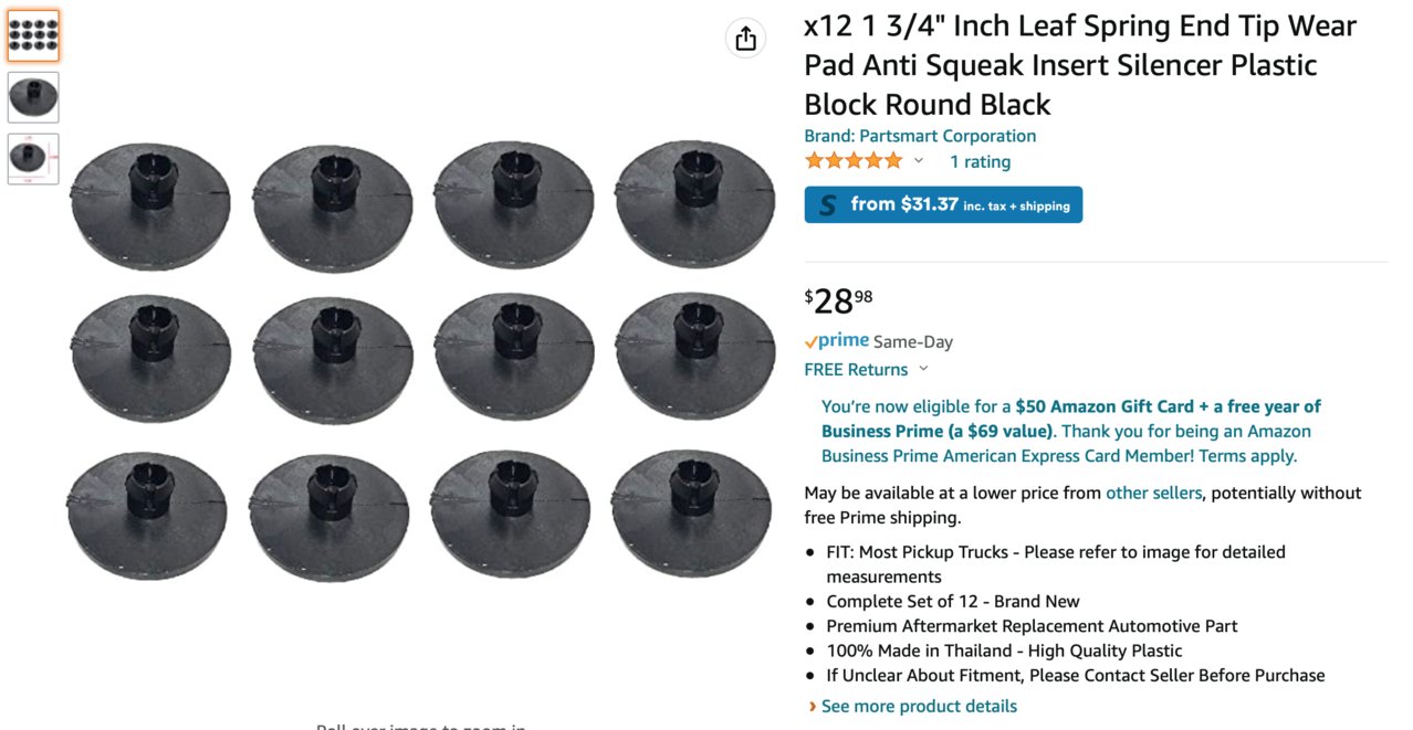

    You could always use these, they work. Been holding up great for me and no more squeaks. I have them in closer to the ends of the springs.
    Link -- https://amzn.to/3iFezeH

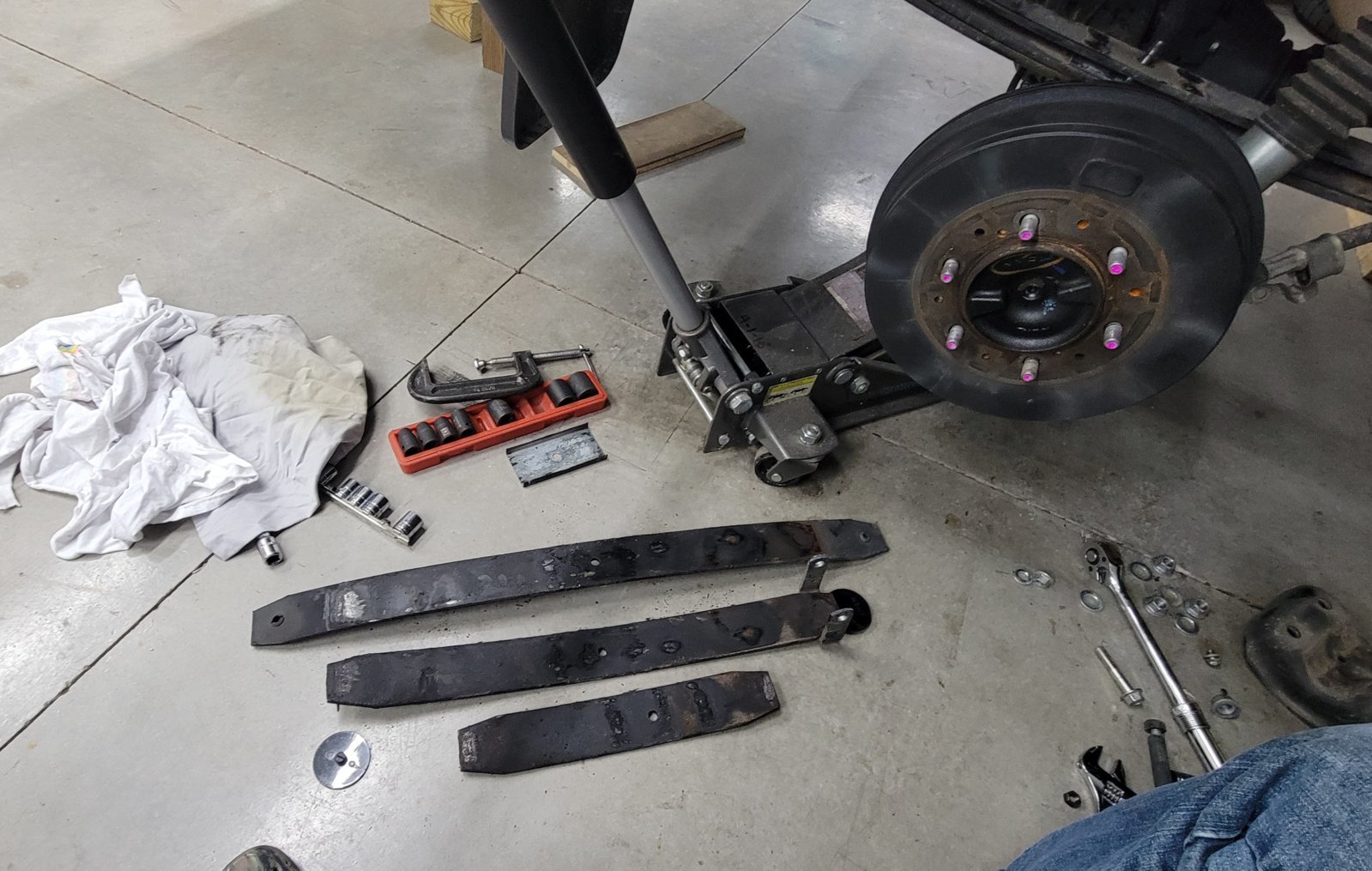

    I'm about to try something similar. My truck is a 2023 and I put HeadStrong 3AAL on at 500 miles. Truck now has 14k and I'm about to drill holes in the ends of the next two leafs(that don't have the pads) and add pads like the rest of the leafs. Hopefully prevent the squeaking.... will see. I've brushed grease in these spots and the squeak goes away temporarily.
    I'll drill the holes tomorrow or Wed. I'll post my results.

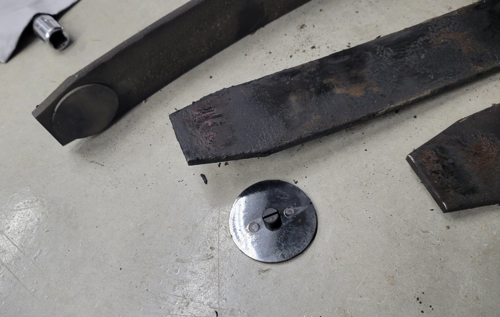

    Done. Stuff was easy to work with. I simply cut to length and trimmed the ends to the same profile as the two Headstrong leafs that were metal to metal. It's pretty unnoticeable too. Well see how long it lasts. Installed on this Head strong 3AAL at 14644 miles.
