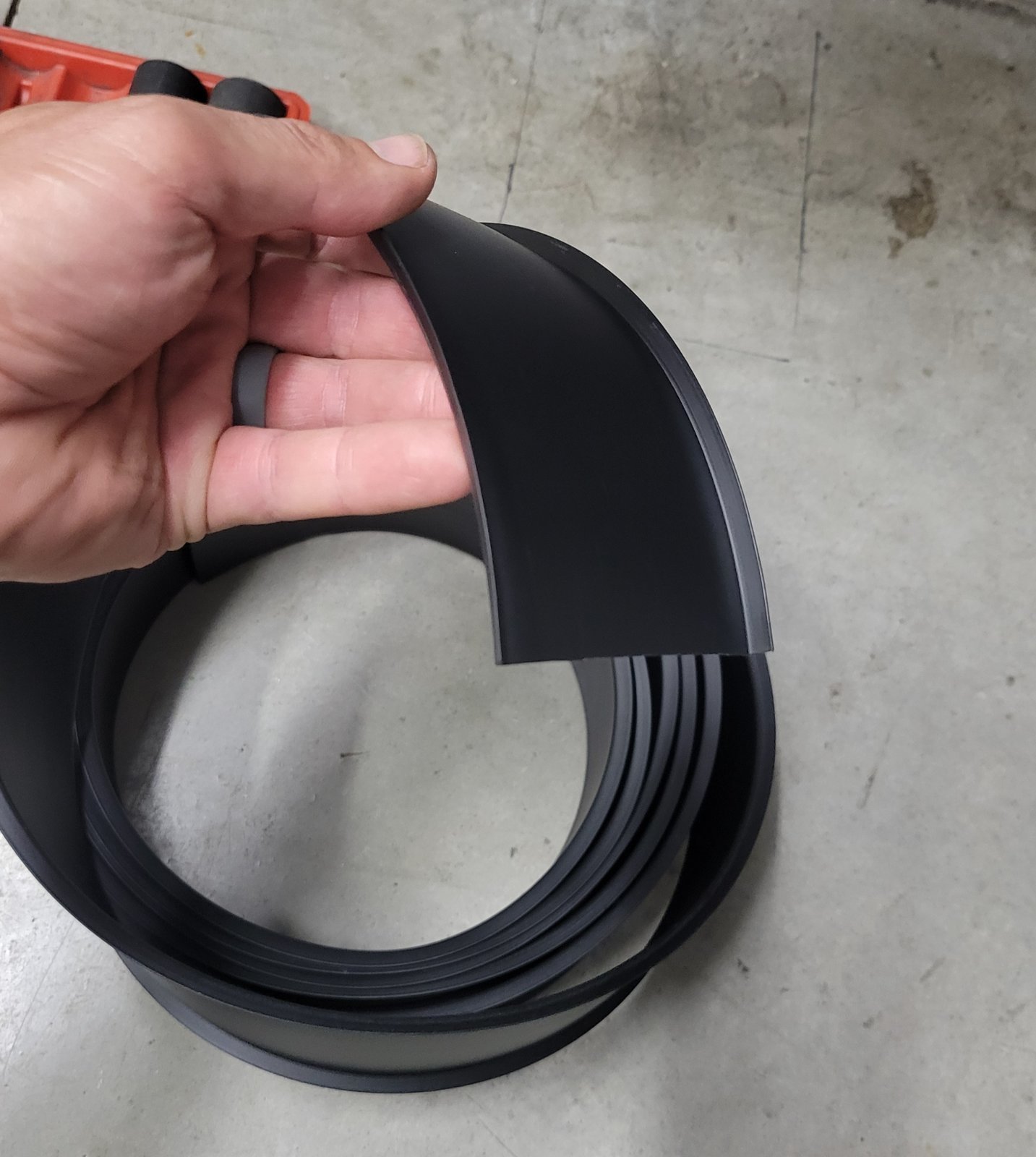

    Is this 2-1/4" width the right width for the Headstrong AAL? I didn't see specs on Headstrong's website, and elsewhere thought I saw the leaf spring width was 2-3/8". Pretty close, but was considering buying one of their other options with no lip that you cut to size.
  10. May 9, 2024 at 2:12 PM
    #30
    rybern
    rybern Well-Known Member
    Apr 3, 2017
    #215281
    2,348
    N Alabama
    2023 TRD OR & 2000 SR5
    5100's & 3AAL, 265/70r17 Toyo AT3
    I ordered the 2-1/4" and it fits perfect. Remember, put the flat side up and the "U" side down so it won't hold water, dust, etc. You can't even that it's on there. No draw backs so far except dealing with installing it. I have some left and plan to try to install it on my 2000 Taco without taking the leafs apart.... when I get a chance.
    Pista1 likes this.

    OK. It looks like I need 2 rolls, 1 for each side with some left over? I'm planning on leaving in the factory overloads but I've read I don't need it down there.
  13. May 9, 2024 at 6:06 PM
    #33
    rybern
    Apr 3, 2017
    #215281
    2,348
    N Alabama
    Yep.
    I only added it between the Add A Leafs and have plenty left over from the one roll I purchased. But I haven't had any squeaks from the OEM pads on the OEM leafs.
    On my 2000 Tacoma, I'm certain I have the same squeak issue from adding leafs that are also metal to metal.

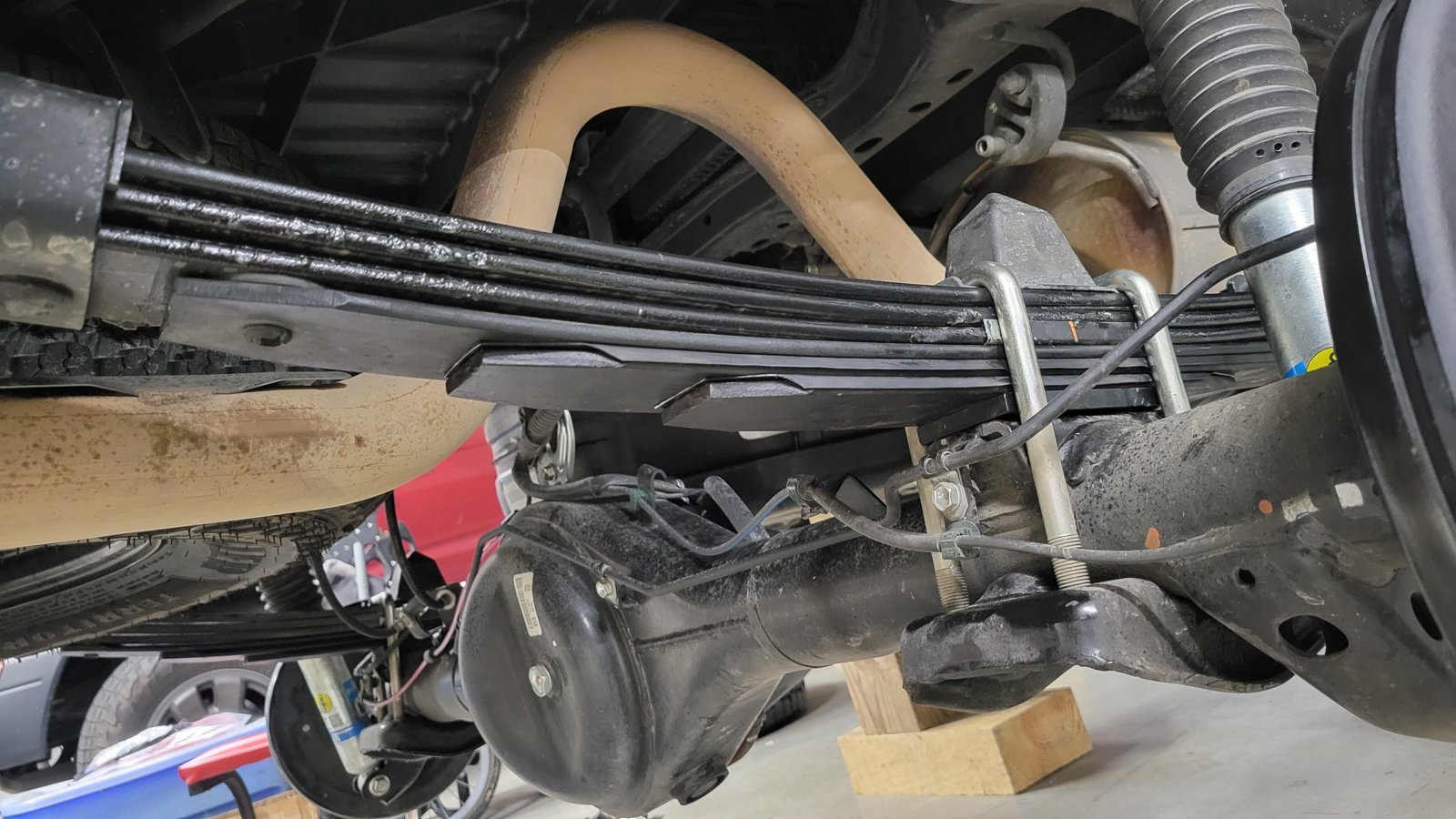

  14. May 10, 2024 at 7:40 PM
    #34
    r3k
    r3k Well-Known Member
    Oct 27, 2022
    #409103
    349
    did u put this end to end?

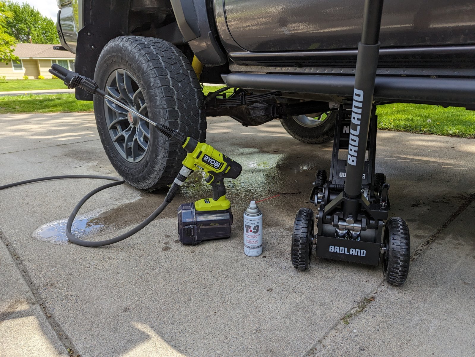

  17. May 10, 2024 at 9:27 PM
    #37
    ssd2k2
    ssd2k2 Well-Known Member
    May 27, 2020
    #329548
    1,125
    Keith
    Minnesota
    2019 Tacoma TRD Sport M/T
    Here's what I did to get rid of my squeaks in my icon leaf pack.
    -I lifted one side by the frame to allow full droop which opens up some space between the leaves.
    -Blasted them with the pressure washer to get any debris out of them.
    -Then sprayed t9 between each leaf
    I got 6 months of no squeaks last time I did this. It's really cheap and easy to do. Also I really really don't want to take them apart to put different spacers in them.
    Pista1 and rybern like this.

    That's correct. I used the leaf as a pattern and cut the liner the same profile.
