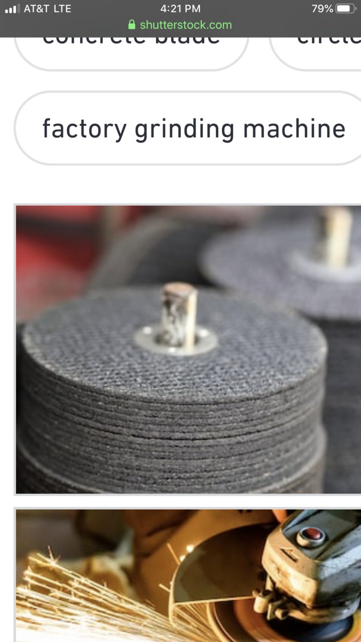

    Here’s a pic of want you want, see how thin these are. They’ll fit right in and that bolt will be cut in 30 seconds. 9E994A63-6D33-4403-89A8-24623EF742D1.jpg9E994A63-6D33-4403-89A8-24623EF742D1.jpg

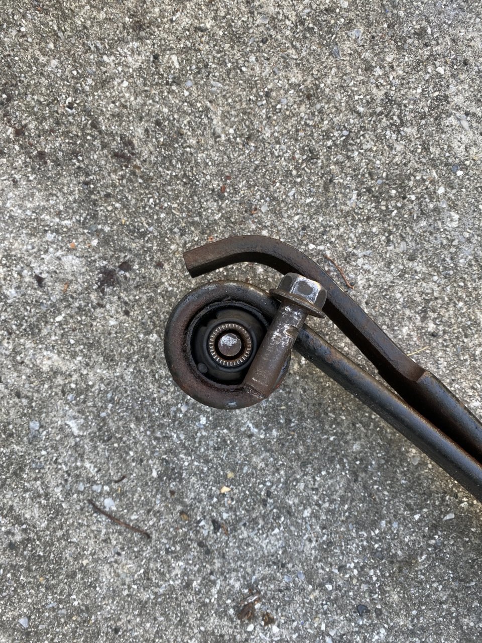

    SUCCESS! Really appreciate all the help

    Yikes!!! Using a fiber cutoff wheel without a guard??? Hopefully you at least had on a full face shield because this is asking for a major injury.
    Do yourself a favor and get a good 4.5" grinder with an adjustable guard- on better grinders you can rotate the guard without any tools- takes seconds. They are much cheaper than a trip to the Emergency Room. Makita and Metabo both offer this and I'm sure many others.
    Also, consider a metal cutoff wheel like Lenox makes. This is all I use since I discovered them:
