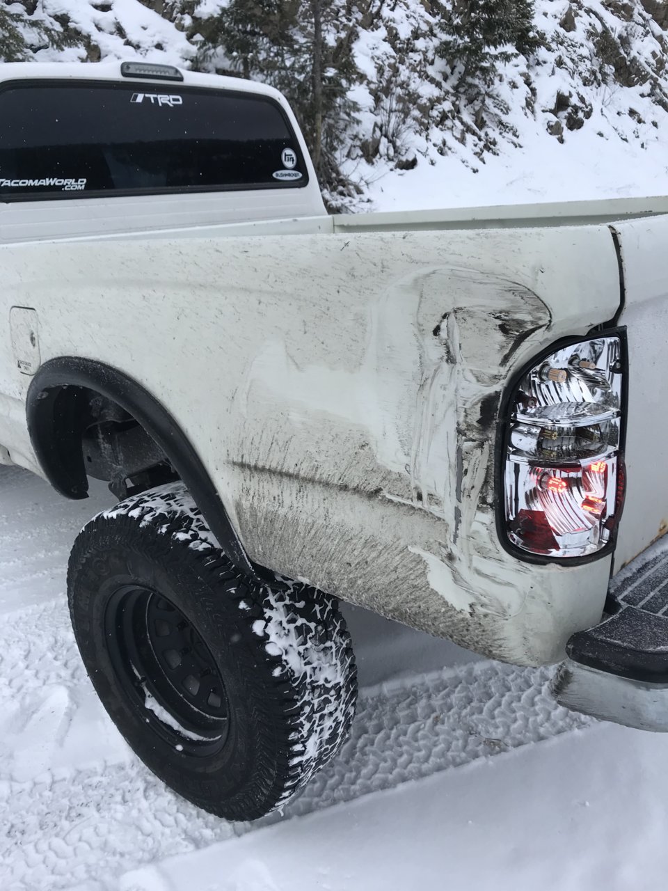

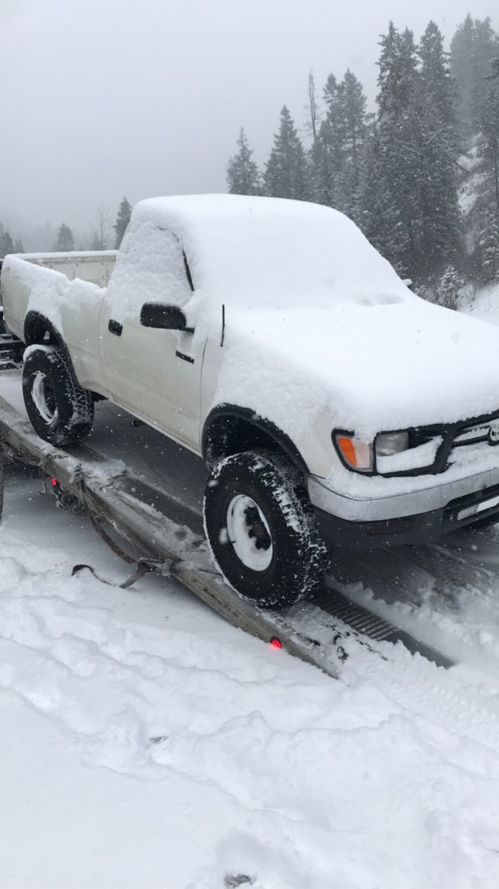

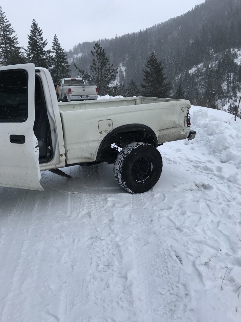

    Hey y’all, wondering what the size of the leaf spring bolts is that I should be using? I just wrecked my truck yesterday and I’m buying everything I need at the moment to fix it. Here’s some pictures. :/

    The truck looks stock, so the part #’s @Kwikvette posted should work.
    Unless you have a rear lift that uses lift blocks? Then you might need longer u-bolts.

    Yeah, TBH I just assumed that was what he was asking about since the axle is pushed back.
    It’s hard to tell from the pictures? But did the leaf springs come off the frame mounts?
    Or did the u-bolts give out?
