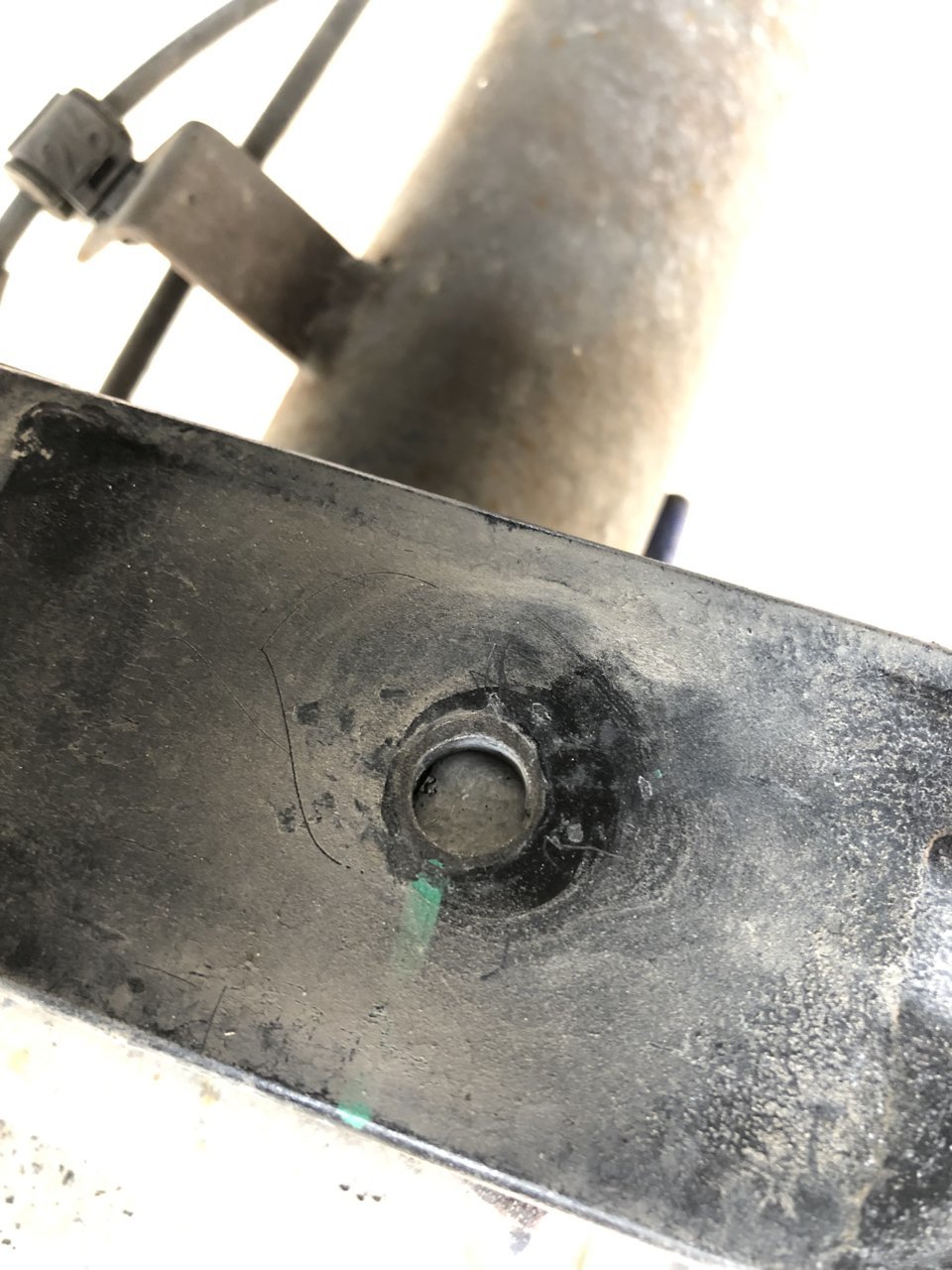

    This is the top on both sides, not sure how I can get a screwdriver in there

    Use a flat tip, stick it in and pry the edge of each hole over until they are aligned. Might have to work from the top and bottom if they are really misaligned.

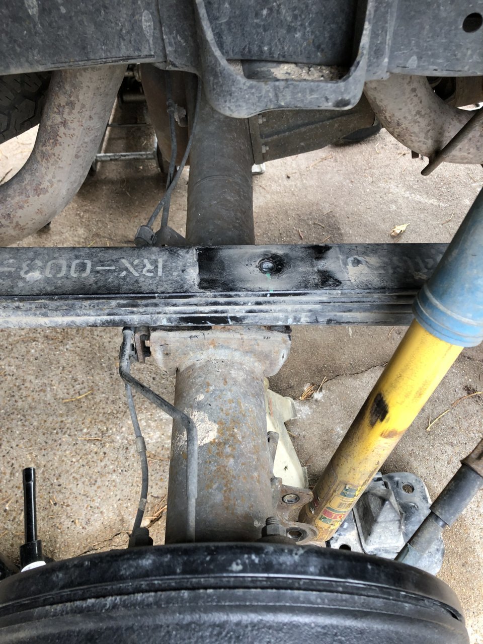

    It looks like you have weight on the springs.
    Your going to have to support the frame with a jack stand or wood etc and take the weight off the springs so the individual leafs can slide.
    If you pin is then to short I put a punch the same size as pin thru the clamp with a c clamp the trade the punch for the pin.

    Are the leaves resting on the axle? Trying lower the axle to drop the leaves and change their alignment.

    You have the individual leafs way shifted.
    Gonna have to get the weight off them.

    The bottom 3 leaves should just be loose, as in they’re not attached in any way. When you lower the axle this’ll become obvious. You may need a C clamp to help re-compress the leafs as you line everything back up. It’s a major pain in the ass and just takes patience
