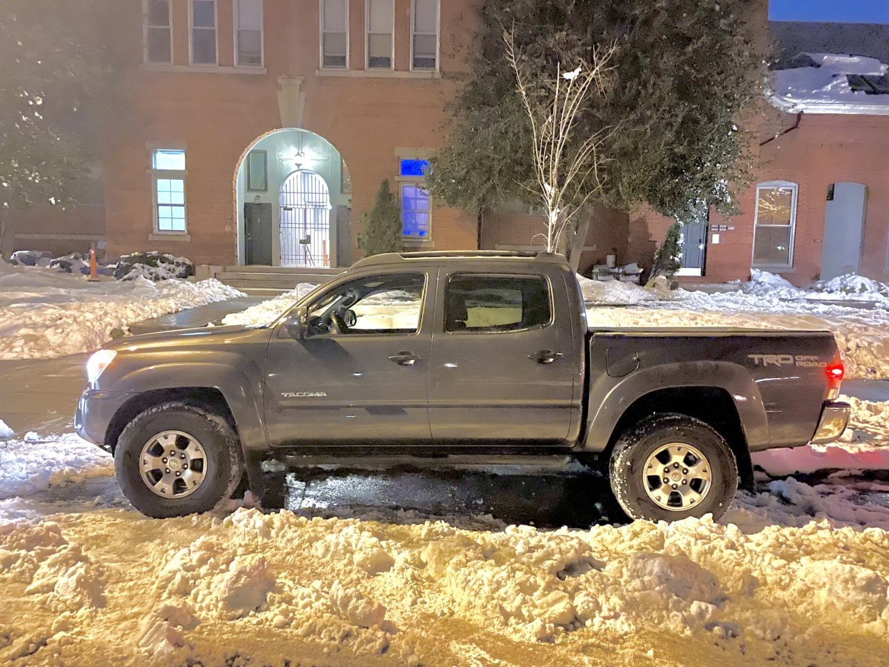

    indiangk87
    indiangk87 [OP] Member
    Dec 31, 2021
    #385937
    8
    Tom
    2015 Tacoma OR DCSB
    alright guys, great success. had the springs replaced by a local spring shop before the gas tank or axle had a chance to meet them.
    now the truck is a solid 2-2.5” higher in the back (re: pic) and im ready to replace the front shocks and coils. thinking the 5100s and 883. 884 seems a little high since i figure the rear will settle
    by an inch. but convince me otherwise, im open to it. i just wanna level the truck and not have to think about suspension for a while. i wont be adding a winch or new bumper anytime, and i have <300 lbs in the bed at any given time.
    last but not least when i was parking my car the other day noticed a squeak when i turned the steering wheel all the way in either direction when the car was not moving. when driving no squeaks or sounds at all even when cranking the steering wheel. also it was prob about 20 deg outside, so pretty cold. any clue what this could be? bushings? cv? ball joints? figure why not try to get it done while suspension is being replaced. also if i should post this in another thread, please recommend!

    BudFriendguy
    BudFriendguy TRD BRGLR
    Feb 5, 2021
    #355148
    3,403
    Zak
    Portland, Oregon >> Cleveland, Ohio
    2021 TRD Sport ACLB 4WD 6MT V6 Voodoo Blue
    Disclaimer: I'm not a mechanic by a long shot.
    Maybe it's the power steering pump going out, or its belt slipping?
    It takes more effort to turn a still wheel than a moving wheel (if you've ever driven a car without PS you'll know.) It sounds like the pump is weak enough to struggle moving a still wheel, but still strong enough to work fine while rolling.
