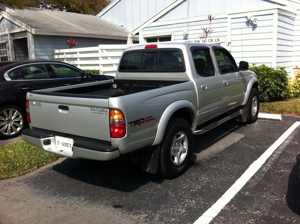

    Just curious - I'm a relatively new owner of a 2004 DC Prerunner and going through these forums has been a huge help - but on the topic of leafs, my truck is fairly low mileage but do the leaf springs go flat with age or is it on higher mileage trucks? And how flat is dead?On mine the leafs do look fairly flat - I'd hesitate to say a negative arch but still I'm not sure what they should look like, the only reference I have is my truck. So are the stock leafs fairly flat from the start or do they have a big positive arch?

    They don't start out with a tremendous arch. Mileage is not a good determining factor. Bigger determining factors are age and usage habits. (Mine were dead at around 50K miles, but I have a topper on the truck about 1/2 the time.)
    Pics would help confirm your status...

    I'll post some up, but I'm away from my truck for a couple of days. In the meantime, here's a pic of the truck for ride height reference, and though this doesn't show much there doesn't seem to be any "sag" from this perspective based on other trucks I see:
