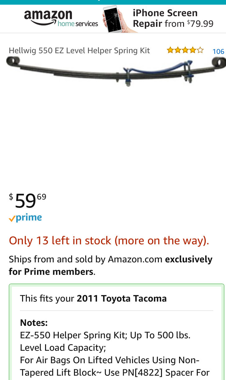

    I have a 2011 3 leaf spring pack (2 leafs and overload). I was experiencing the bump after stop. I added a leaf spring clamp just in front of the axle and that stopped completely. So much that I was amazed. The springs i have are basically flat with no arch. I’m not looking to add a leaf or change the leaf pick key anything too drastic, so don’t waste your time with those stories please (no offense). Question is has anyone tried this on a 2011 2wd Tacoma TRD or any 2nd gens?

    I had something like that (maybe the same thing) on the rear of my '09 springs before the recall springs were installed. Seemed to work well, tho I never experienced your problem. I used them to help maintain level with heavy loads.

    I installed Hellwig 1251's on my 2013 2wd SR5; they were easy to install and helped stiffen the back end. I've since added a Leer top and lots of gear in the bed, back end seems to be holding up well.

    I seem to recall the clip was somewhat in the way on one side, I had to slightly move the helper spring to fit, but I got both helper springs fit eventually.
    One odd thing I remember, Hellwig stated that their helper springs (or at least some models) should not be used on a vehicle with an LSPV; my 2013 doesn't have an LSPV, but maybe your 2011 does. I'm not sure why having an LSPV valve would preclude usage?

    I didn't observe any noticeable lift, but I didn't conduct before/after installation measurements to confirm it. I just noticed a stiffer back end with less sag under loads.
    Also it might depend on how far you tighten down on the U-bolts of the helper springs? I have yet to really crank down on them.

    I had ordered the hellwigs for my 2015, then found out that the leaf spring clamp my be in the way and I would need to cut them off. Didn’t want to do that so I canceled the order. About 6 months later I saw where they now make and include bolts that are bent on an offset to get around the spring clamps.
    It would be best to call and ask for sure.

    I put a LEER on my 2015 DCLB and the rear dropped about 1/2 inch. Then installed the Hellwig 2K helpers and it leveled it back out. I haul a lot of bricks and they prevent a lot of the sag I had before.
