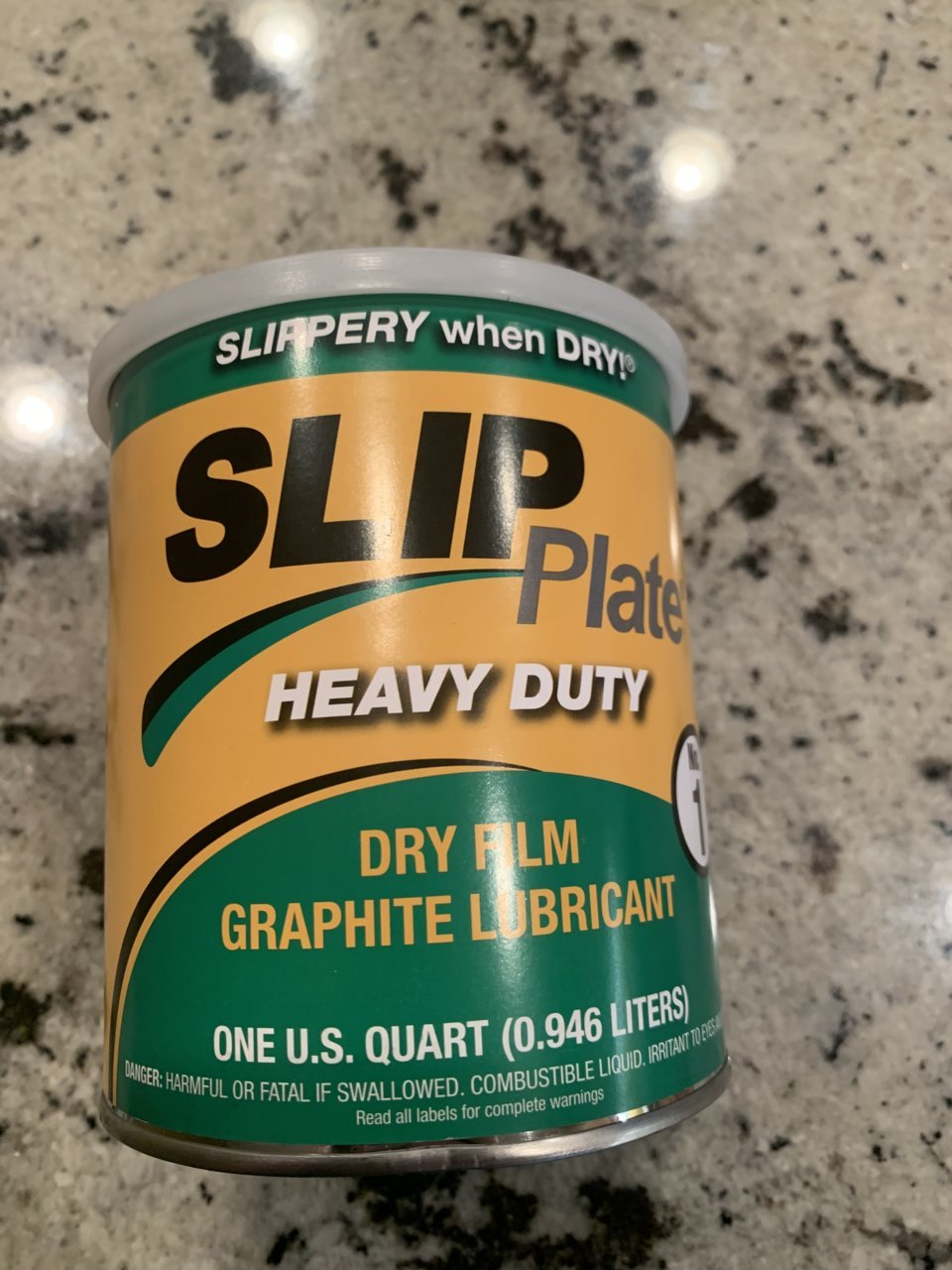

    I also picked up some of this graphite impregnated paint I’m thinking of painting my leafs with.
    Anyway, what have you guys done? Anything that made a difference?

    For anyone keeping score I’m not sure this is actually worth it. This suuuuucks. Removed all of the Teflon pads, beveled the spring edges, and sanded, and painted the graphite stuff. I can see how this stuff makes the springs slick. Question is how long will it last.
