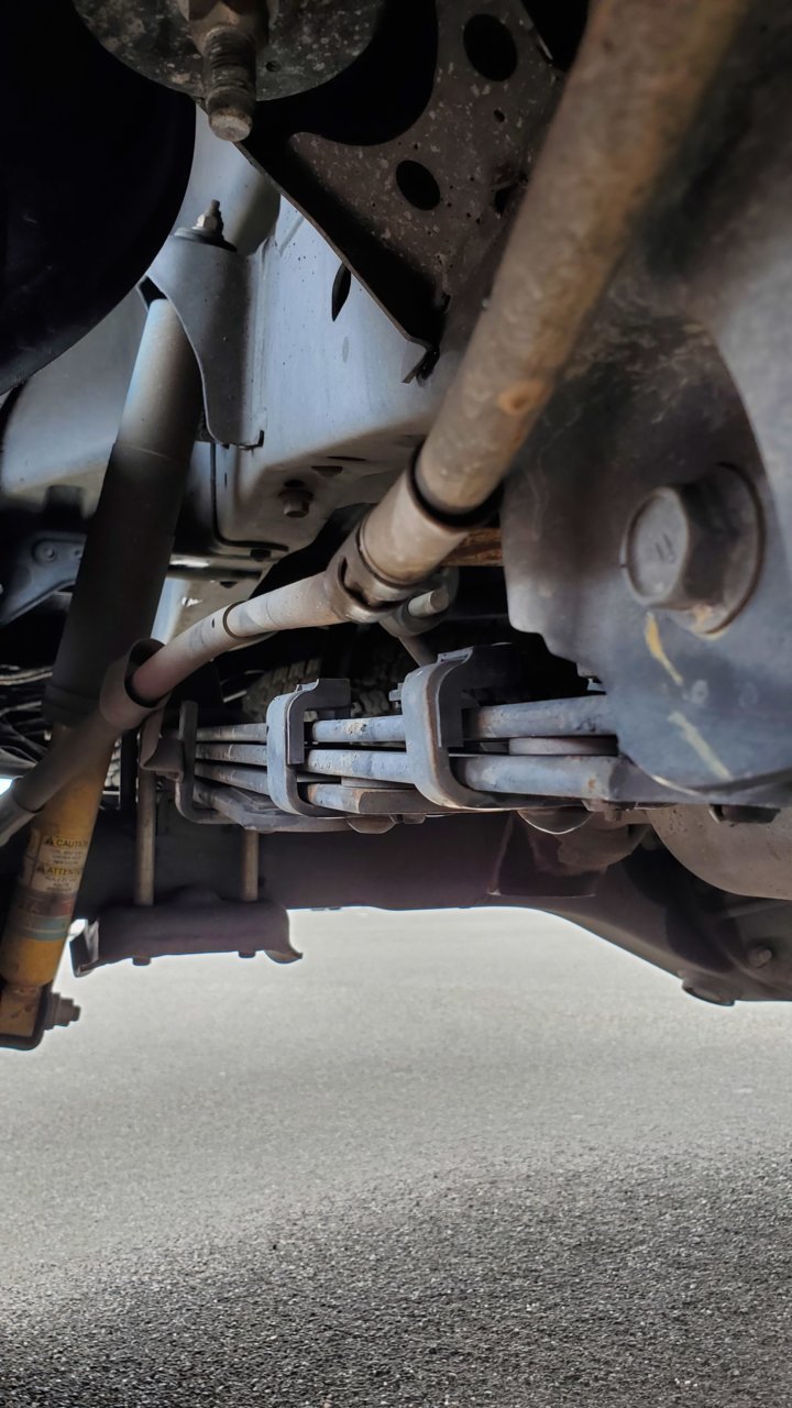

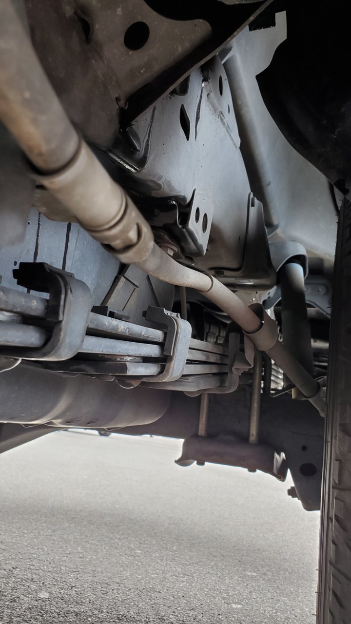

    Truck is about 3 years old. Havent fully loaded anything heavy (within capacity obviously) except for like 3 times out of a whole 3 years. Anyone else skeptical about their leaf springs looking like its wearing out fast?20190717_095858.jpg 20190717_100037.jpg 20190717_095858.jpg 20190717_100037.jpg

    Why do you think they are wearing out?

    looks like your already on the overload spring

    They pretty much look like that brand new.

    Truck is definitely totaled.
    Looks fine IMO. :notsure:

    How much weight do you carry in your bed?
    Mine looked exactly the same with my cap and tool box weighing about 300-400 lbs. I added a Roadmaster Active Suspension and that basically put it back to the stock arch. Edit: The stock arch is only very slightly arched up. It looks like yours might be slightly negative.

    Looks like any Taco leaf pack across all generations. Flat.

    They look a little tired. How’s he ride?

    Mine looked exactly like that until I installed airbags for towing. 5-7 psi minimum gives me a healthy looking arch, but that is how they looked basically when my truck was new as well.

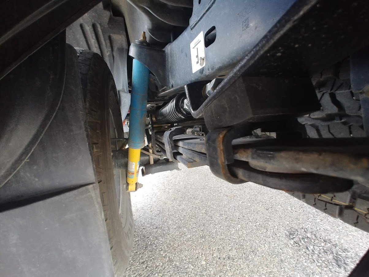

    Here's mine with ~ 300 lbs in the bed and RAS helper springs. The arch is just barely positive, which I think is close to stock.

    If you’re worried, put a $100 AAL in, you’ll get some arch, 1.5” lift and you keep the overload.
