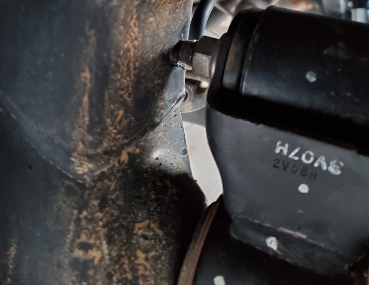

    So I spent about 6 hours today installing my new Emu springs and the Bilstein b110's. Get her on the ground to torque the bushings and this is what i see. How fucked am I?

    Lift it back up and turn the bolt around. So the nut is on the other side of the shackle.
    Dont drive it like that

    Cant you turn that bolt the other way so the end with the nut doesn't hit/rub.

    This. You can fix both sides in about 30 minutes.
