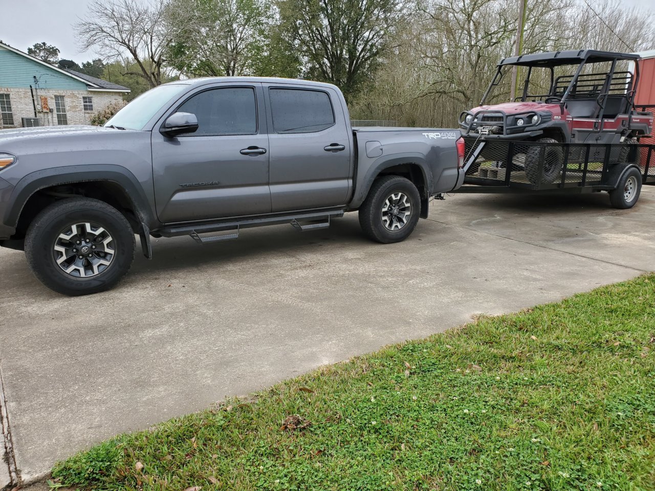

    It's mainly the rear of the truck going up and down so much after going over a bump that bother me. Tongue weight is good as the weight of my load is centered over the axle of the trailer. The side by side takes up the entire 12 ft trailer.

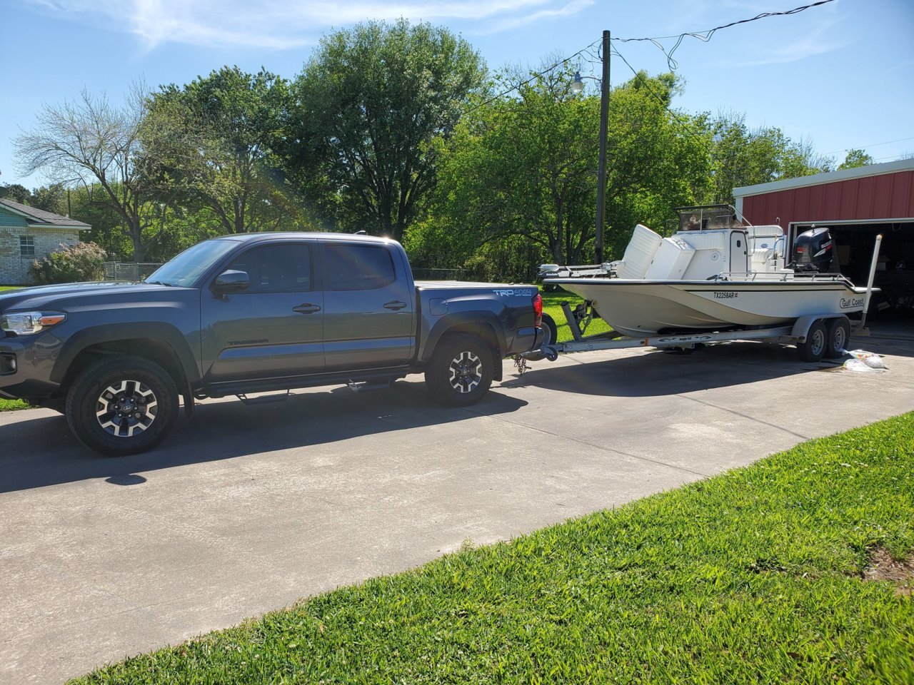

    I think a little porpoising while towing something relatively heavy is par for the course and it doesn't bother me much. If I couldn't feel the boat at all I would think I bought a bigger truck than I needed. I only tow my boat a handful of times a year though.
