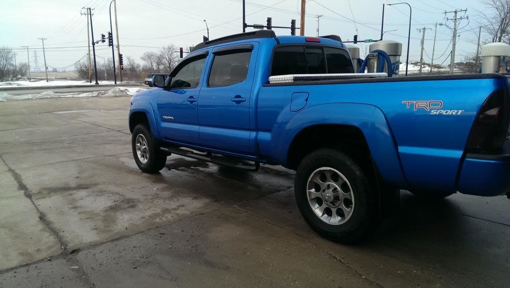

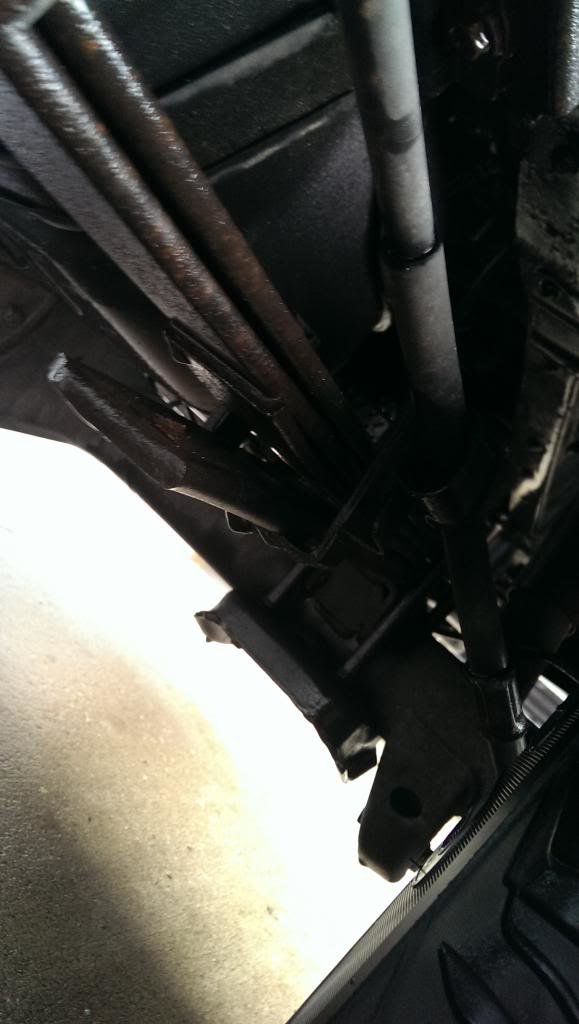

    Here is my current setup on 2006 taco, 3" lift which is the way I bought the truck. My question is if I get the Dakars leaf packs will my rear sit higher then it currently does?

    Looks like u just have an add a leaf in your pack now. Just go with the allpro stds and you will get 3" of lift. If you want more than that you can go with the expos for 4" of lift.

    that's nowhere near a 3" lift, if anything it looks like an AAL
    you're only getting 1.5" or so

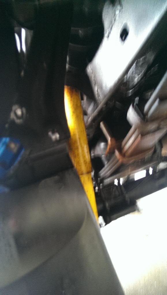

    I bought the truck the way it sits so not sure if rear shocks are stockers. There the yellow Bilsteins. Also just by looking at my truck, what size lift you guys think is currently on it?

    For rear shocks, will the bilstein 5100s (0-2.5" lift) work with this leaf pack?

    No only the front 5100s are adjustable. Try some fox shocks with 9.5" of travel or you can get a set of 5100's made to your specification. Look at the Bilstein 5160's as well

    If you want to use 5100's for the rear you need this p/n BE5-B110-T5 . These are the extended rear shocks.

    If you get longer shocks you'll probably want bigger bump stops too to make sure you don't top out the shocks.
