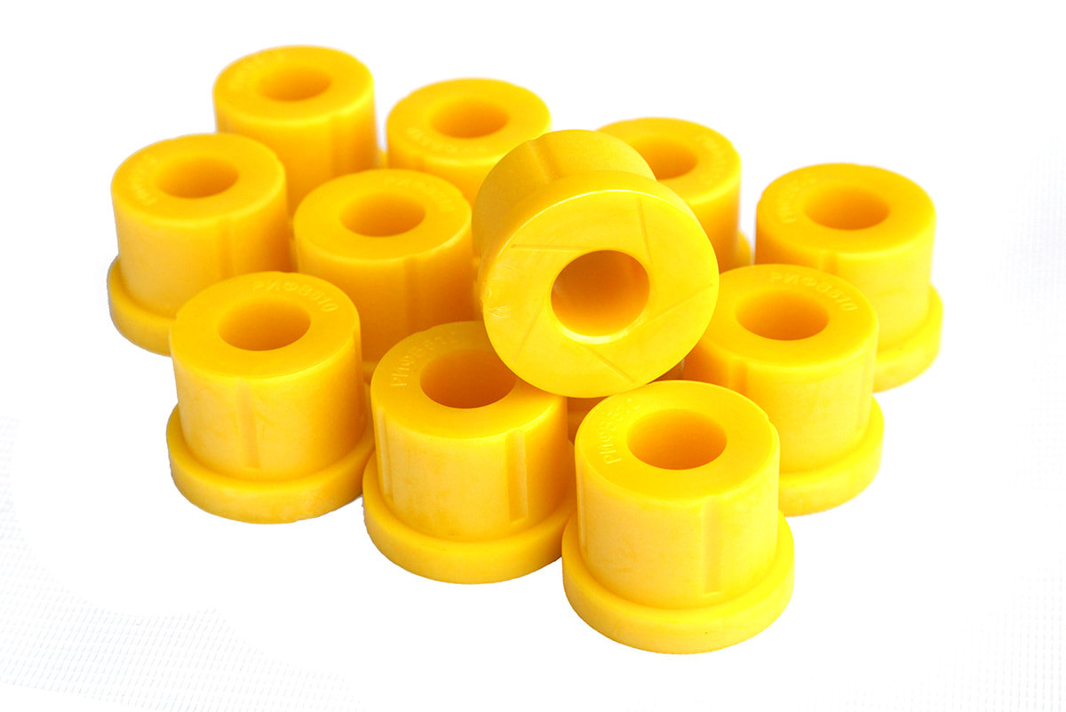

    I mention it briefly in my Dakar thread, but if you haven't completely isolated the source of the squeak, take a look at the bushings. Sometimes if the bushing are dry and the hardware is overtorqued, it causes binding which results in squeaks. I found that the bushings with siping cut into the outer shoulder are better at grease retention and reduce squeaks. You can cut grooves into your existing bushing or replace them with "better" bushings. Example from OME:
    This small grooves on the face of the bushings (as well as around the circumference) hold grease where the bushing makes contact with the hangers. You can grease them liberally and lower the torque on the hardware (recommended to replace nuts with Nylocks as well) to reduce binding and allow free movement.

    Yeah I've tried that, my bushings have a tiny bit of squeak but I can tell the difference between the bushing squeak and a creaky noise that my leafs make. The leafs are much worse and louder. Lube is always a short term fix.
    I'm planning to remove a leaf from my leaf pack so I'll have them disassembled, might as well try to hit two birds with one stone with something to keep them from developing a squeak again. I'll replace all the bushings too and use that clear PTFE grease.. probably will add grooves to the bushings too.
