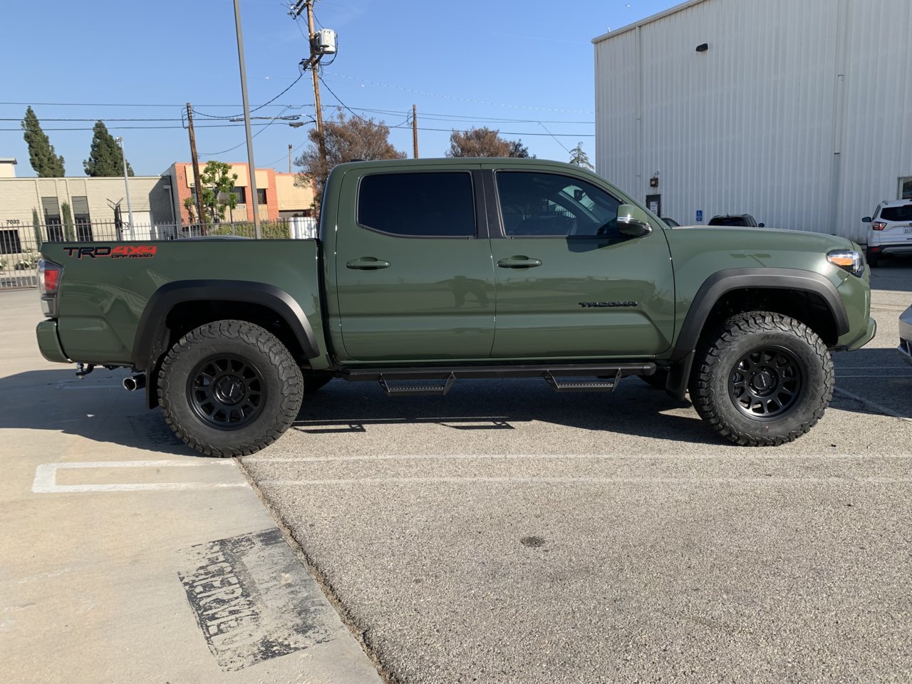

    I just installed Bilstein 5100s all around to level out my 3rd gen Tacoma. Put new Icon upper control arms, new wheels, and tires. I did not change the front-end springs. The truck looks great. Was I supposed to add a leaf spring to the back of the truck? I'm hearing yes and no from different people. Wanted to get your input.

    Army green looks so good. Are the 5100s on the lowest setting? Looks like a little reverse rake unless it’s just the pic

    Looks good but measure from center of hub to bottom of fender and see how they line up. You can take the front lower or the rear higher to level depending on tire size to prevent rub. An add a leaf will get you there but they can be stiff.

    I would add a leaf or an add a leaf (3 pack) from icon.
