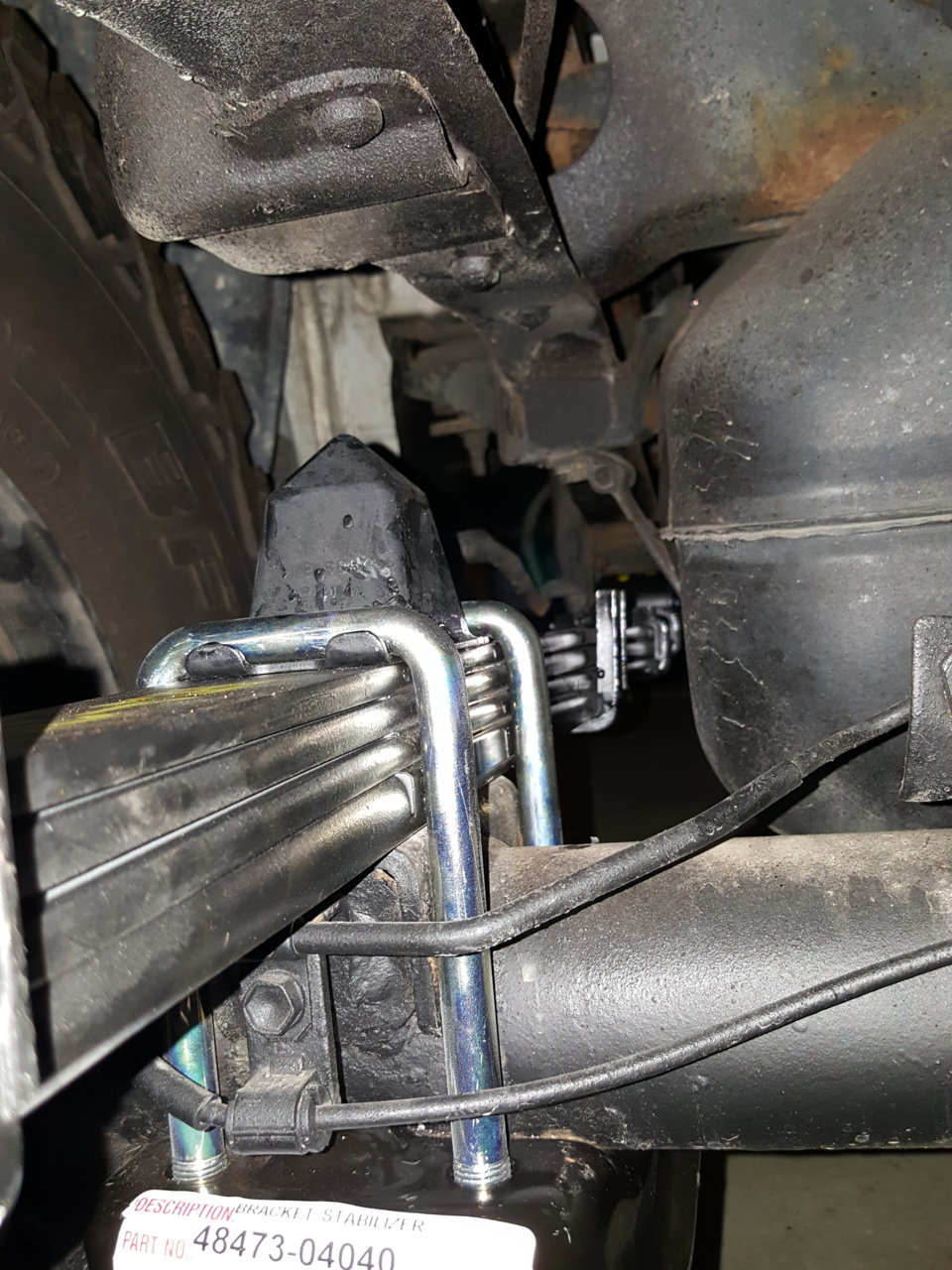

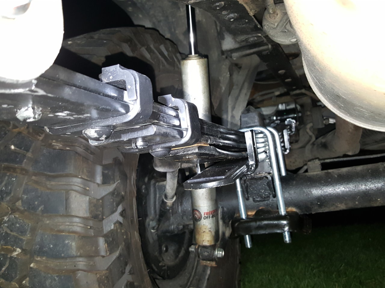

    Found out that my 07 Tacoma

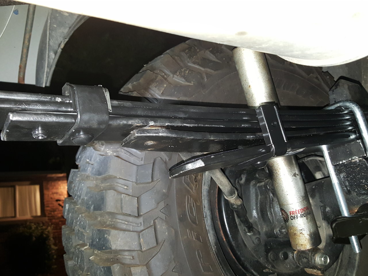

    Needed to come in for the leaf spring recall. I was really surprised they would even do the recall with the truck having 239,000 miles. The truck is lifted 3" I didn't want to take any chances with them denying mine due to it having the Deaver add-a-leaf along with the one inch lift blocks so I went ahead and took the springs apart and put them back to stock but I did leave the spacer block because I've heard other people did it with no issues. They went ahead and did the warranty work but I was really surprised at how soft the new springs are, it's actually a 4 leaf pack instead of a 3. I was thinking I would get some additional lift and a stiffer ride but it was actually just opposite. After the work was done I went ahead and put the Deaver leaf springs back in and it seems to be sitting a little higher than it originally did which is fine with me. I did a before measurement at the wheel well but I haven't had a chance to check it now that the new springs are in. My guess is that Toyota used a lower tensile strength steel and knowing that the springs would be softer added the additional spring to compensate.
    By doing this I suppose the springs won't crack or fracture as easily but at the cost of a much softer spring steel.

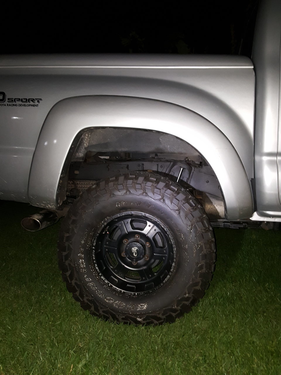

    Here's a picture after they did the work. The springs are actually bending downward. It almost seems as though these springs were rated for a regular cab and not a double cab TRD sport.

    My rear was crooked and sitting an inch and a half lower than the front after frame swap with the new Toyota springs . o_O

    It's sitting much better now with the additional leaf back in. Hopefully I won't have any issues with these new springs after they settle in

    Got dark on me last night after I finished but definitely setting a little higher than it did with the original setup
