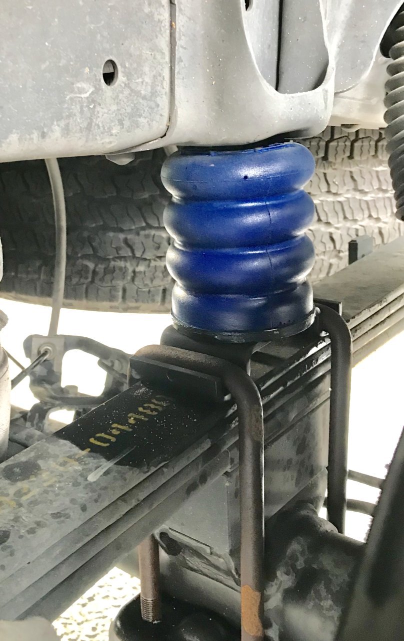

    I just looked into the sumo springs. Looks like that’s what I need for towing. Thank you tallpilot!

    Installed the set today. World of difference in raising the rear. The rear now sits 3/4” higher than the front now. Only problem is that the passenger rear leaf looks shot and would definitely need to be replaced in the future.

    That’s exactly how they work. Just like an airbag they raise the ride height above where it would be with just the spring. Completely unladen they probably should not be in contact. Honestly though his massive block isn’t doing him any favors and was the proximate cause of his damaged pack.
    This is why some of us groan when people want block lifts. Without a taller bump stop or equivalent it is just too easy to overarch the pack.
    The damaged pack can perhaps be repaired but the stock pack is so crappy it really should be upgraded.

    I have SUMOs on my truck. Unloaded there is about a 1 inch gap between the SUMO and the frame. So for most of the minor bumps the SUMO never even comes into play. Depends on the SUMO as well. 2nd and 3rd gens use a different spring. The 3rd gen is shorter
