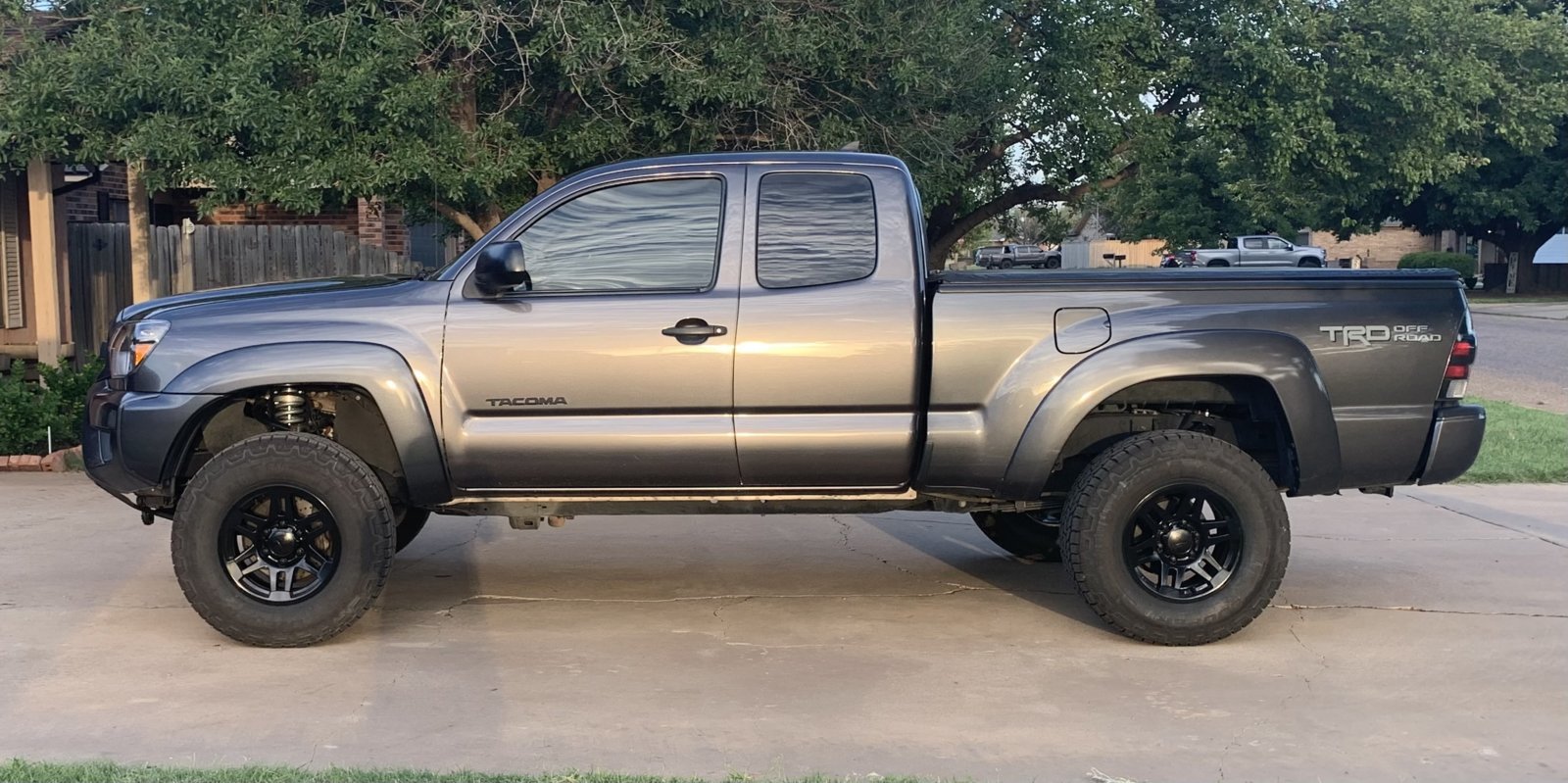

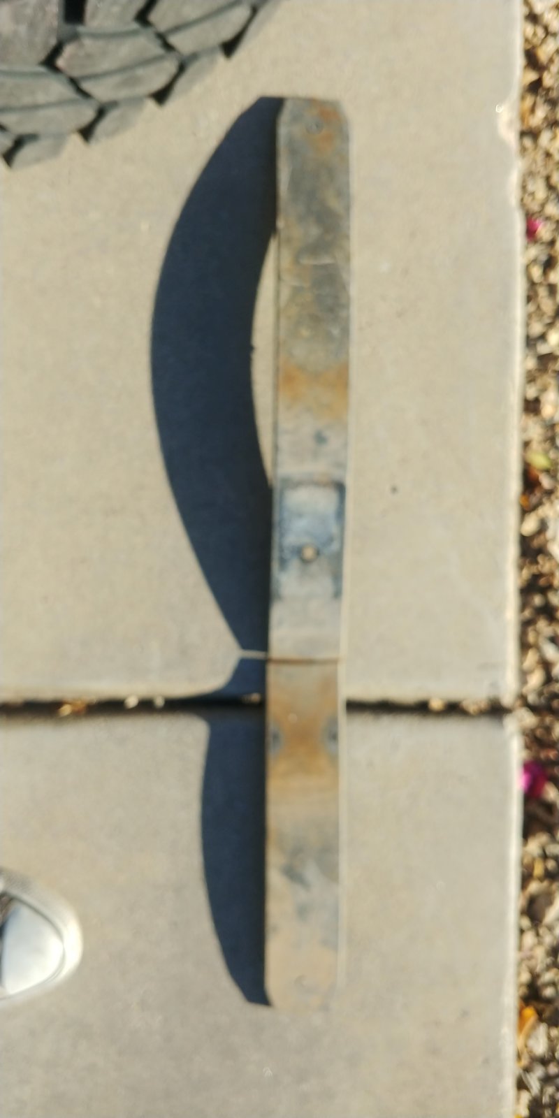

    I did the 1 1/2” add a leafs and it did just exactly that, and I’m lifted 3” on the front, now mine rig is perfectly level. So that will raise you that much, not sure of anything that would help you except for just a 1/2” block.IMG_3659.jpg IMG_3146.jpg
