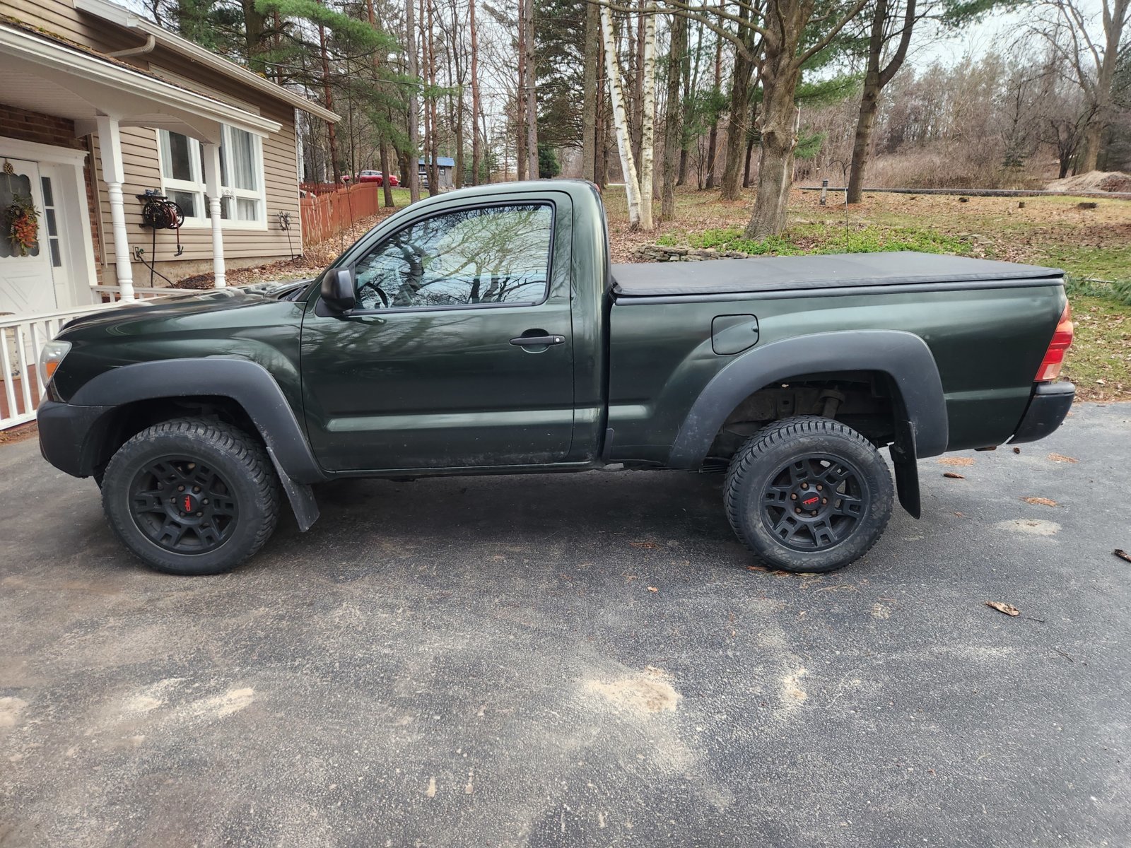

    I recently had to replace the rear leaves on my 2012 Base Regular Cab as one leaf had snapped. Since I was on a bit of a budget, first place I looked was Rock auto. Seemed expensive to me. I then found General Spring online and they had HD 4 leaf packs with an extra 500lb capacity for $169 each...bushings installed. So two packs with new u bolts was under $500, and I'm ready to haul fire wood again! Gonna replace the front struts with leveling struts next as they are whooped as well. 20240316_183612.jpg
