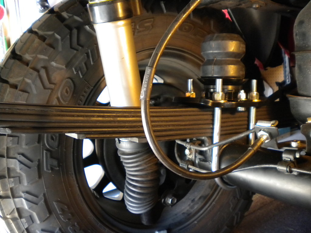

    I've had the RXT leafs on for 4 years now and haven't heard a squeak yet (spray them with Boeshield T-9 twice a year.)
    RXT option 2...

    Wow, yours look newer than mine and I recently installed them. I've got a little rust already starting.
    Ordering the spray now. Thx

    The spray is more clear and not as tacky as Fluid Film.. more of a wax coating that doesn't collect dust/dirt as much. I use it on the suspension parts / FF on the frame. After 18 years the truck has zero rust but i live in a desert envirerment... no salt used.

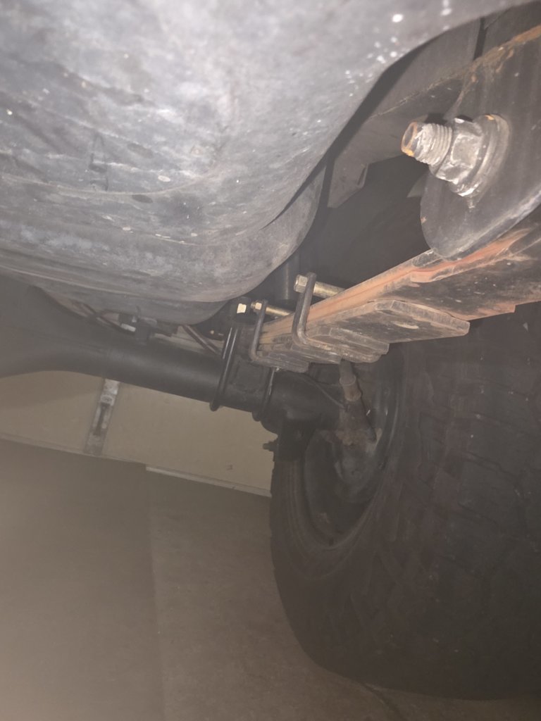

    Man, alot more rust than I thought. And I installed them after this past winter.

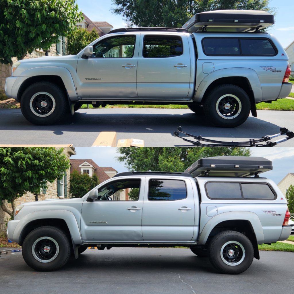

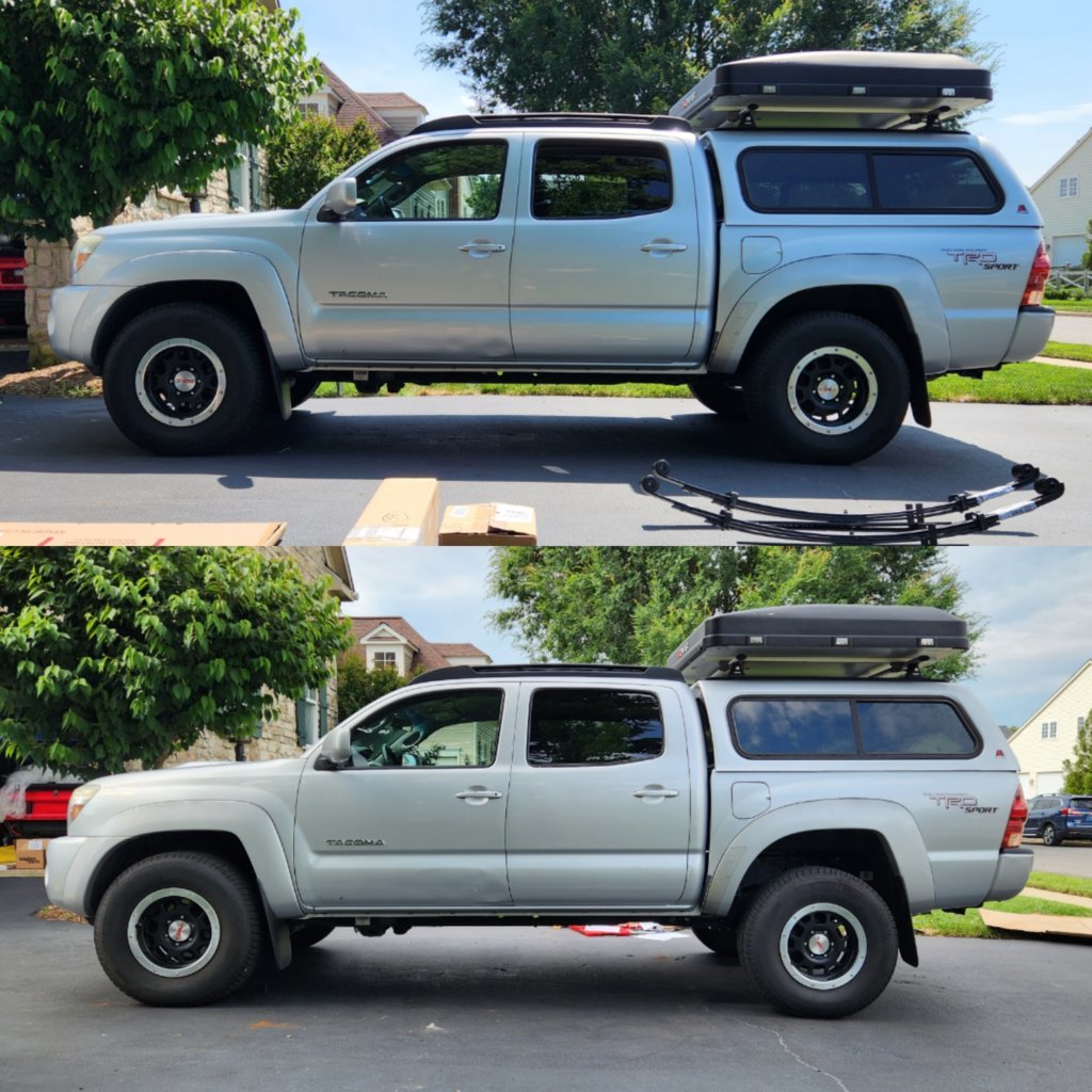

    I just installed General Springs HD leafs in tandem with a full set of Bilstein 5100's on my 2006 tacoma (quite a job bc of rust and other surprise worn components).
    First pic is a comparison of my old flattened stock leafs (top) and just the rear General Springs leafs/rear 5100's put on with stock front suspension (bottom):
    Second pic is a comparison of my old flattened stock leafs (top) and the front 5100's on the 0.85" setting with the General Springs leafs/rear 5100's (bottom), I'm pretty happy with the way it's sitting right now, no squeaks to report yet.

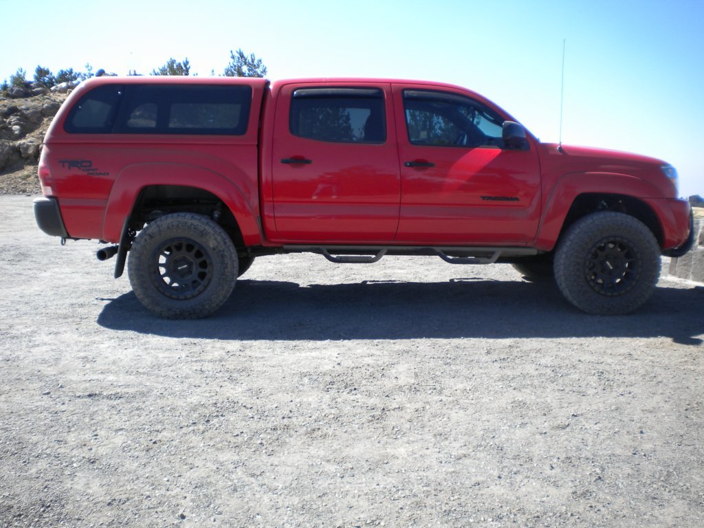

    Happy with my light duty Dobinson's. Bilstein 6612's in the front set on 1.2" still allow for appropriate rake front the rear as well, accounting for the added rear lift. More details in my build thread.
